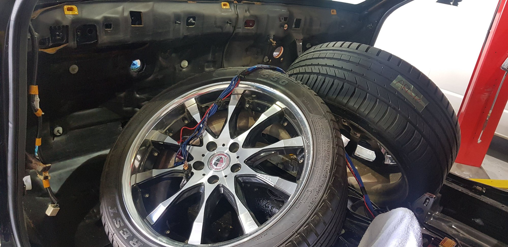

Front panels, doors, engine and interior all out of the car. You may notice the plethora of aftermarket wiring in front of the wooden board attached to the rear brace, I forgot to mention this car came with a pretty kickass sound system. Upgraded speakers in each door, better subwoofer, Kicker and Sony Xplod amplifier in the boot. Speakers will have to be transferred into the new doors, the shame is that the standard Aristo amp is in a different position requiring the whole thing to be rewired, rather than stress about it now it's been decided that the car will be taken to a pro later on to properly set it up. So while I won't have an audio system I will be able to hear the turbo's sing.
You may also observe that the wheels that came with the Aristo are in the front, whilst leaning on the rear of the car we felt the whole thing tilt on the hoist, we immediately tied it down from the front to a heavy table and threw the wheels in for a bit more balance. Removing 300+ kilos from the front of the car will do that.

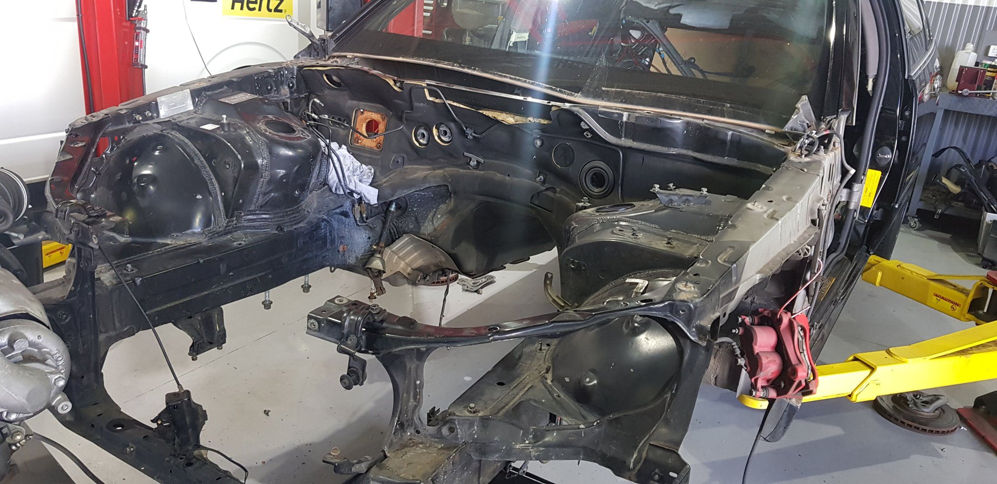

A hole had to be cut in the subframe with a step drill in order to relocate the heater core outlet, the turbocharged engine has it on the opposite side of the engine bay. The hole for the washer bottle neck had to be die grinded so the ECU box could fit flush with the body, strange how there are some seemingly arbitrary small differences between the two chassis. The heater core outlet is different because the turbo is in the way and maybe since the Aristo didn't have headlight washers the hole for the bottle is different? Rear doors were also installed, just to get it out of the way.
The Aristo dash has some deep grooves on it, there was possibly a TV sat on it for some of its life. Aftermarket wires such as a Hornet alarm system, free TVing box and a turbo timer were removed. Watching TV while driving? Must be a very boring morning commute to work in Japan. It was also discovered that the Aristo had curtain airbags whilst the GS did not, always assumed that it did. Some resistors will have to be bought in the meantime so the dash doesn't throw an airbag light, may consider getting curtain airbags later.
Whole front subframe from the Aristo is in, 100,000kms less on all the bushings. The "Go Fast" red brake calipers and rotors were swapped over.
However, the GS300 rear subframe has been kept so we don't need to worry about locking out ARS, hopefully the ARS ECU doesn't need the actual subframe to send signal to the TRC ECU. Traction and stability control would be nice to have on this thing. Diff and coilovers were swapped over and left rear wheel bearing replaced; had to grind the bugger out.

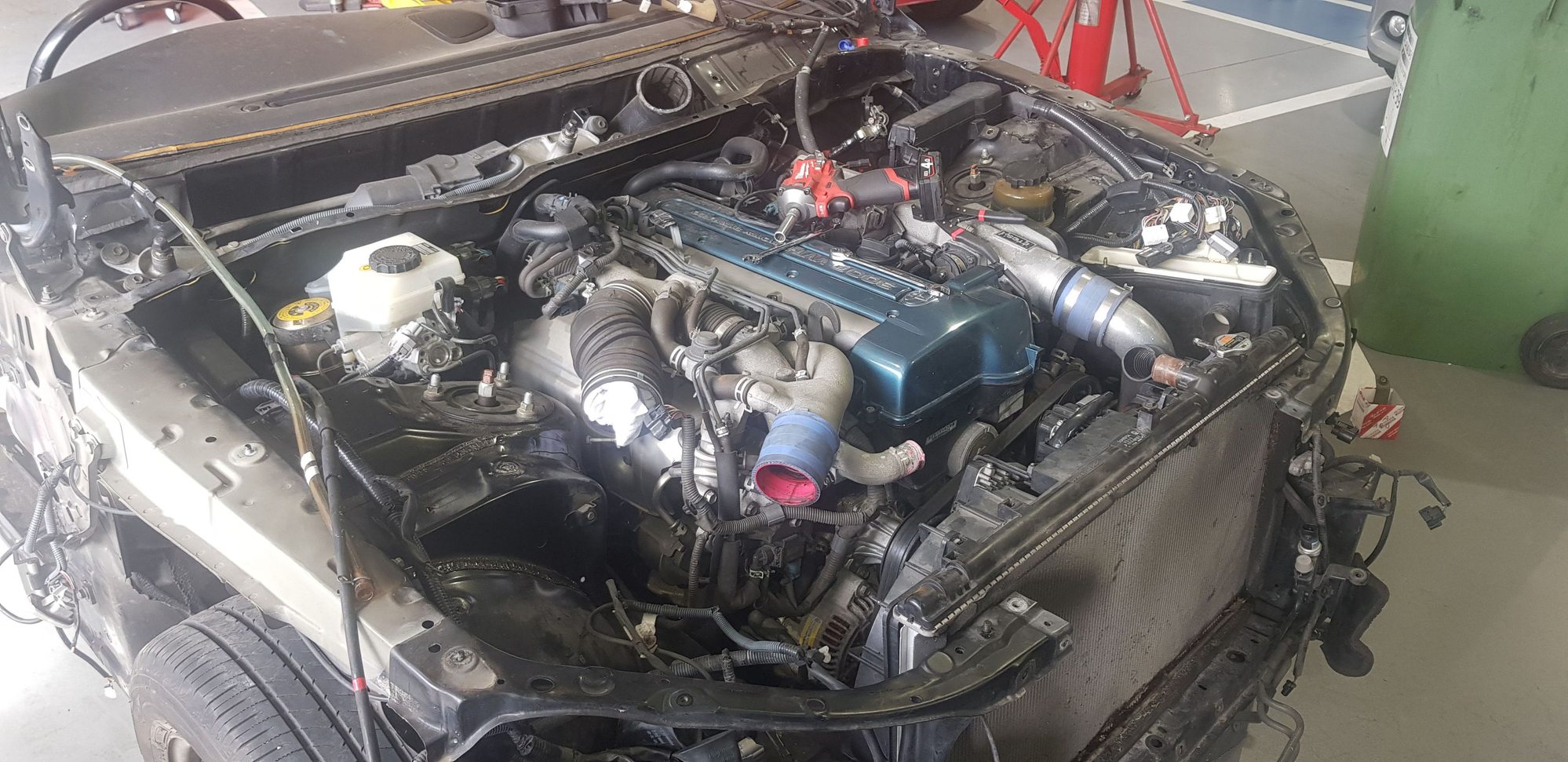

All of the engine bay is together now

Now enough of that boring stuff, to the interesting stuff; engine problems!
This was thankfully an easy fix, the Aristo pump had some seals replaced and afterwards did not want to start. Once it did start it didn't rev, we got the engine running properly by putting the GS pump in and sticking the fuel return into a jerry can, it had us all very confused and thinking the Aristo pump was fried. It turned out though that the fuel filter wasn't properly reassembled, an o-ring and hat was in the wrong place restricting flow. With those issues rectified:
The 2JZ purrs once again, engine stumbles a little bit when revving whilst cold but it needs a good long drive to properly learn everything. Every employee in the workshop came over to see the car start, was quite the event.
