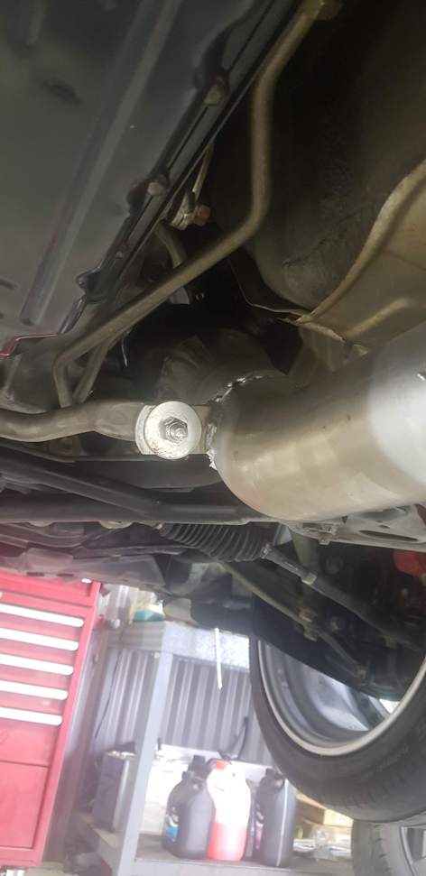

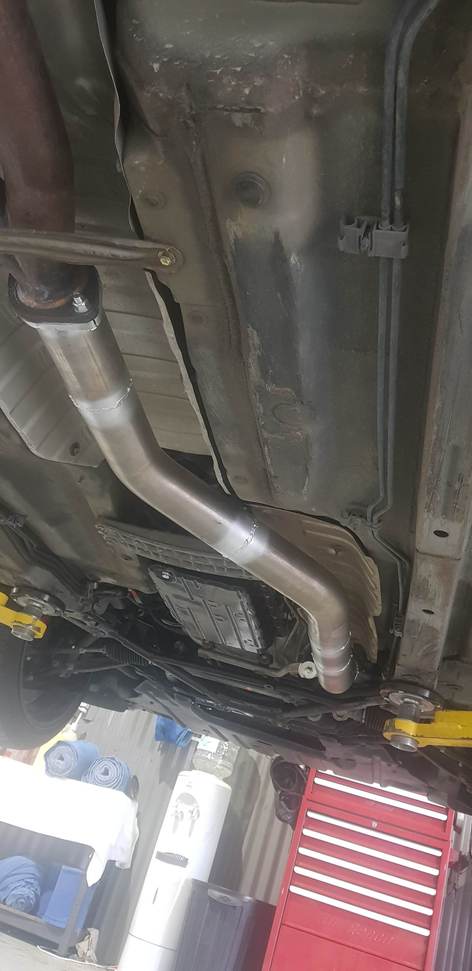

Anyways, sorry for disappearing, there have been further delays as 01+ front seatbelts now have to be sourced and we're waiting on a steering wheel that's been shipped. The car has had an alignment and midpipe made
Hi-flow cat into 3-inch pipe going straight into the Tom's catback. Now I think we're well overdue an exhaust clip
The twin turbos make the exhaust nearly silent, the turbo noise is louder than the exhaust noise

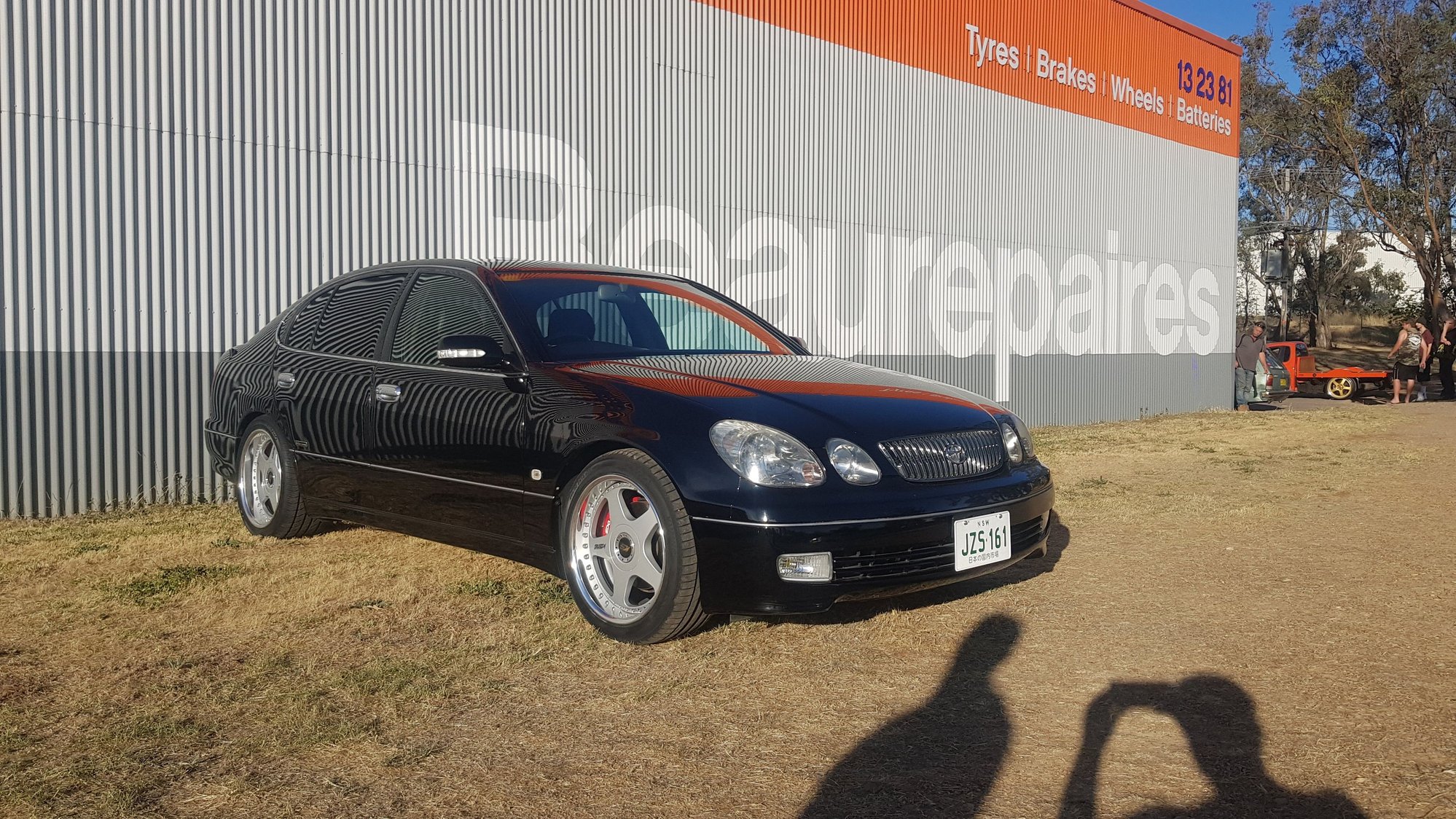

Turned out that the whole issue was just a blown fuse Interior lights and clock now work. Car has been fully polished and clay barred. Decided it's time I pull off my final trick and show off the new kicks I got for the car.
Koenig Specials
Front:
18x9 +35
Rear: 18x9.5 +28
Tyres: Kumho Ecsta 4X II / F:245 R:275
Fenders required a bit of "massaging" so the wheels could completely clear them going over bumps. These wheels are absolutely gorgeous and it's yet again all thanks to Import Monster for getting them over here. The interior was put together with the old, non-e-shift Lexus wheel as we are still waiting for the wheel airbag and seatbelts, the ARS unit was unbolted from the Aristo subframe and plugged in, sitting in the boot. The only lights on the dash were rear taillamp because of the Bragas, and an airbag light; this was all done in prep for a local car meet.
Good turnout at the meet, I was parked next to a JZS171 Crown Estate, 1JZ and 2JZ side-by-side. Had to leave early though because of an odd noise in the rear, sounded like a brake sticking. And Arussto is exactly right, Aristo power is addictive. The feeling of the second turbo kicking in is like no other, it'd be interesting to see the output of this car on a dyno.

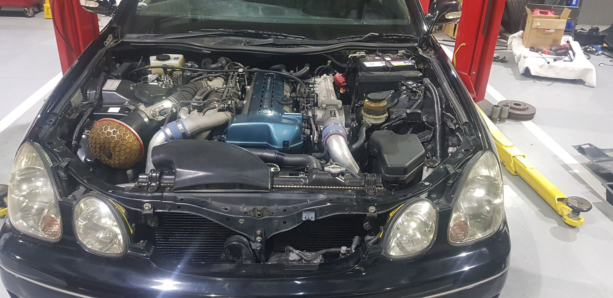

Aristo Swap Finale
Not much has been done to the car since, won't be able to fix the airbag situation for about a month so I'll have to put up with the airbag light and lack of e-shift buttons. I've been back to dailying the car and so far have been loving it, except the air conditioner gas has leaked out so I've got no AC until I can get it fixed and re-gassed; which isn't ideal in 40°C+ weather. Oh well, I've survived in this car without AC before. I wanted to do the final write-up once everything was fully together but I better do it now.
I'm not sure if there are many people who have done a full GS - Aristo shell swap, with that being said I got pretty lucky with everything such as the goodies that came with the Aristo and no powertrain issues whatsoever. I'd like to make it clear that for anyone planning on doing an Aristo swap that it shouldn't be as labour intensive as this has been, I'm pretty sure standard swap procedure is engine + trans + ECU. The only reason we chose to do a shell swap was to make sure everything was plug and play along with having everything just being a lot newer. Here's a list of things that have been fixed and added as a result of the JDM loom/parts:
  • Door locks now work
  • AC now works (We bent a pipe causing the leak)
  • Interior looks great now with blackwood and no cracked tubing on seats
  • No more exhaust rattle from heatshields that were scraped flat
  • All windows are now fully auto
  • Sunroof is now fully auto, used to be auto-open and hold to close but it would stop half-way as per Aussie design rule
  • No more random transmission issues
  • No more misfiring
  • Both outside and inside taillights light up, which really shows off the Bragas
  • Chrome grill + Boot bar
  • Vertex edition badges
  • Newer body panels
  • Tanabe coilover
  • 2JZ-GTE, A340e and TOM's ECU
Feel free to ask any questions on the swap and I'll do my best to answer, I'm very happy with the result of this swap as it's now given me a platform that I can further build upon both power and look wise.
