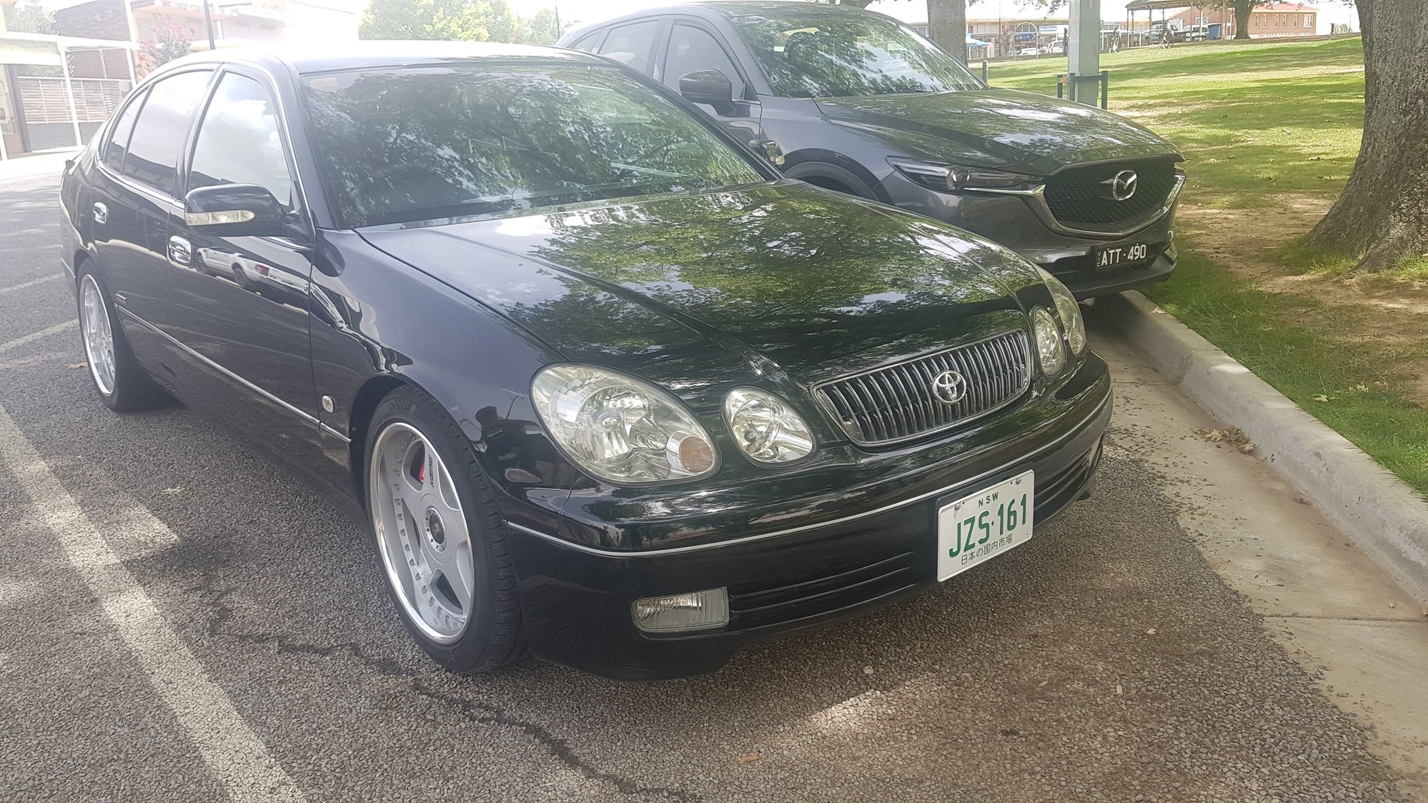

Going pretty well, it's been used as a work commuter up until a week ago when I went on a "cruise". It was a cruise through a very twisty mountain road, however, due to some poor communication they had left early without us . Thankfully I was with someone so we went on their route without them, I was chasing this;
an FPV GT, we didn't go too hard because the last thing we want is sending one of our cars off the side of the mountain. I was able to sus out a few issues with the car on the drive though. The Tanabe coilovers seem to be worn as the ride is too soft around corners, this is evident from what seems to be a bit of oil leaked out on the strut and it has no damper control. The engine was slightly pre-igniting when it got hot after giving it some ****, hopefully this is just a case of cleaning out the head to get rid of any carbon. And the brakes are pretty well worn with them now being warped and squealing.

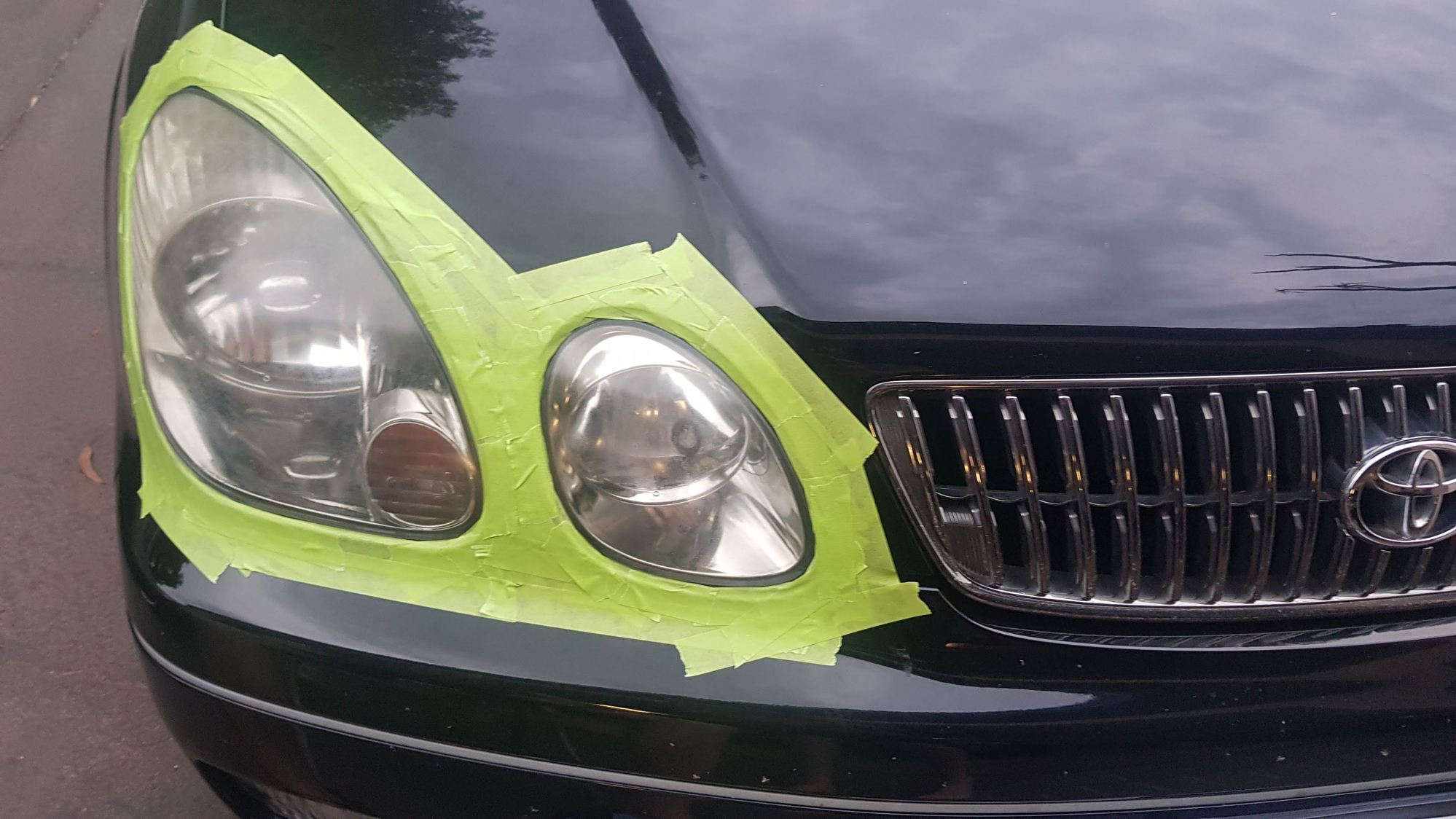

Another issue that arose before the cruise was the door locks randomly cycling when hitting bumps or taking corners, I JUST CAN'T GET AWAY FROM DOOR LOCK ISSUES Something must be loose somewhere so it can be fixed once we try and get the audio sorted out. Headlights were also polished before the cruise but no coating was put on it so we'll see how long it lasts.
