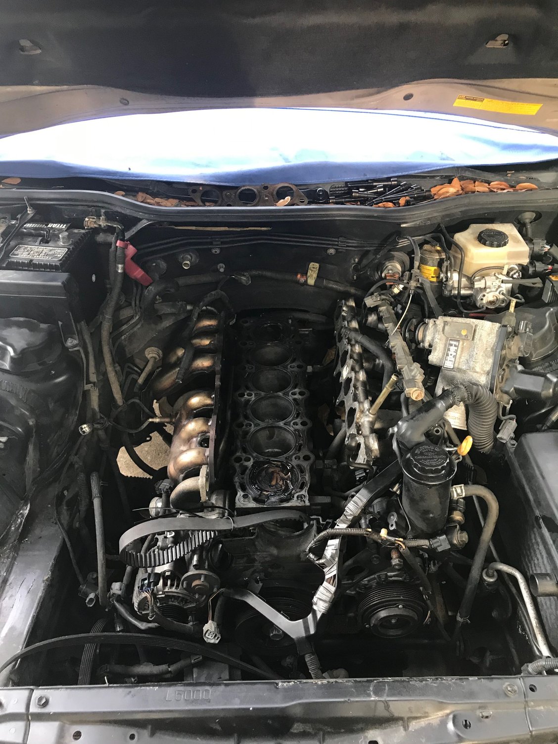

Just joined the forum, hoping to chronicle my adventures with this build and also receive some guidance from you all. I am a small block Chevy guy, I don't know **** about Japanese cars. This car fell into my lap for nothing. My dad got it as part of a trade and it just sat there at my grandpaws house until I showed interest in it. Car has 101k miles on the original engine and drive-train, Sport Design model too (whatever that means)! It was in an accident and the engine jumped timing and bent two valves. I have the head at an engine shop getting resurfaced and the valve-train being gone through. My plan is to do a DIY NA-t setup and learn some stuff about boosting engines along the way. I have done a little reading into what this takes and came across this article. I'd like to end up around 400HP (reliably, would like to drive it a few times a week), which raises my concerns about the compression ratio and ignition system. I already bought a complete gasket set which I'm pretty sure is for the GE engine and will not lower the compression like I want. Where do I buy the one I need? Next I need to go ahead and order new plugs/wires/coil while this is all off (and anything else I'm not aware of that should be changed at this stage). That article also says I'll need different plugs than stock but will the engine run fine on those plugs he mentioned in the meantime without boost? It may be several months before I gather parts for the turbo build and I'd like to be able to drive the car during that time.

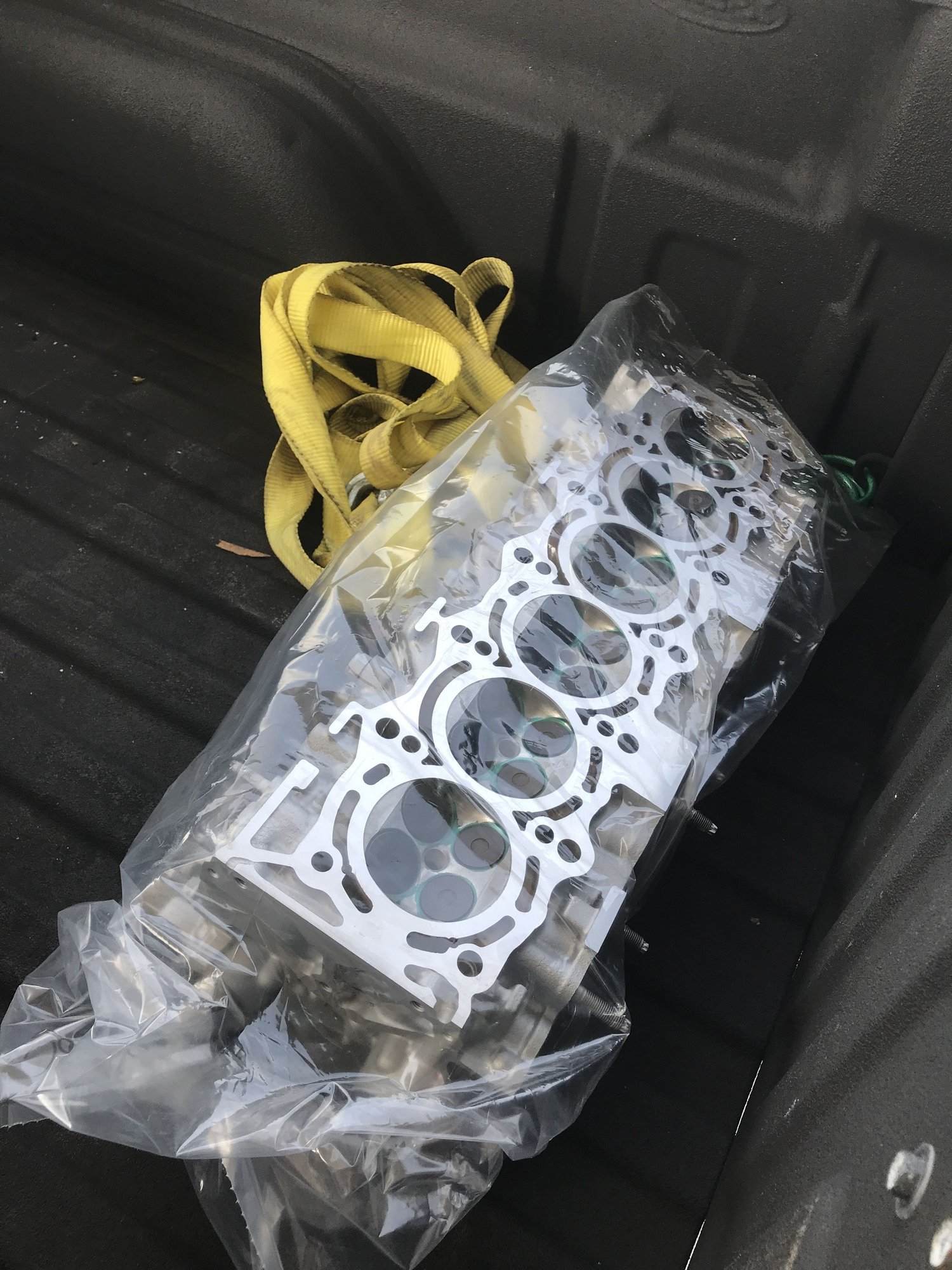

I ended up finding a place that can make me a custom gasket. But now that I think of it, I'll probably just put the stock sized one from the complete kit I got back on it for now. I really just wanted the car to move under it's own power to get it to my house. But I figure in the meantime I can be playing with suspension and wheels so I want it to run good. Just picked up the head today!
