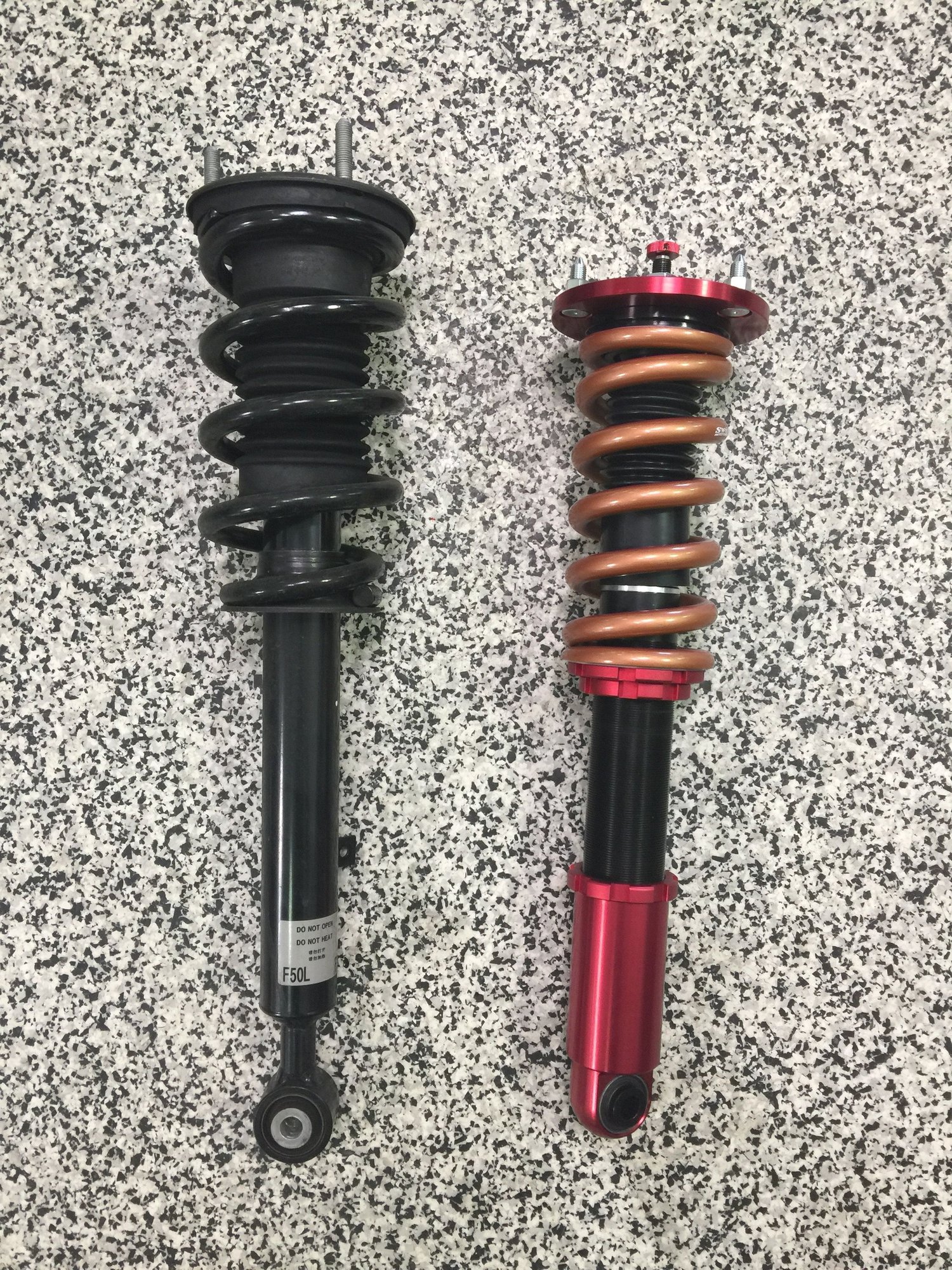

Old Jan 23, 2018 | 08:08 AM
  #131
biggame's Avatar
biggame
iTrader: (9)
Joined: Jan 2013
Posts: 660
Likes: 124
Here is the Novel system next to the stock suspension for a visual comparison
  #132
biggame's Avatar
biggame
iTrader: (9)
Joined: Jan 2013
Posts: 660
Likes: 124
Installation was super easy as expected for the front, rear was a little more intense. Adjustment to lower or raise you Lexus is quick and easy!

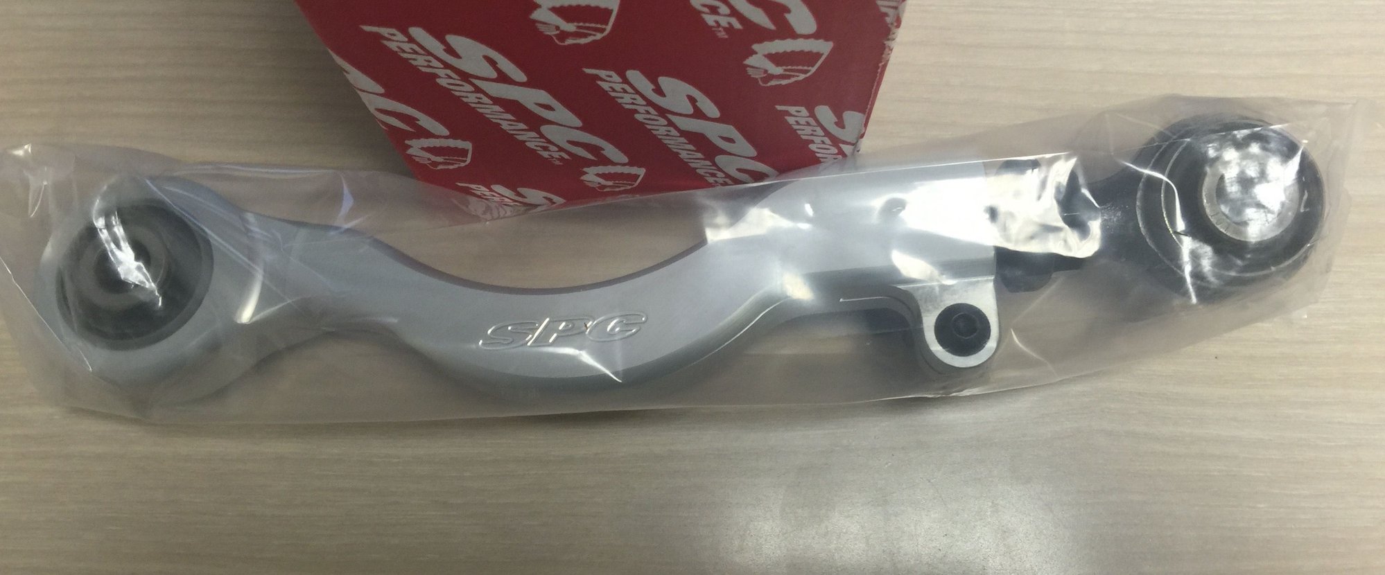

Old Jan 23, 2018 | 08:09 AM
  #133
biggame's Avatar
biggame
iTrader: (9)
Joined: Jan 2013
Posts: 660
Likes: 124
Decided to go with Specialty Products for my rear camber needs. Well made quality product
Specialty Products adjustable camber arm side by side with the stock suspension upper arm
Old Jan 23, 2018 | 10:19 AM
  #134
finny76's Avatar
finny76
Joined: Apr 2014
Posts: 669
Likes: 87
From: DFW
What was the weight of the stock suspension VS NOVEL?
