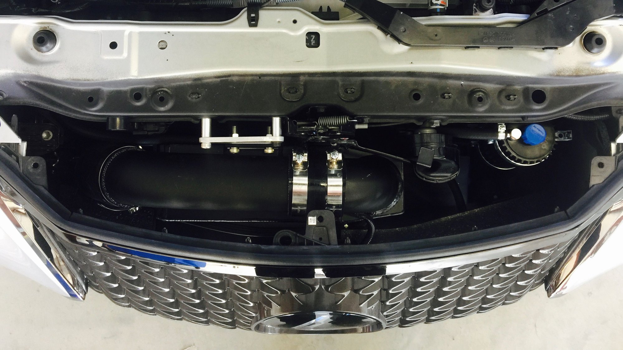

Had to modify the RT Apron for piping. Decided to install sound pad to make it look a bit cleaner
Lower piping being ran through apron
Intercooler installed. Aligning the piping
Also had to trim the RT Reinforcement extension on the bottom. Nothing serious

Had to modify the RT upper support for intake piping. Support is covered by a plastic shield
All upper piping / air filter mocked up. Time to tighter everything down

For maximum air flow to intercooler we had to modify the reinforcement....See Below
We went ahead and refinished the reinforcement. Even though it's not seen, I think it looks way cleaner this way

Supercharger oil reservoir, filter, and oil cooler installed
Reinforcement installed...The modification made to the reinforcement matched perfectly with the intercooler

Cut the absorber to match the reinforcement for maximum airflow
To keep air flow going to the intercooler, we had to cut the inside of the bumper to match the reinforcement
Cut lines marked
Perfect cutout!
Bumper installed! With the upper shield removed you can see how nice everything fits. Also, easy access to the oil reservoir
