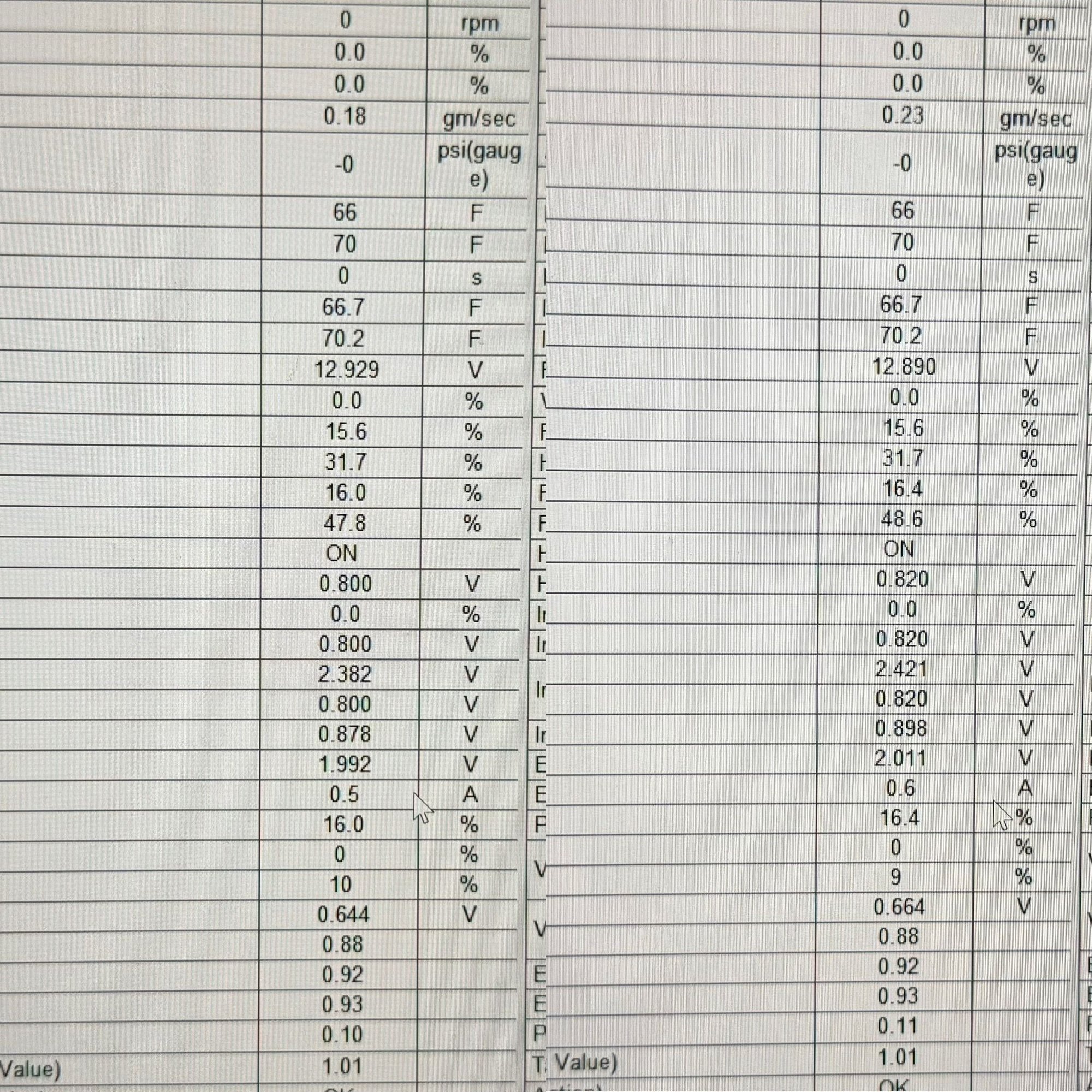

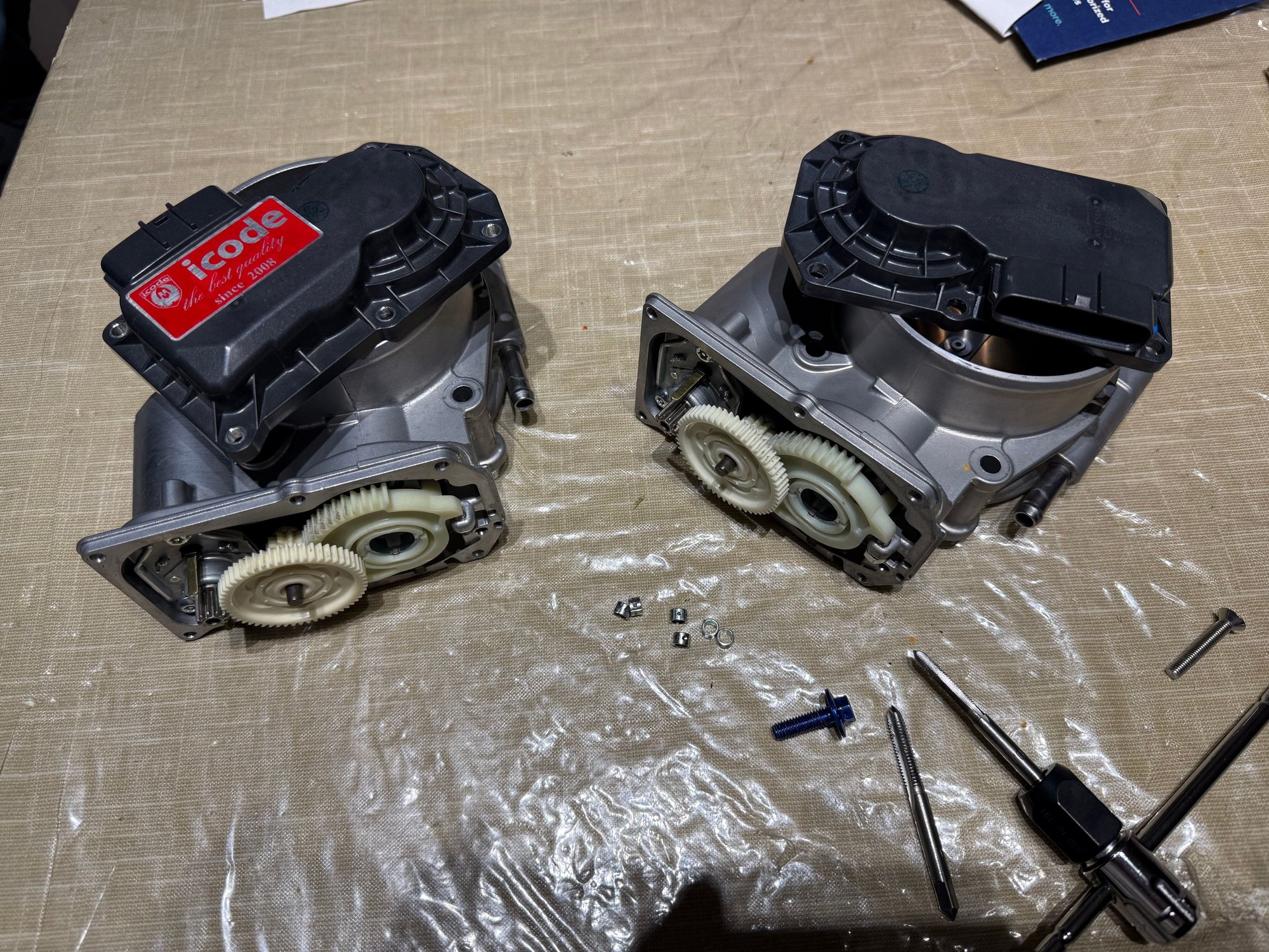

Parameters from both TB’s.

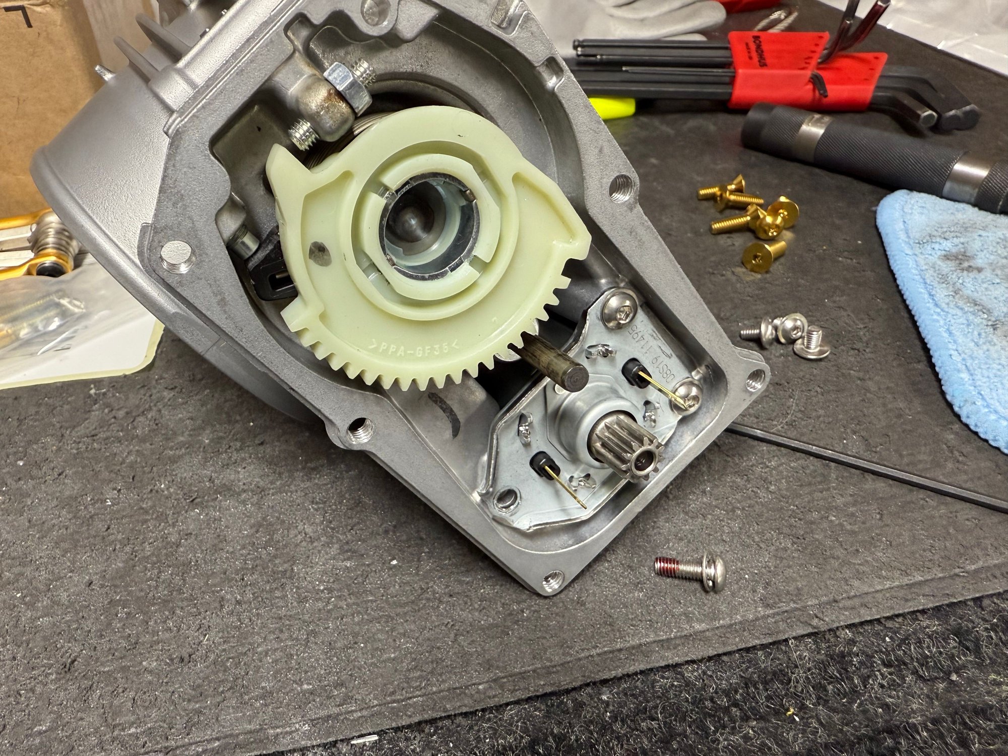

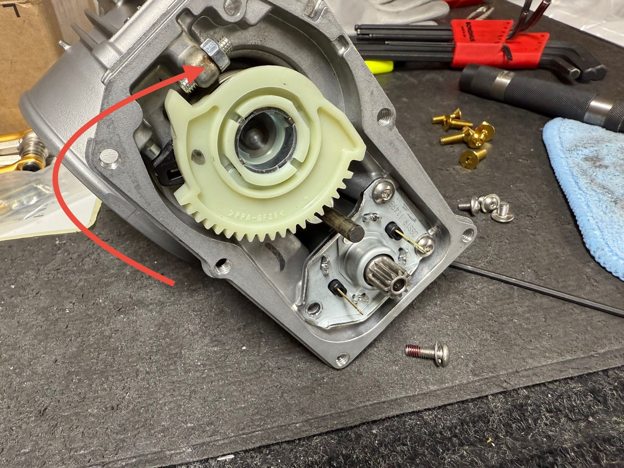

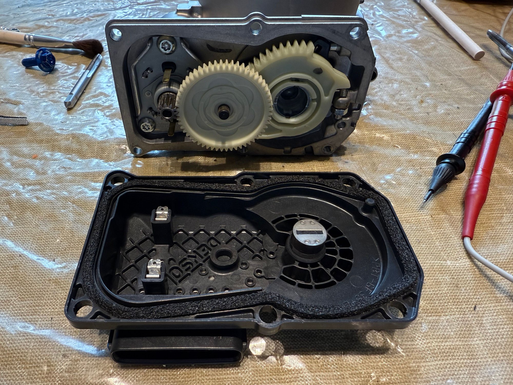

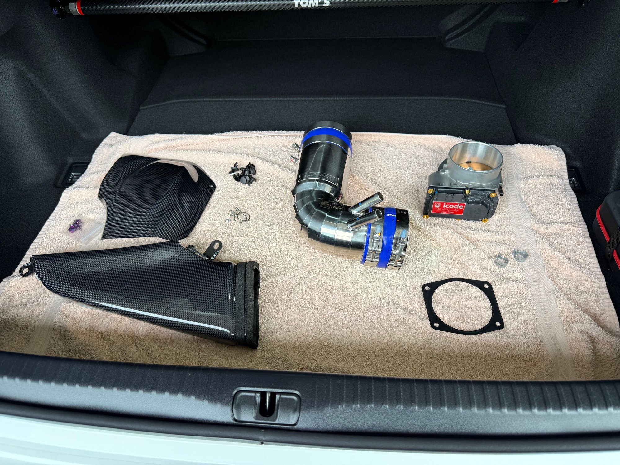

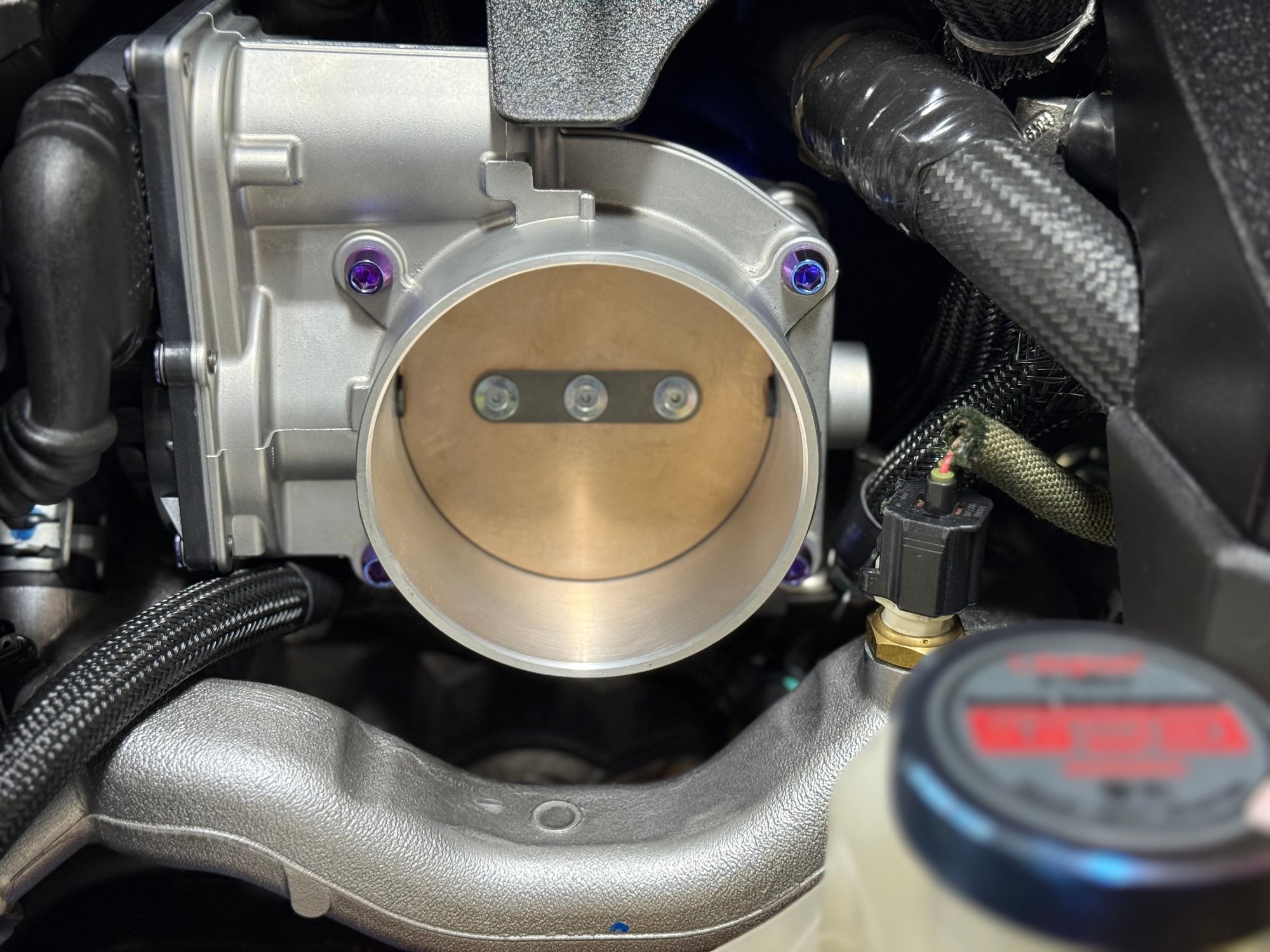

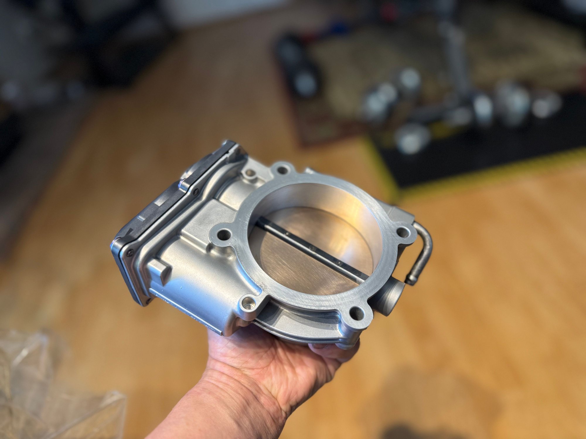

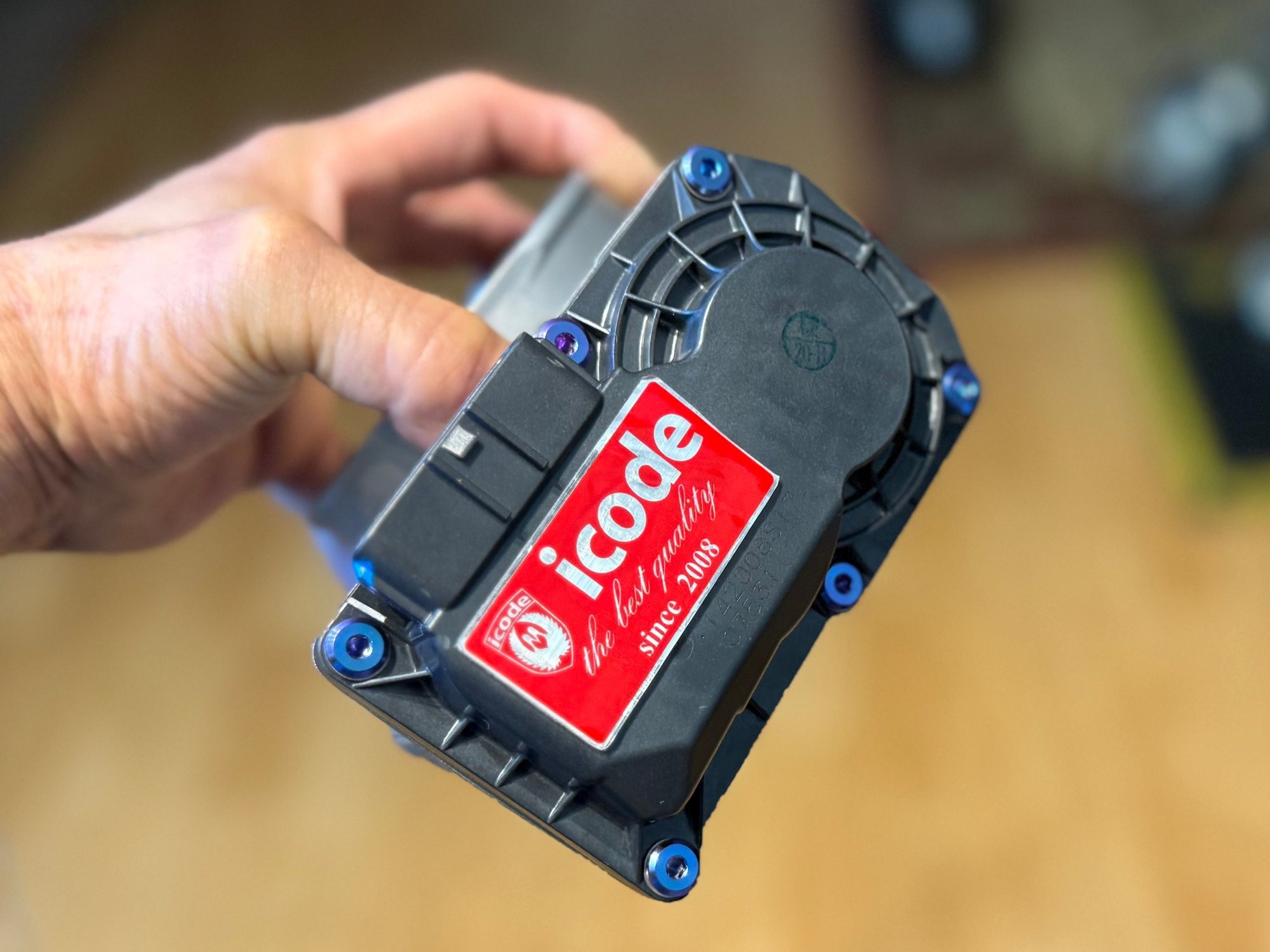

Swapped over servo and position sensor from my spare/original TB. Adjusted throttle stop setscrew to raise idle speed. Polished the edge around the throttle plate, cut plate screws flush, threaded and tapped for Ti screws, and re-installed. Revised tune with new target idle tables from Loi working perfect so far.

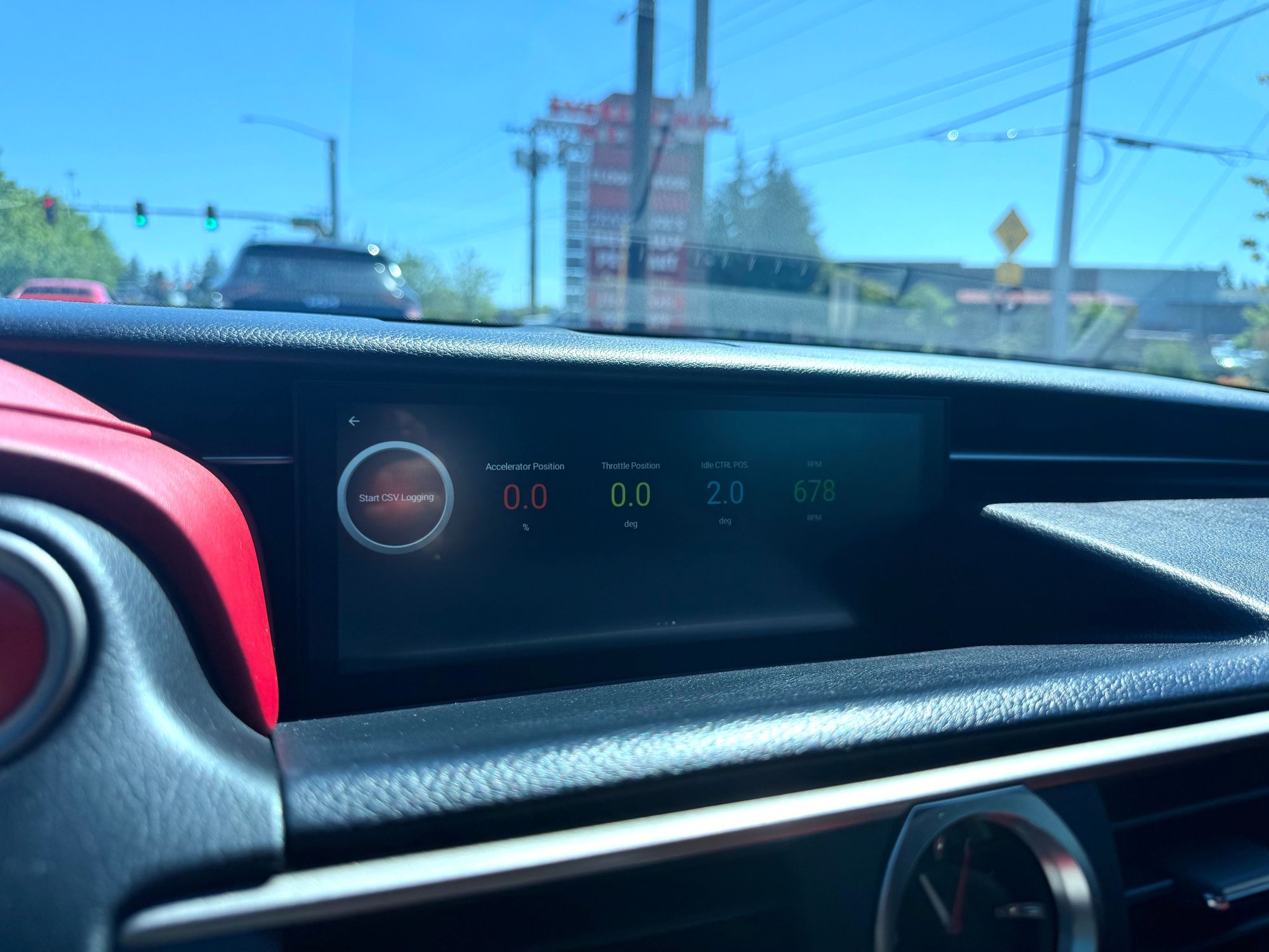

Several cycles last few days and so far, so good. No codes.

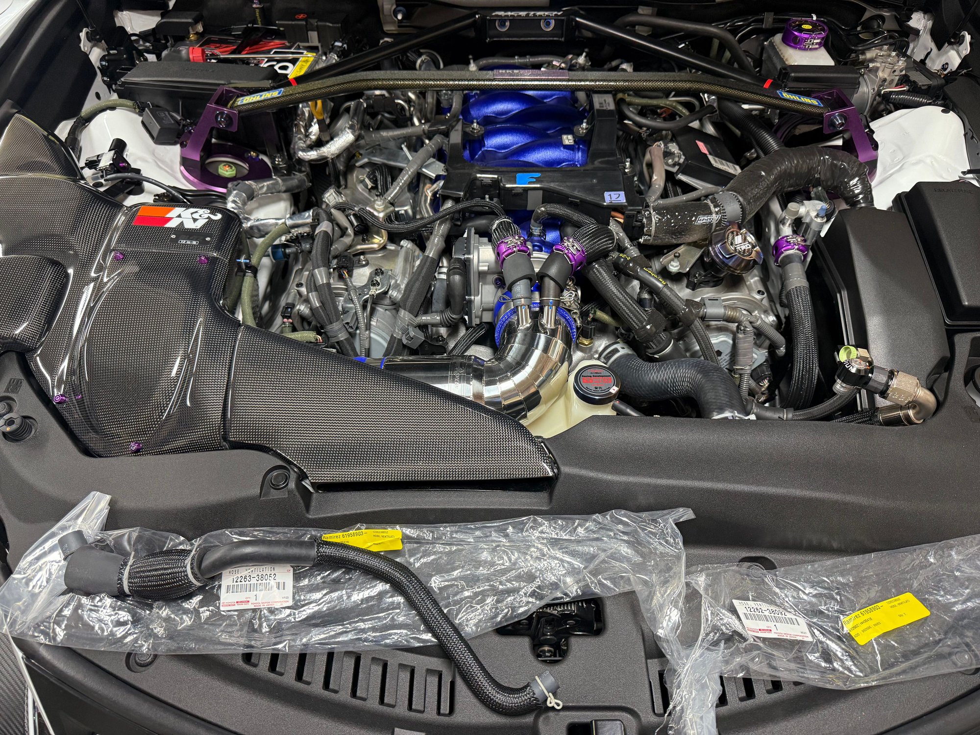

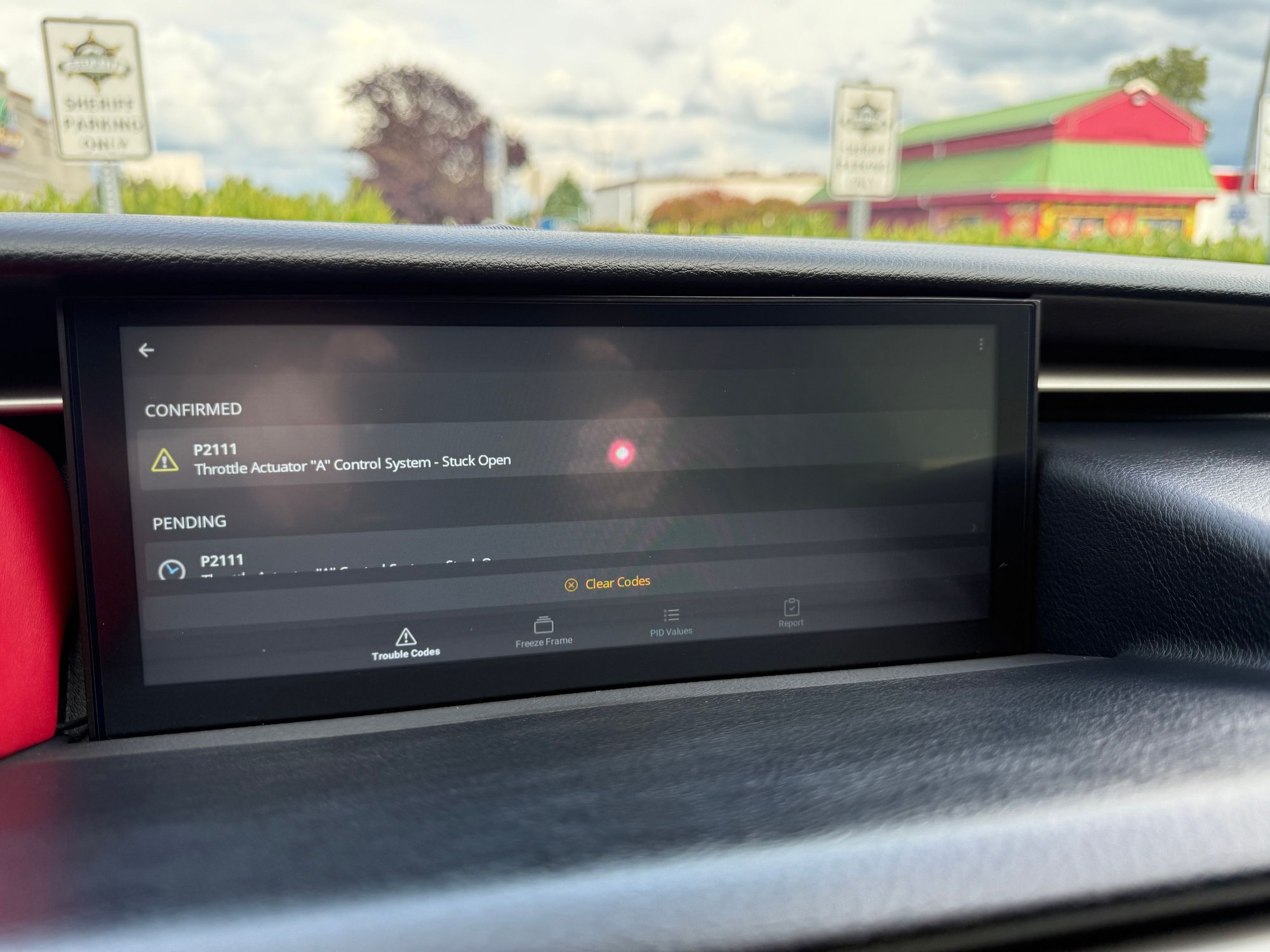

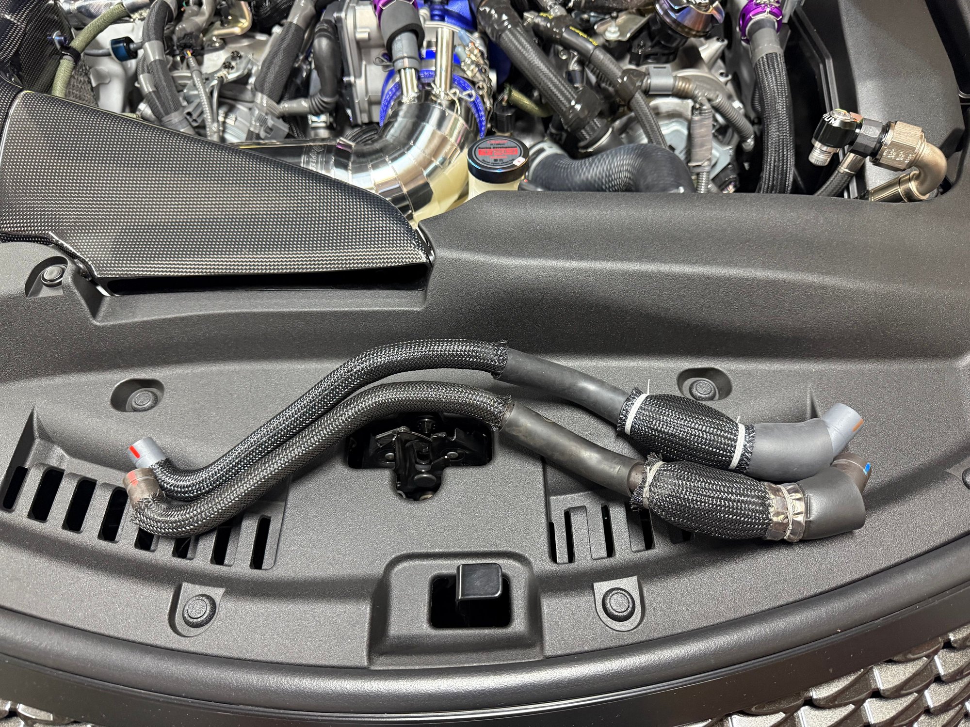

Follow up on the P2111. Toyota released L-SB-0032-25 late July I believe. Supposedly, fix for the P2111/P0505 (accelerator stuck open/idle control malfunction) is a new Throttle body and updated #2 and #3 vent hoses. I’ve already fixed the TB 40+cycles since the TB rebuild and no P2111) and decided to go ahead and order the updated vent hoses. I expected to see obvious differences but both look exactly the same.

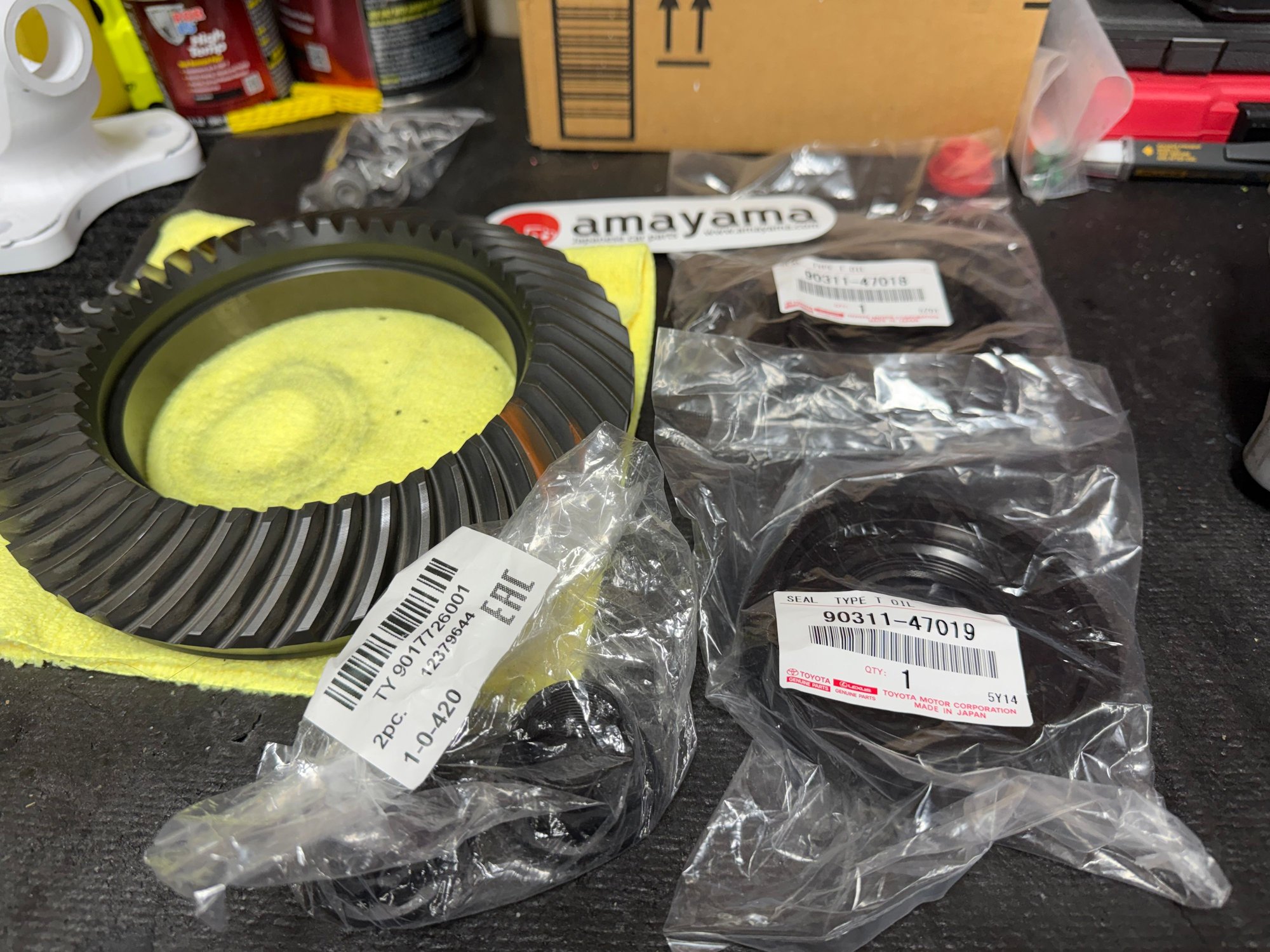

3.13:1 final drive, OS Giken TCD LSD, track edition axle shafts. Will send ring and pinion out for Cryoheat treat and WPC.
Brand new 3:13 differential.
Brand new 3.13:1 differential.

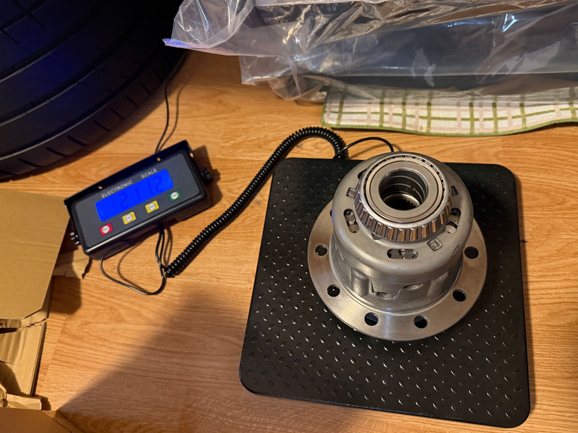

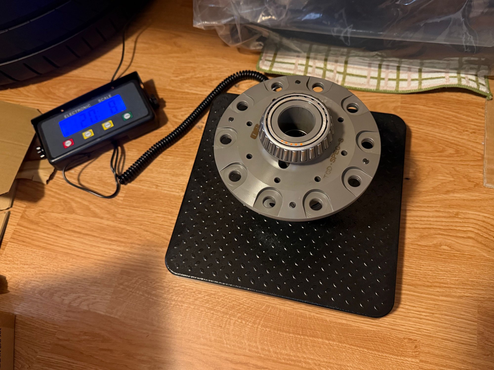

Torsen weight with bearings
Torsen weight with bearings.
OS Giken weight with bearings.

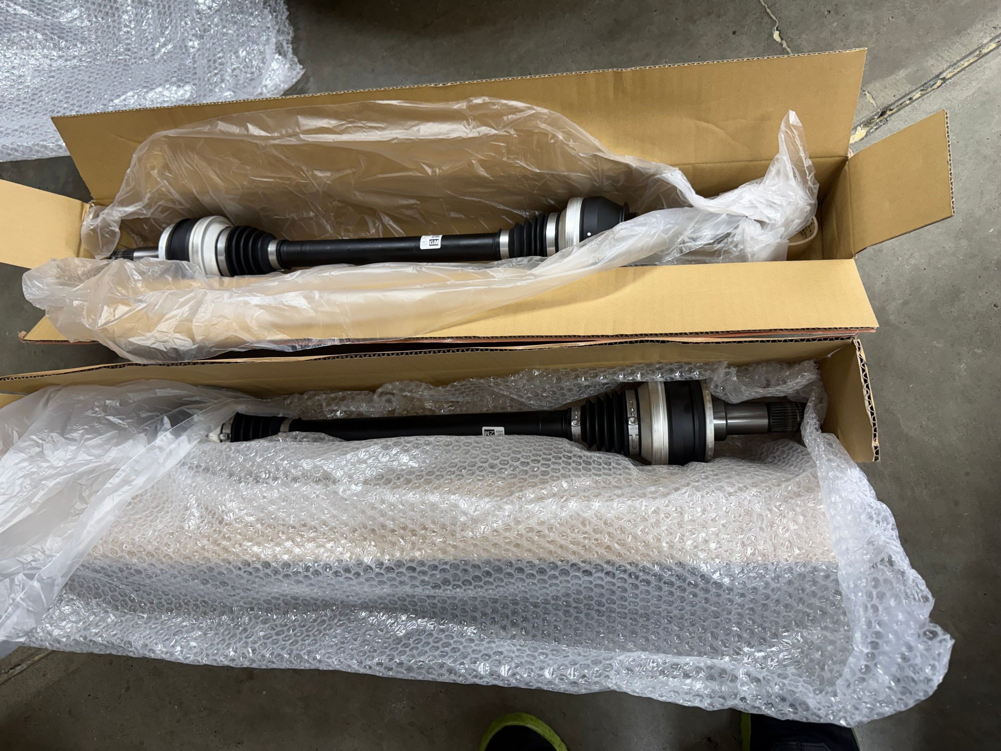

Track Edition axle shafts.

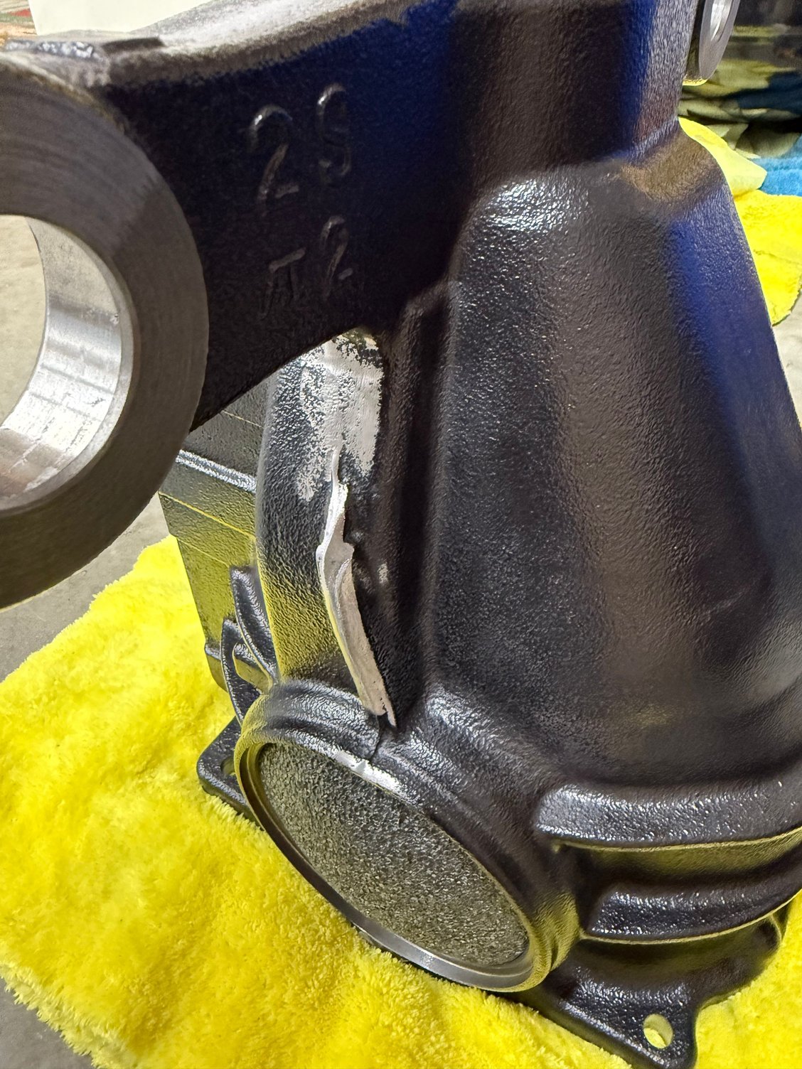

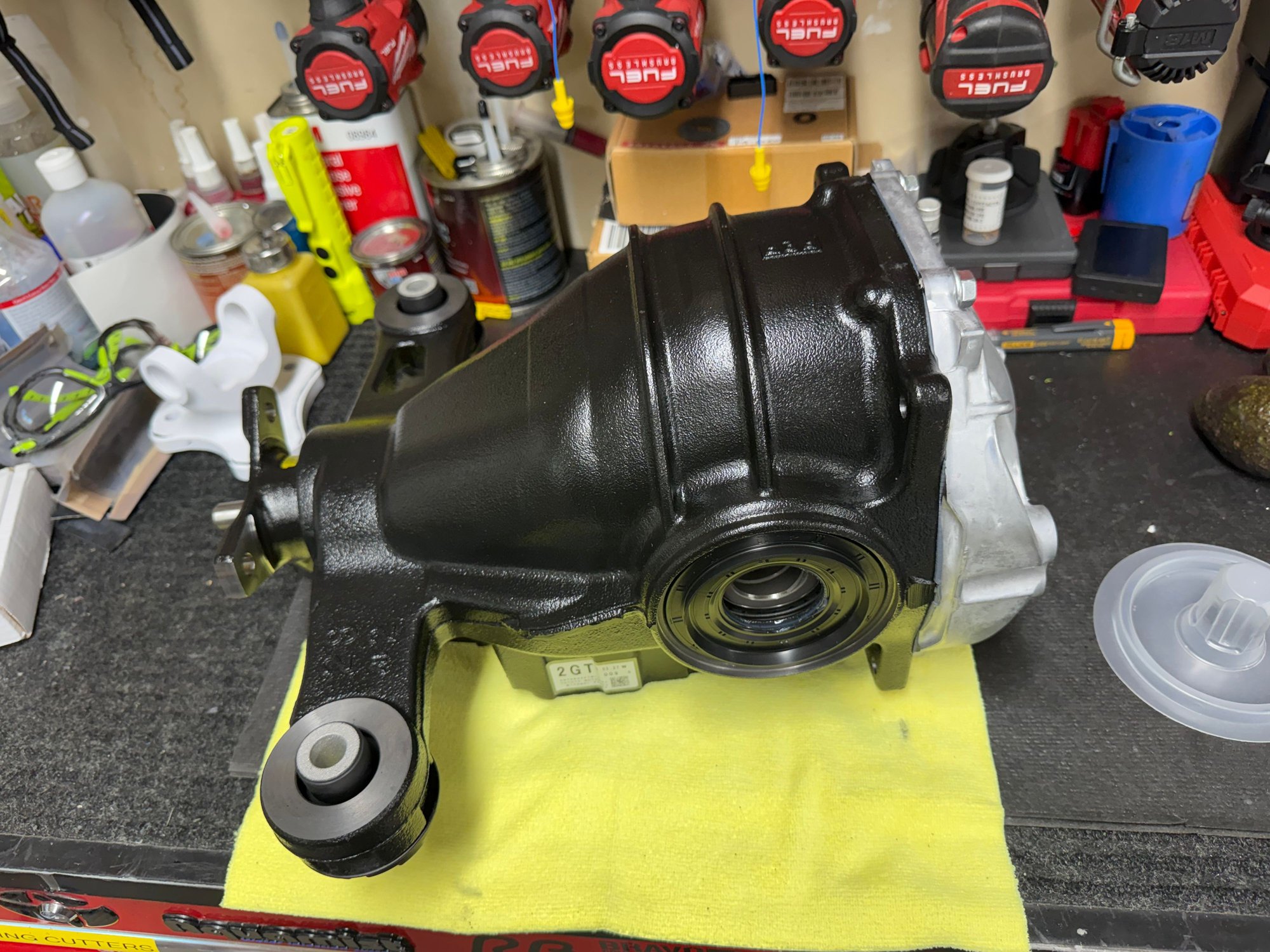

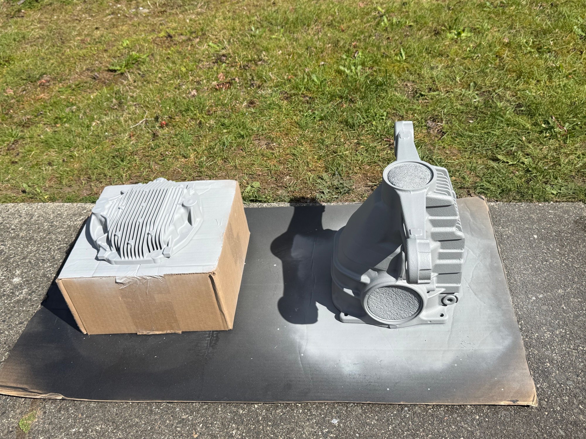

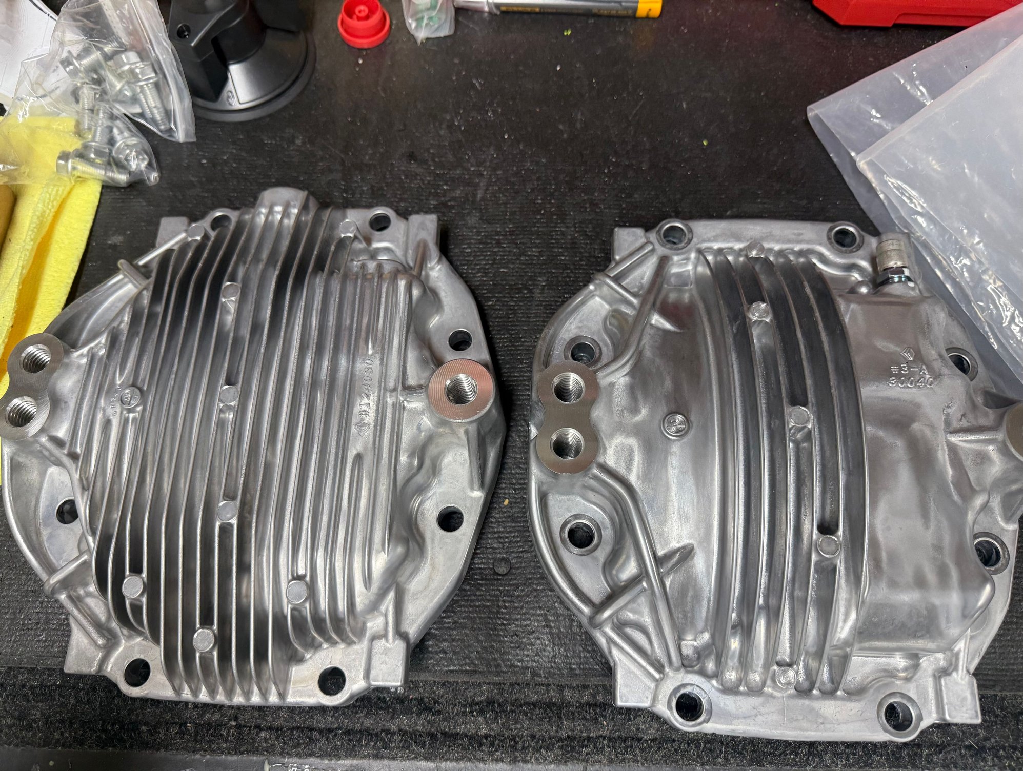

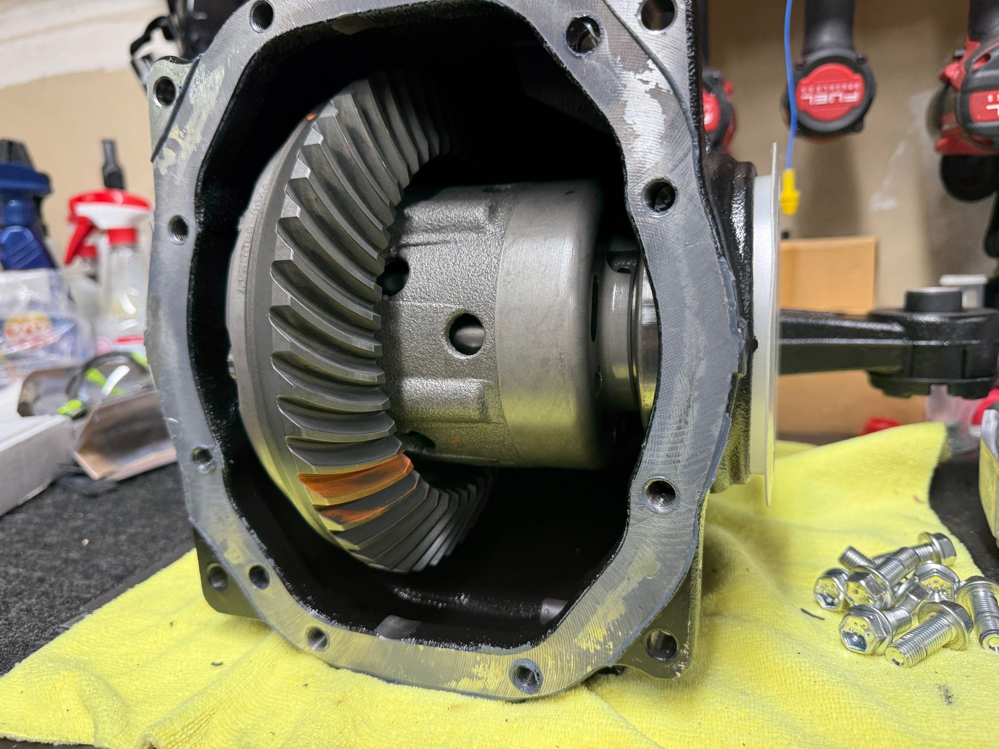

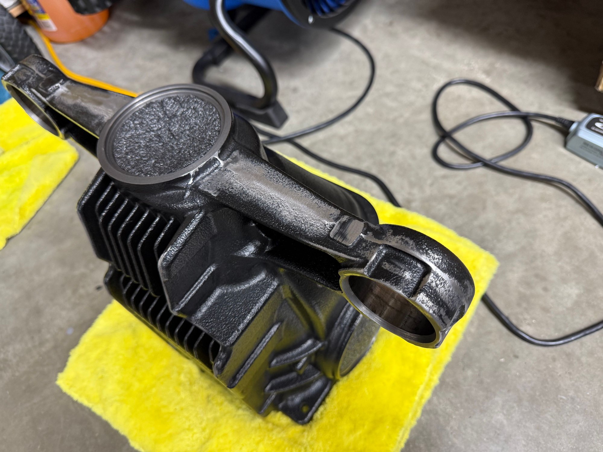

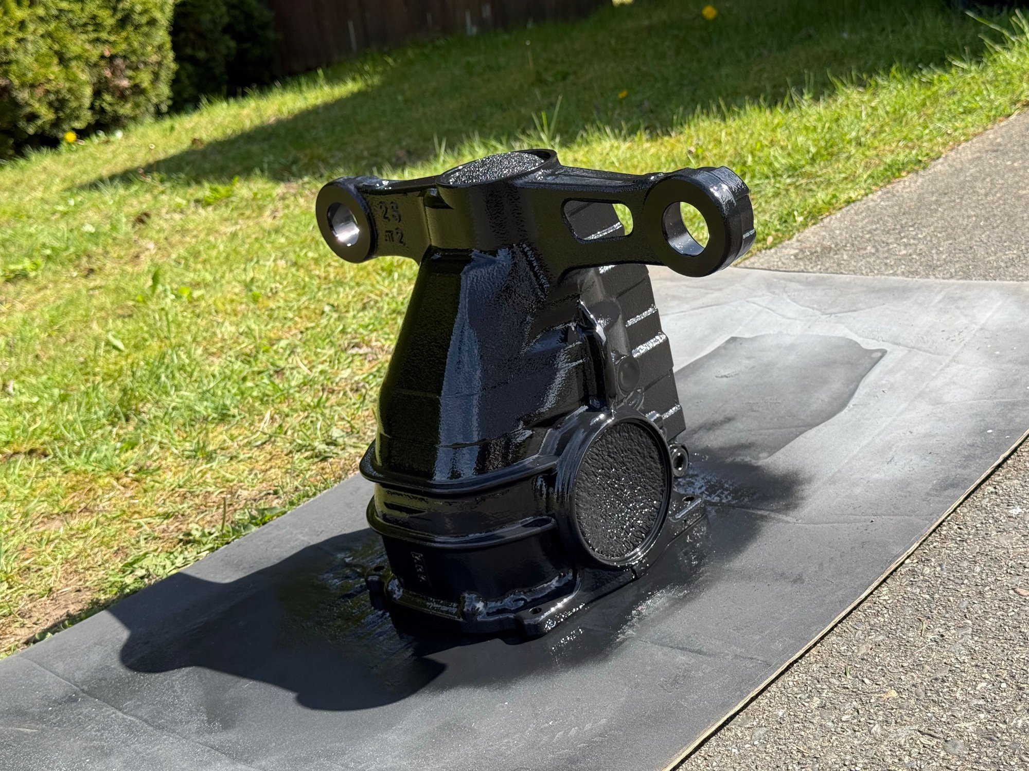

Diff housing cleaned up, ready for paint, bushings removed, will be using FIGS poly bushings.

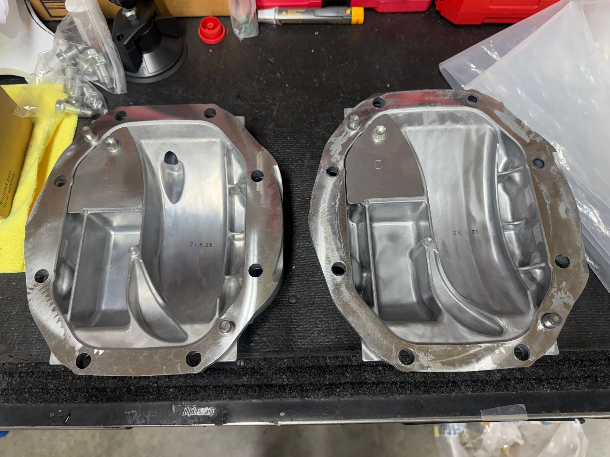

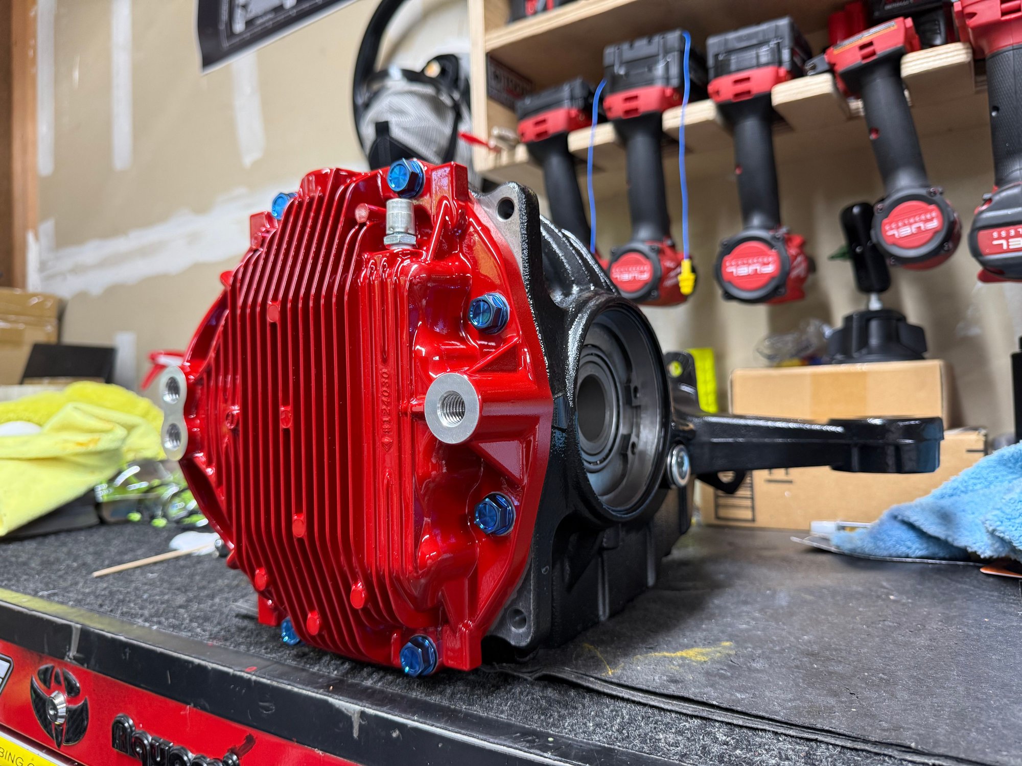

Torsen and TVD diff cover comparison.

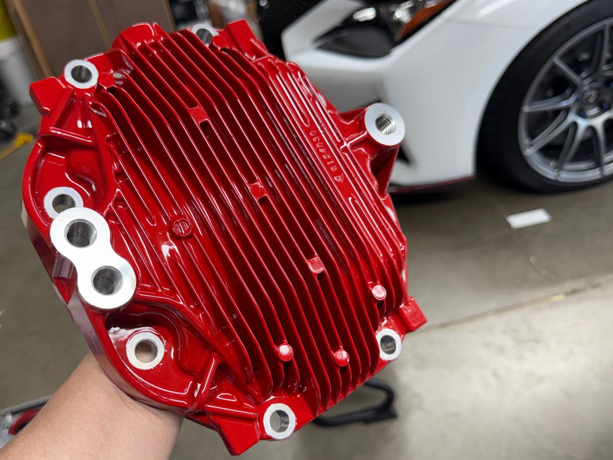

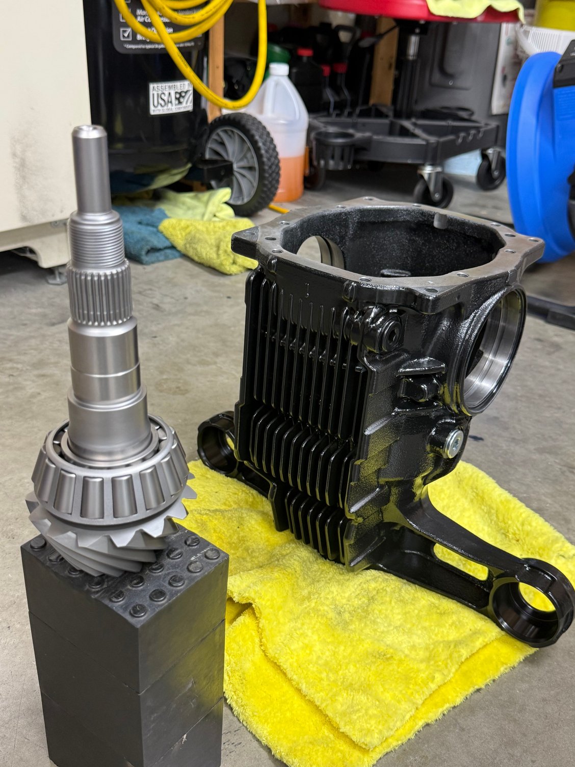

2K high temp epoxy primer and then 2K high temp ceramic black and red.
Just waiting for the internals to come back from CTP Cryogenics.

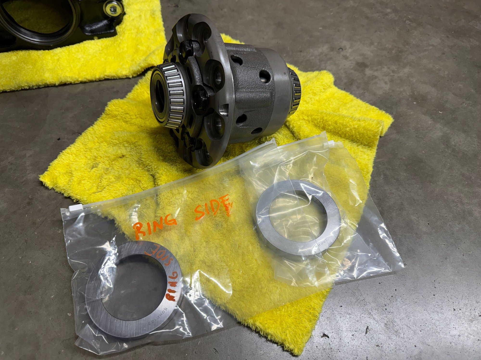

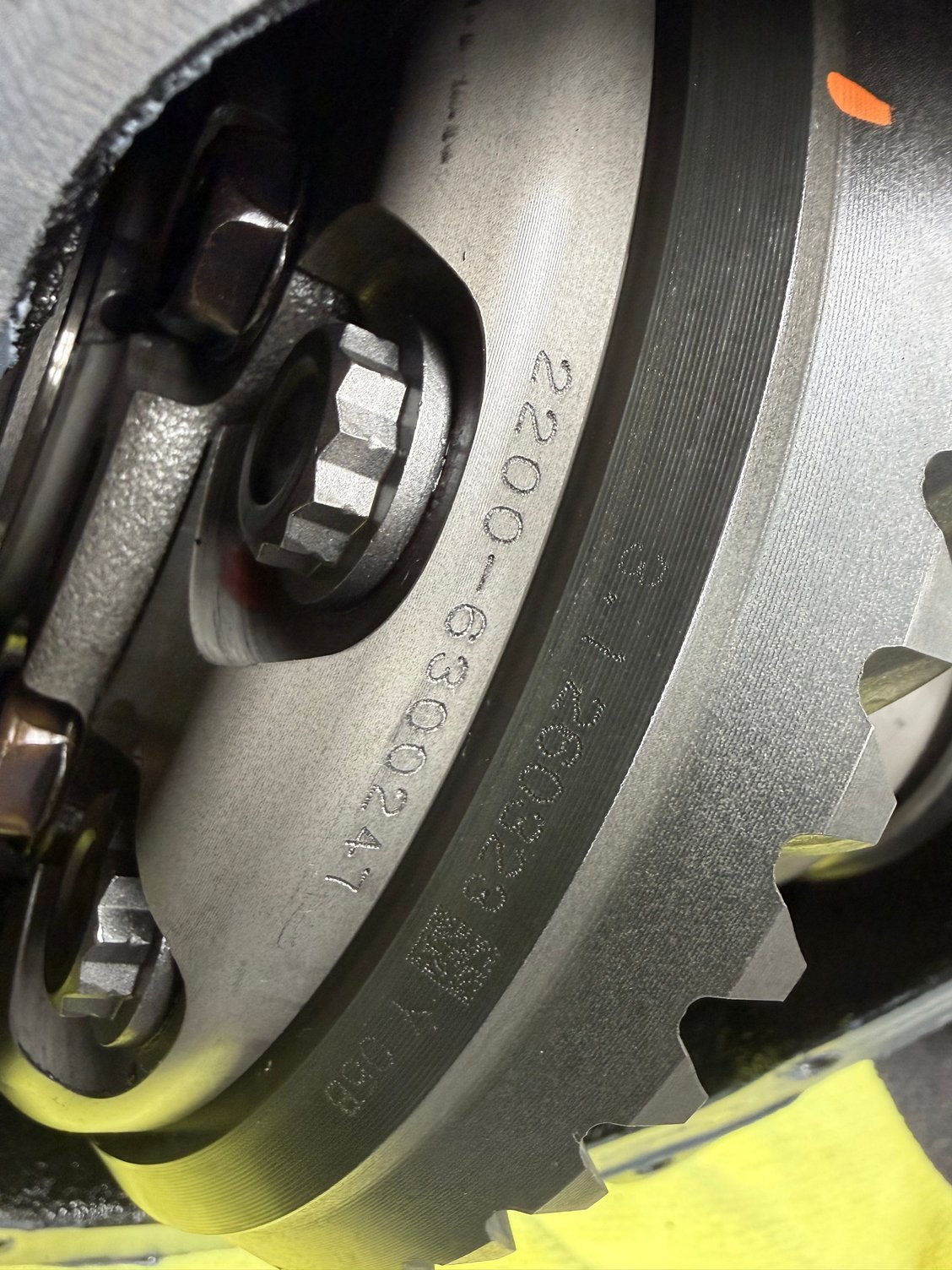

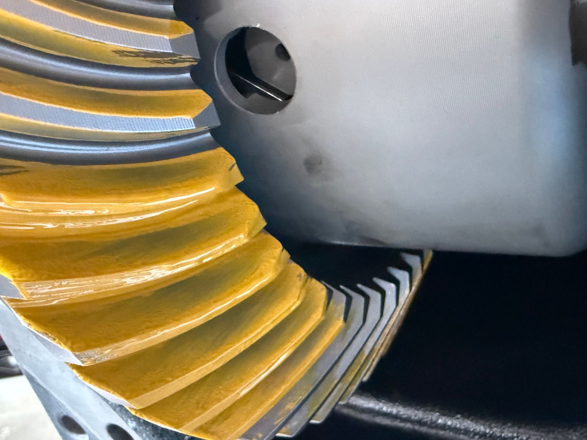

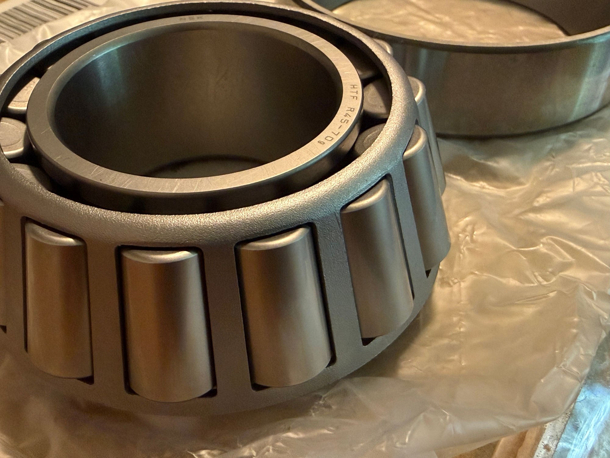

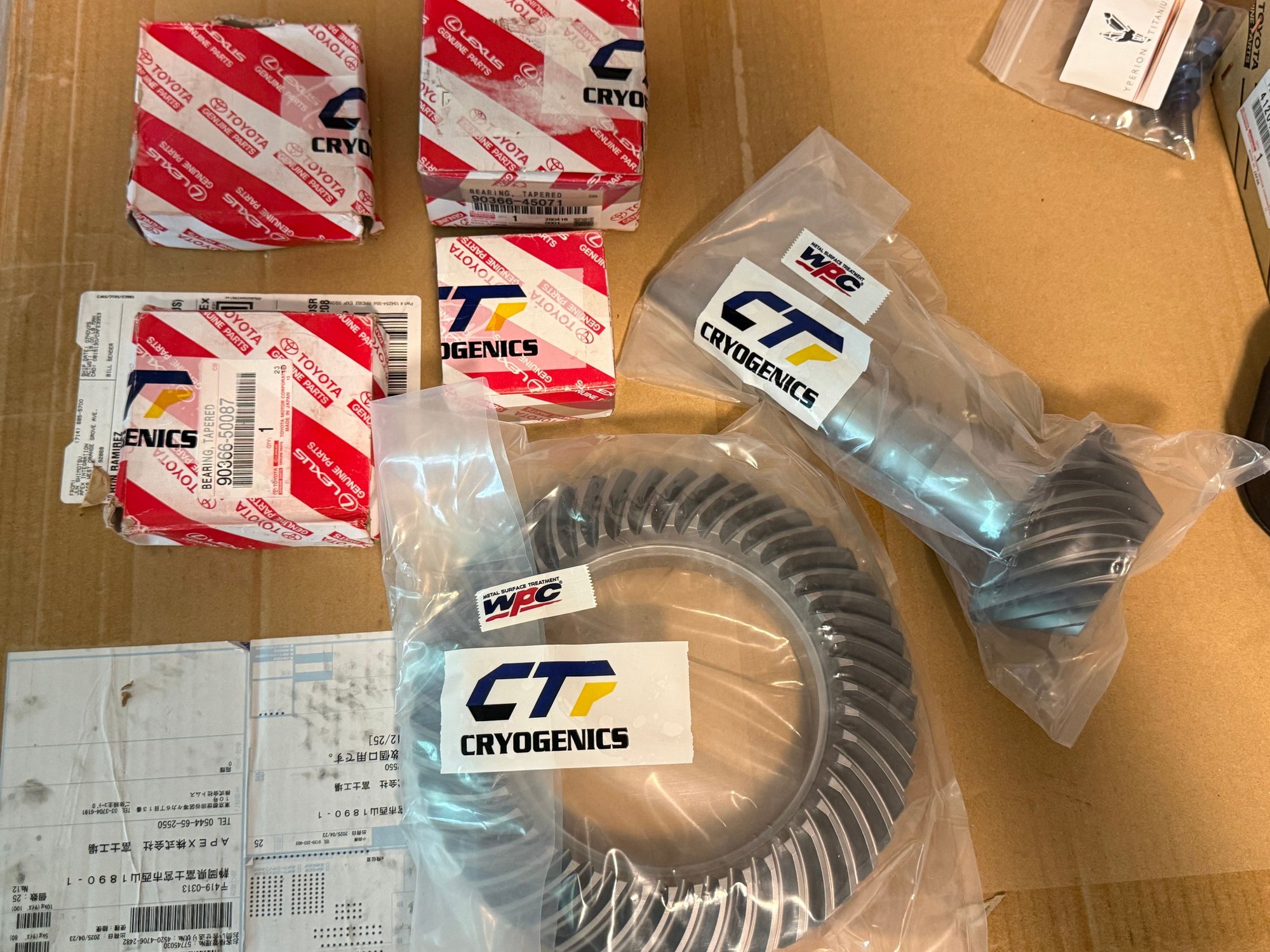

Diff parts are back from CTP Cryogenics. All parts got cryo and WPC treatments.
