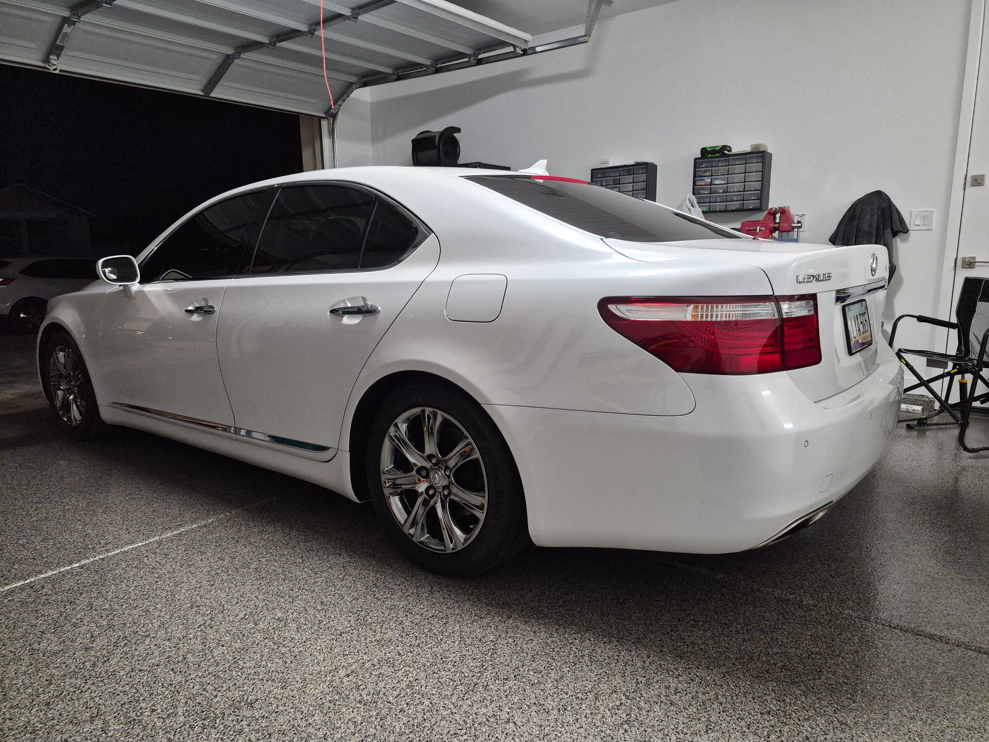

Hello, everyone. Welcome to my build thread.
I recently purchased a 2007 Lexus LS 460 from a dealership in Phoenix, Arizona. The car has 88,000 miles and is in great condition. Unfortunately, I purchased the car on a cool evening, so I was unaware that the dash (upper and lower) and center console suffered from the dreaded stickiness. I had the option of returning the car, but it is in such good condition otherwise, that I chose to keep it.
As I do with all my vehicles, I started with installing floor liners (WeatherTech, in this instance). I highly recommend these floor liners: they fit excellent and look great. I also had the windows tinted with 20% ceramic film.

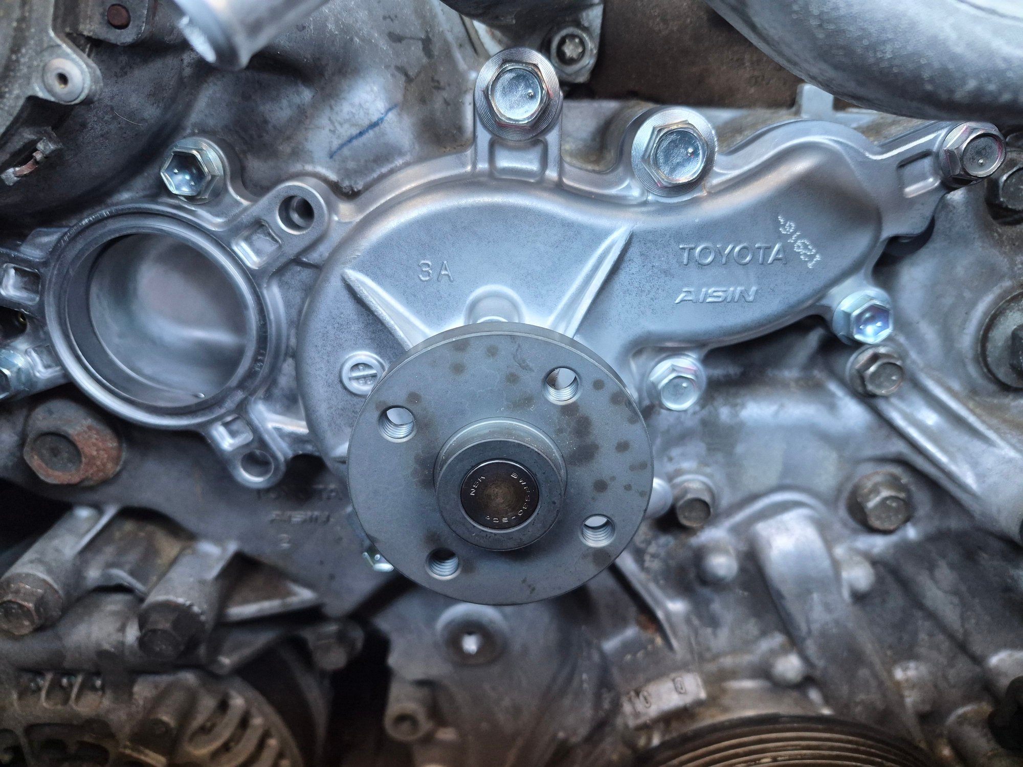

When inspecting the car closer at home, I discovered that the water pump was leaking. Therefore, my first order of business was to replace the water pump. While working in that region of the engine, I decided to also replace the belt tensioner, idler pulleys, and serpentine belt. With the exception of the belt tensioner (Dayco) and serpentine belt (Gates), everything is genuine Toyota/Lexus.

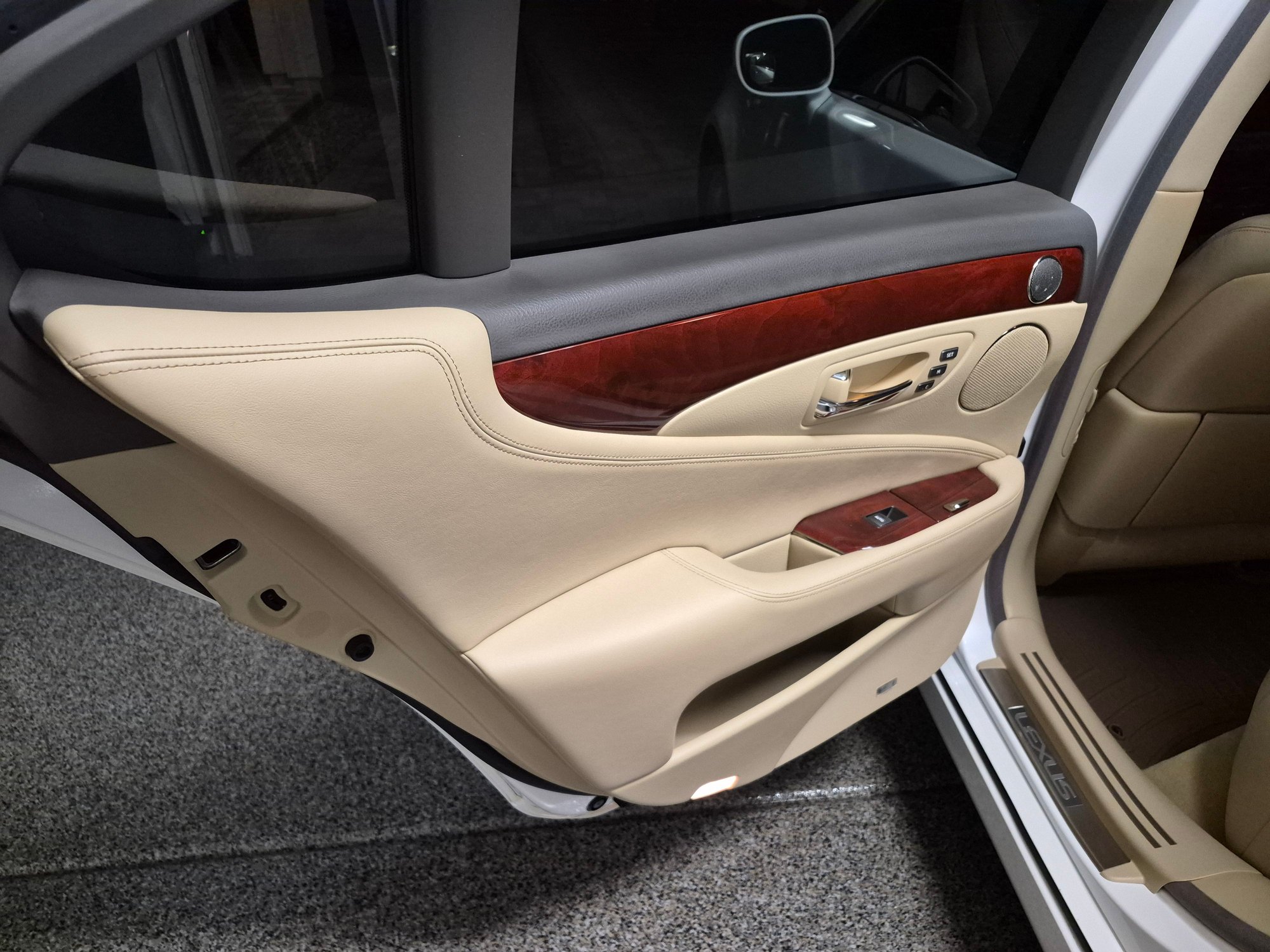

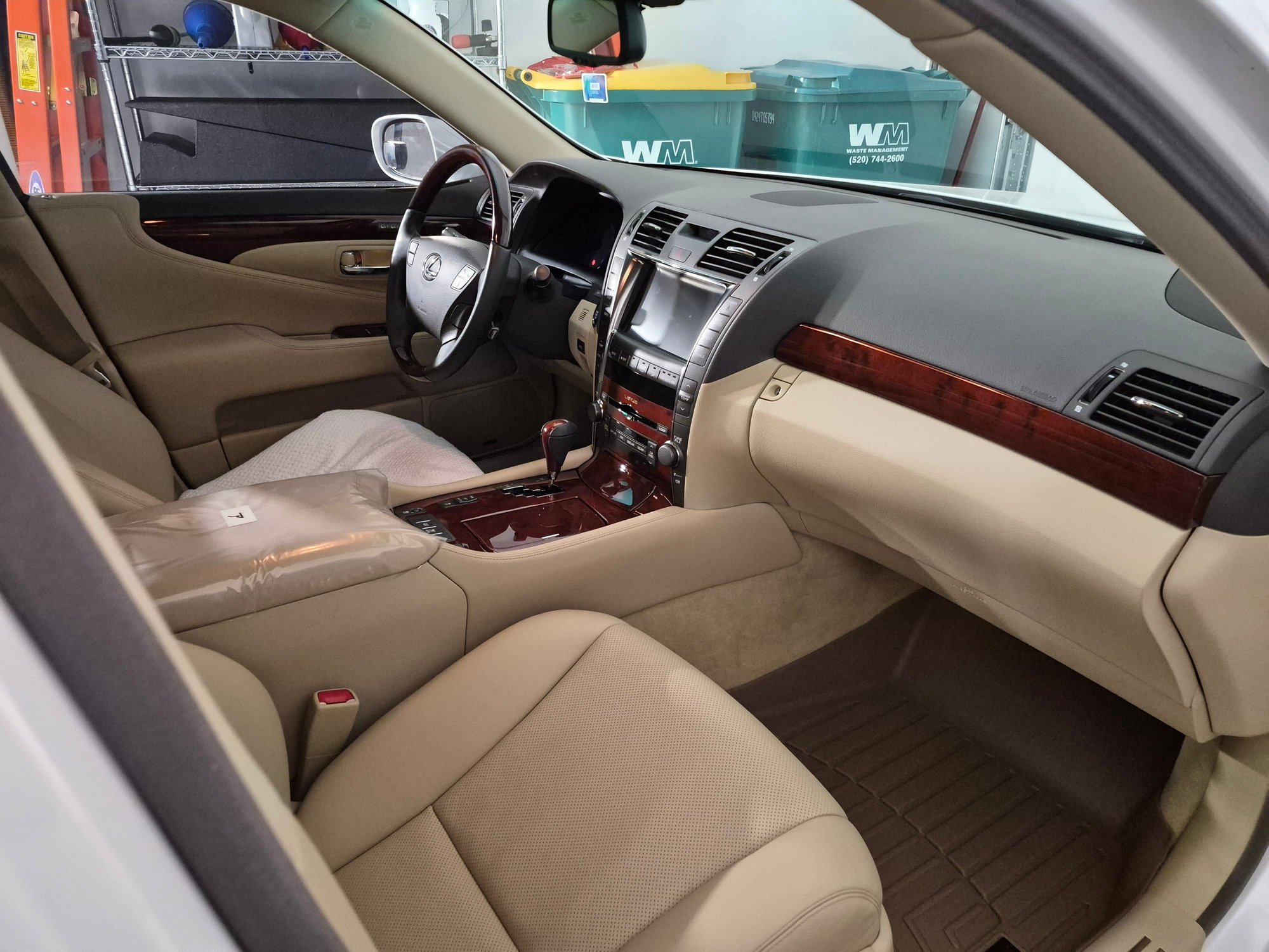

Current project: replacing the sticky interior panels. I purchased the car in the evening after dusk. Although I was aware that this issue affected many Toyota/Lexus products from this era, I had no idea this car suffered from it until I parked it in the sun on my second or third day of ownership. I contemplated returning it under AutoNation's 250-mile, 5-day return policy, but since the car is so clean otherwise, I decided to keep it.
I'm currently waiting for the glove compartment and center console to arrive. Although not photographed, I already have the driver knee bolster. I'm happy to report that I didn't break any clips or connectors during the disassembly. It's actually a pretty simple job.

The new dash, driver knee bolster, glove compartment, and center console are installed. The reassembly went smoothly. I'll take more photographs soon.

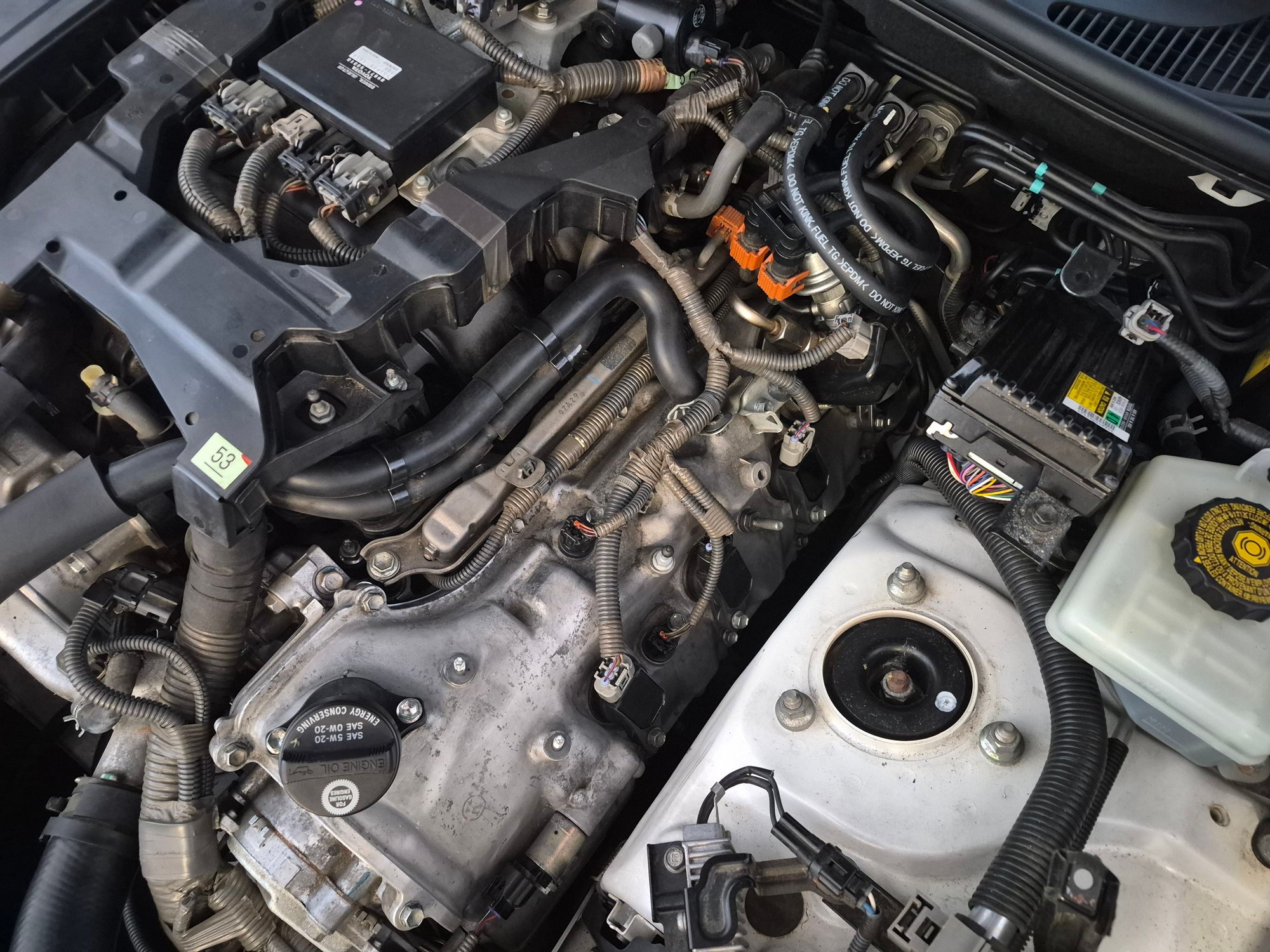

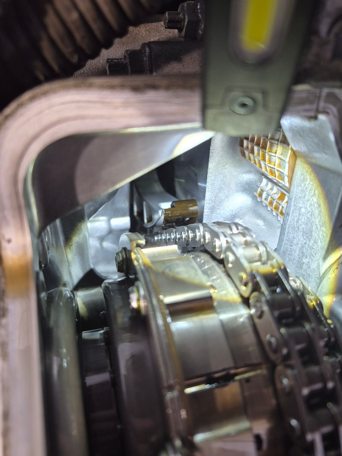

Current project: replacing the spark plugs, spark plug tube gaskets, and driver side valve cover gasket (it was seeping along the bottom edge). I would have completed the job in one day, but I ordered the wrong gasket. Given the unintended delay, I decided to also order and replace the PCV ventilation hoses---they've been subjected to 20 years of heat cycles and have seen better days.
This car has zero maintenance history on CARFAX or BADVIN. I can only assume the prior owner performed his own maintenance or took the vehicle to a local shop that doesn't report service information. Regardless, the vehicle has unquestionably been well-maintained, as evidenced by the valvetrain.

Car is finally back together as of last weekend. While I had uninhibited access to them, I replaced the ventilation hoses. I also cleaned the throttle body and MAF sensors. Car runs great.

Few interior photographs.
