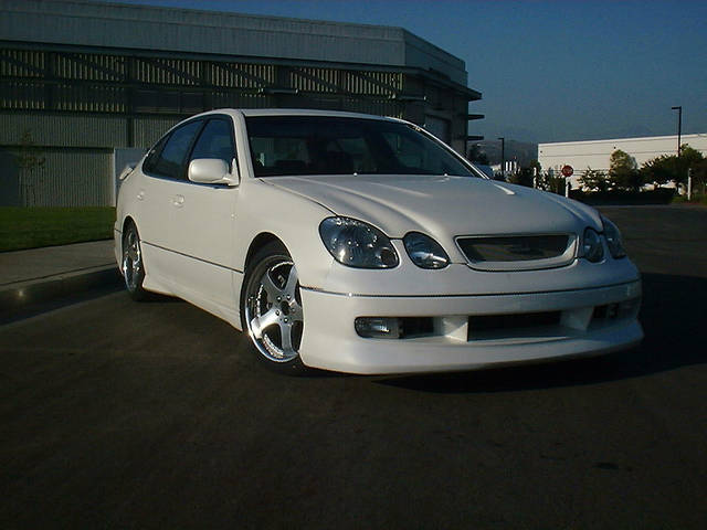

I wonder why it was impossible back then? It wasn't such a big deal to me when I got my first set of wheels 5 years ago with the same size and offsets posted above.
And I haven't even discovered CL yet
Traffic Star DTS
18x8.5 +31
18x9.5 +31

coz' it's still impossible now, at least to me. i don't know about others, there could be some specific tire or camber setup, but one thing for sure is my 20x8.5 +32 rubbed bad in the front. my 20x10.5 +41 rubbed in the back without shaving fenders.
i agree nothing is impossible, but one has to be specific about what exactly has to be done to get it fit. fenders, to what degree, tires, what brand, size, camber, what settings. i am sure if one is crazy enough they can get anything to fit. but one shouldn't just go on and say "no problem this will fit" without putting in specifics, that's misleading at best and for any "newbie" who is looking for advice could get into very expensive "mistake" later on
that's just me, but one thing i know for sure is what i say "will work" will work for everyone for sure, and anything beyond (including myself) i have seen more than few cases of trouble.
in fact, to avoid anymore confusion, i don't really want to get more pms from people asking me "why you said this and this doesn't fit but some other people say they will", it's probably best for me not to suggest setups for people anymore. bottom line is, you can get anything to fit
