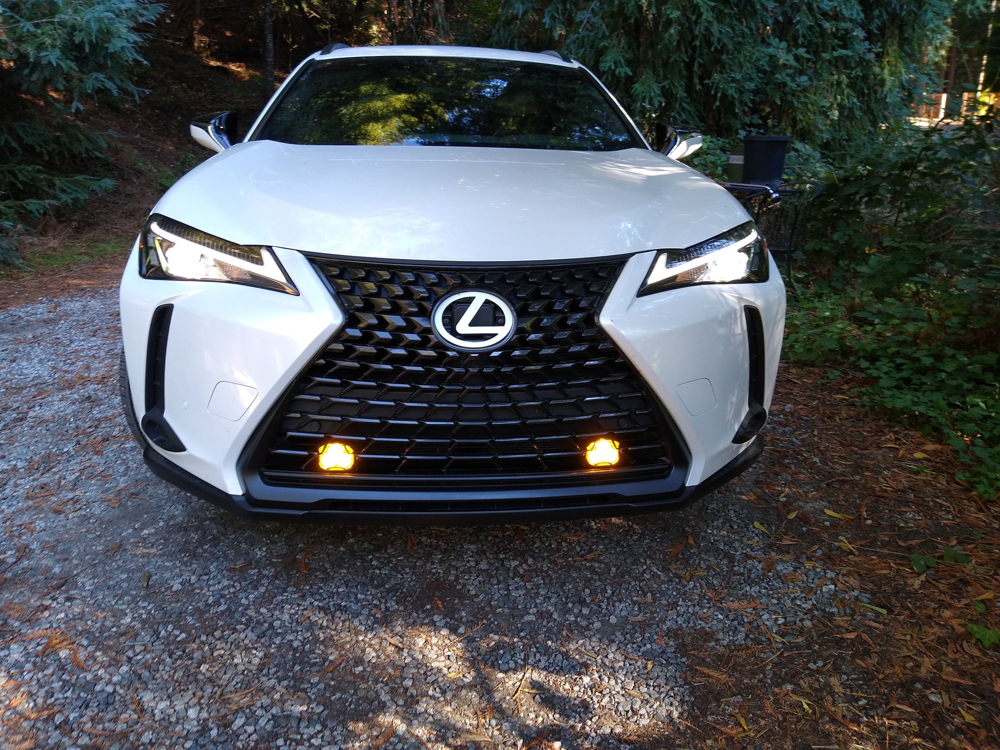

Been a while, but I got another unique mod to add to the my list. Custom Morimoto fog lights mounted and working. To make a long story short, I've been searching the interwebs for a fog light kit for the UX250h for the better part of a year, without any luck. The only fog lights I could find was the Lexus factory set, ones I have never been impressed with. I finally decided on the Morimoto 4 Banger NCS wide yellow universal pods. With some custom fabrication, these could be custom mounted. NOTE: If you want the bracket included in the image below, make sure you select them in the dropdown menu before ordering the pods.
I originally wanted the fog lights mounted in the Lexus factory location, but once the fog lights delivered, the pods were slightly too large to fit into the Lexus factory location without major amounts of redneck engineering.
Seeing as to how much I would need to fabricate the mounts and fitting, I enlisted my friends at Extreme Soundz and Lightz, in San Jose, to help with the project. They have done several lighting projects on my Prius, in the past(HID low beam, LED fog lights and high beams).
The Lexus plastic grill, with the plastic mounting clips does not provide enough support for a solid mount. The guys at Extreme Soundz and Lightz fabricated a pair of custom mounting brackets, extending from the radiator mounts. A wee bit of rotary tool work, on the Lexus plastic grill, and VIOLA, a one of a kind fog light kit on my UX250h.
The fog lights are wired to turn on with the low beams, so I didn't lose the functionality of the Lexus automatic lights. Pretty much set and forget.

You know at first, I wasn't to keen on the lights, when you showed them prior to install. The after, actually doesn't look too bad, they did a great job installing it into the grill. Hopefully (I would assume) aimed correctly.
Could you do a night or low light shot from the rear quarter panel to see the beam/spread pattern of the fogs?

I finally got the chance to give the new fog lights a real test last night. They are definitely noticeable with the yellow tint. They do a great job filling in any and all dark spots from the factory Lexus bi-LED's. Much easier to see any fallen rocks, tree branches, etc on the mountain roads around here. As an added bonus, no oncoming traffic flashed me. So I have to assume the fog lights aren't too bright or the aim is correct. Of course, it could also be the lack of traffic around here. I may have seen 5-6 other vehicles in 30+ miles of driving.
