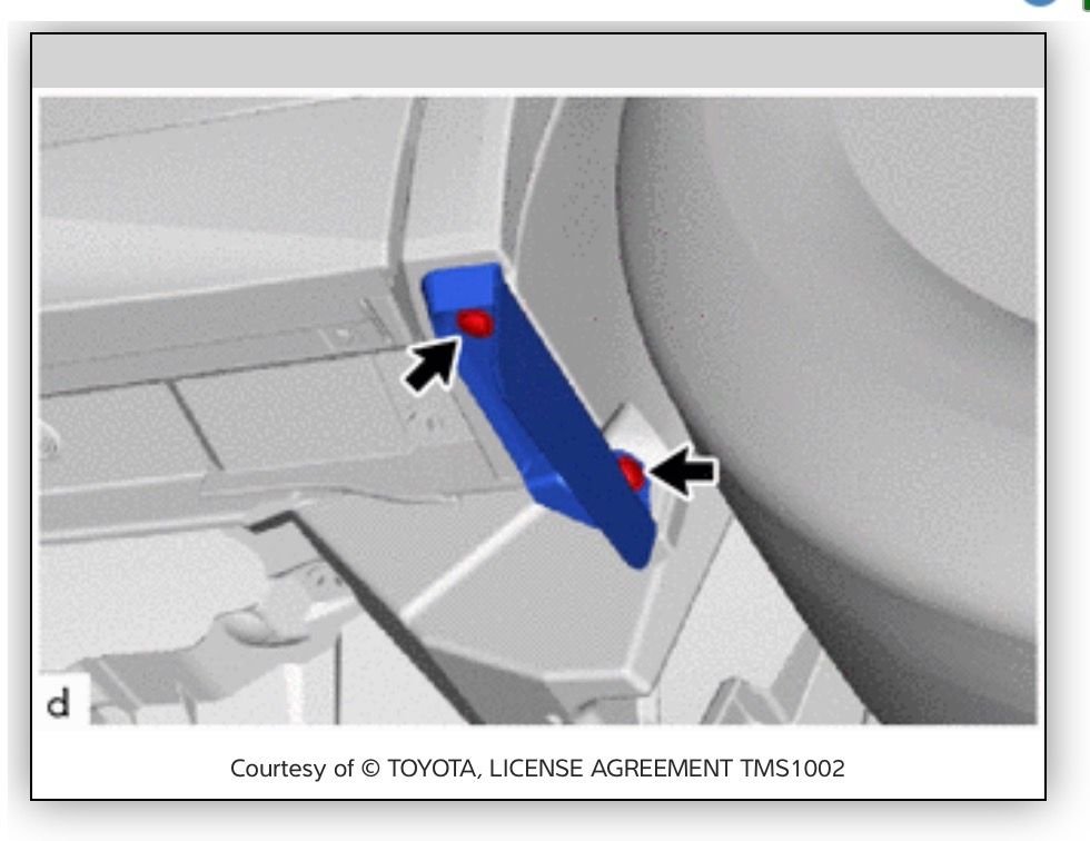

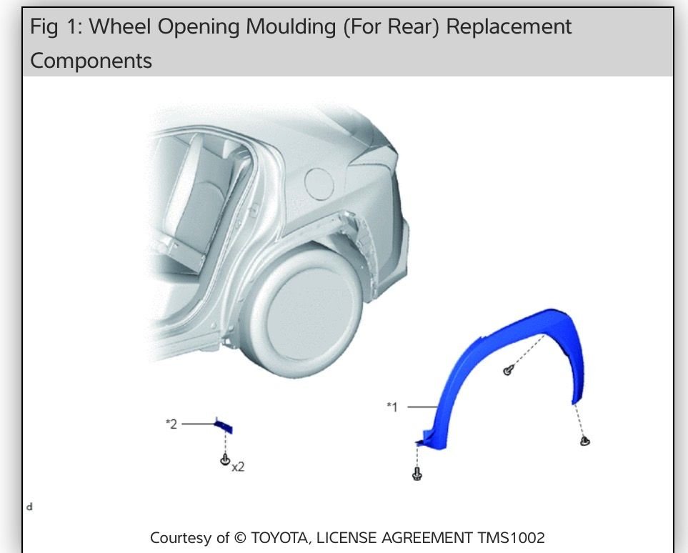

First time I post.
Don`t pull the arches you need to remove the two covers under the car on muffler sides.
Put you r arm inside and press the clips to remove the clips from the bumper.
After that the clips on the body I think they can be remove with a pull but it's better to use a tool.
The bumper clips are ridiculously (RIDICULOUSLY) fragile
Hope that helps
Sorry for the English
See broken clips
See broken clips
New fender arch
New fender arch
