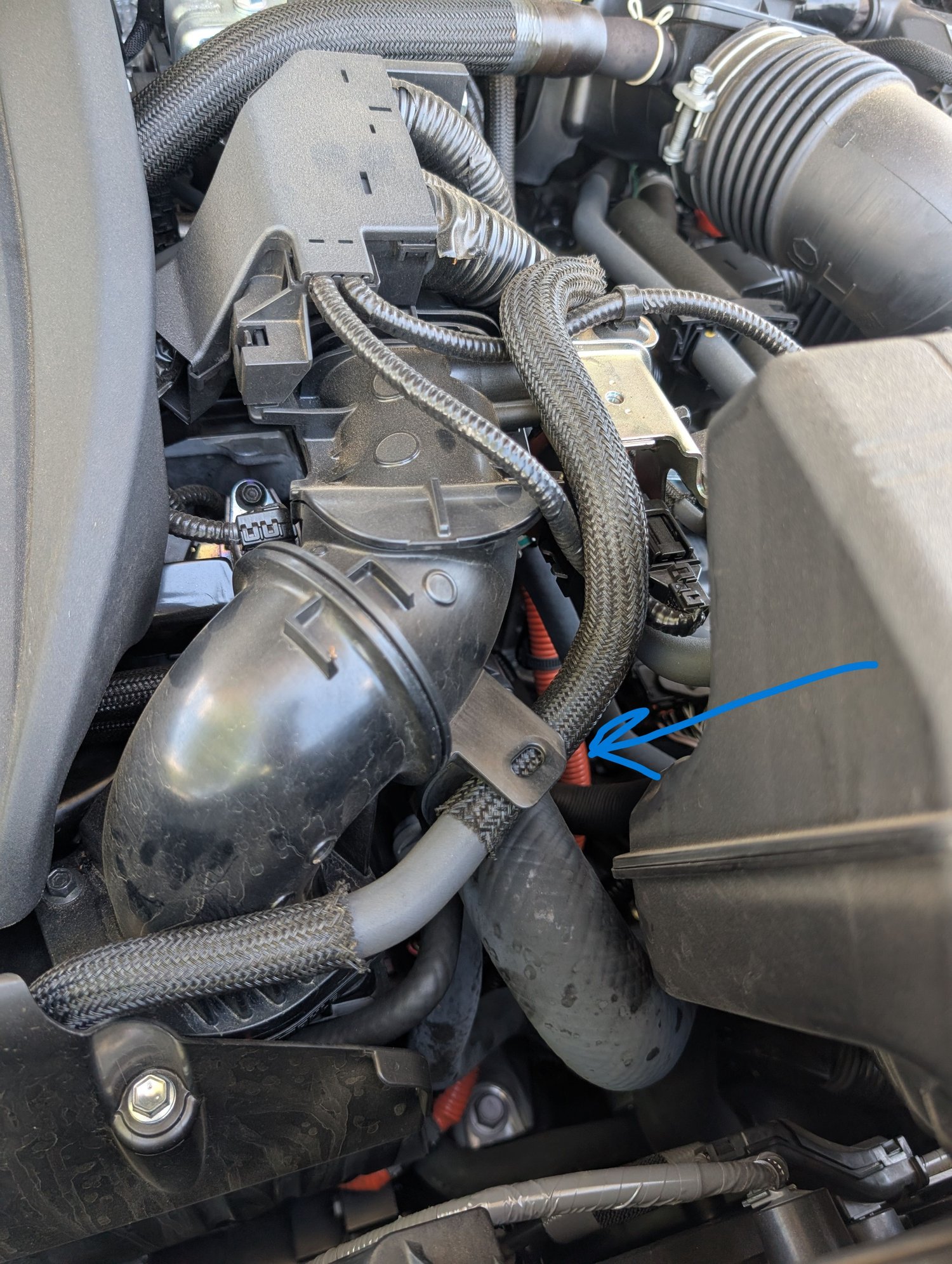

Around 10k miles now getting intermittent noises and vibration around 4th gear and under load. Think it's in the front suspension because I can also get a variation of the noise at low speed when the car shifts its weight to the rear, that is also up front and to the right. Anyone having issues like this? I've been concerned about the pano roof seal popping up, and long-term reliability...now kinda pissed the car's suspension is suspect too!
BTW, I initially checked under the hood, looking for anything loose, and found the fuse box cover unlatched, and also this hose with what appears to be a missing clamp.

Oh, and the picture of the missing clamp? This is normal as the unused bracket if for other models to use.
