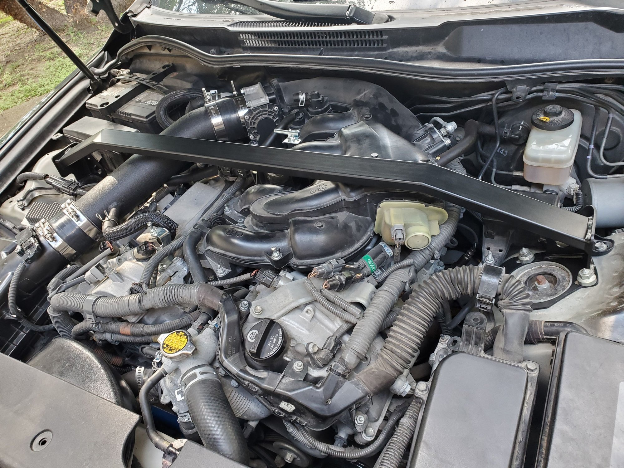

I finally got this in the mail today not bad. Since I had ordered on the 20th of May. Please excuse the engine bay. I have never sprayed it down to wash. At least since I've owned the car.
The quality is great. Seems to weigh about 5 lbs maybe.
The mounting bracket rings are pliable compared to the OEM. I had to test fit it a couple of times, and bolt so it could mold to the body. The driver side diagnostic box is slightly rubbing on the bar. You'll have to loosen the box bracket, and bend them to fit around the bar. Passenger side fuse box as well near the battery.
Before I slammed the hood down to check for interference. It closes normal for me. I shut it, and closed it to check if it was making a mark on the hood dampner. There is visible outlines on driver side and passenger. The driver being the deepest. Passenger side is there but less visible.

Yeah I was just holding out for a one piece design. I'm glad I waited as I was about to pull the trigger on a Tom's.
I like this one because of it being black vs white from UR. As for effectiveness I can feel it on the tun in. It definitely helps a little.

btw, your strut bar actually looks really nice when I actually take a closer look at the pictures. Looks rather functional. Very nice.
