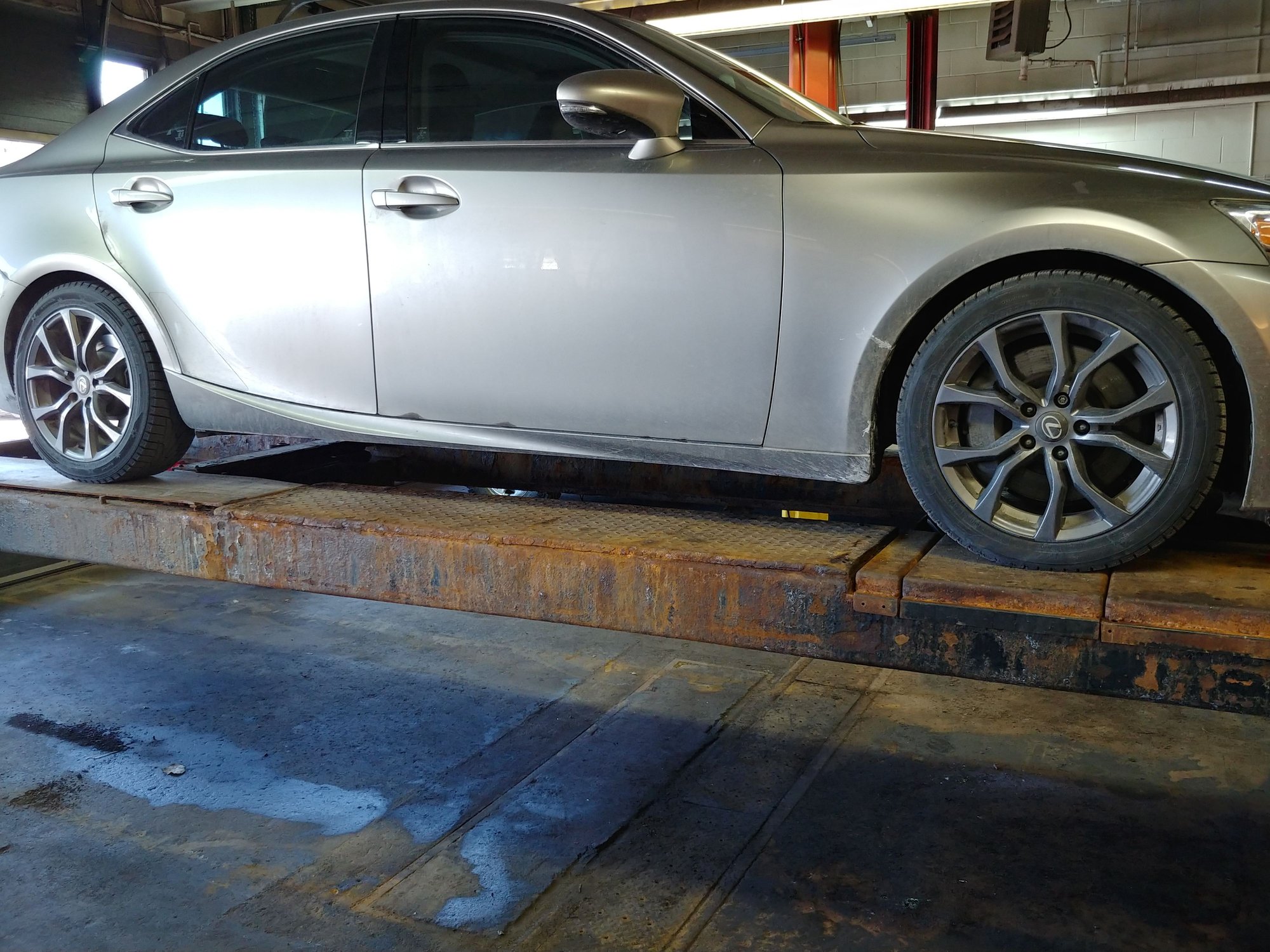

I could have sworn I had before pictures, turns out I don't do I either never took them or deleted them. This is the best picture of my car I can find that shows the front vs rear fender gap.
Old Mar 23, 2019 | 04:05 PM
  #59
AtomicAWD's Avatar
AtomicAWD
Joined: Dec 2018
Posts: 774
Likes: 97
From: BC
Excellent, thanks! The drop looks perfectly balanced on yours, congrats.
