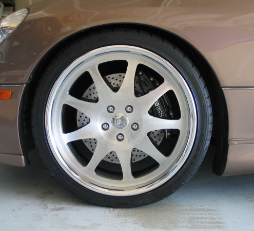

You don't need to go full 4 corners unless you REALLY want to and have the $. Most front BBKs are tuned to provide more linear braking while biased so that they still work with OEM rears. You can certainly dress up the rears with SS line, matching styled rotors, and color matched calipers.
Some old pics:
Front
Rear
The other benefit of most BBKs are the 2-pc rotors. There is weight savings that will contribute to power (somewhat) and handling. I know that after my Stoptechs were installed, the car felt much more nimble.
