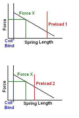

See attached diagram for a graphic on what happens with preload. Notice with a Force X the spring's length is identical regardless of preload. This is the situation on the car, the only difference you'll see is the ride height of the car with more preload will be higher because you've increased the distance from the bottom of the spring to the bottom shock mount by moving the collar higher on the shock body. In either case the spring is the exact same length. Nothing else changes.
So, I realize you think the ride height changes because you're shortening the allowed space for the spring between the shock body and the upper mount, but that's not what is really happening. You're increasing the distance between the lower collar and the bottom of the shock. The spring's height isn't going to change one bit because you're not changing the load on the corner. If it is possible to compress the spring more by increasing preload (shock travel is gone before coil reaches coil bind), then you'll move higher on the sloped line at maximum shock travel (minimum shock length) and there will be more maximum force which is the effect you're referring to, but again, this is a ride height adjustment, not a ride quality adjustment since the spring's rate is unchanged, AND you can only add preload to increase this until you hit coil bind.
It didn't make sense to me when I first heard it, but it's reality and it's the way you need to consider this if you expect to tune suspension for performance.
