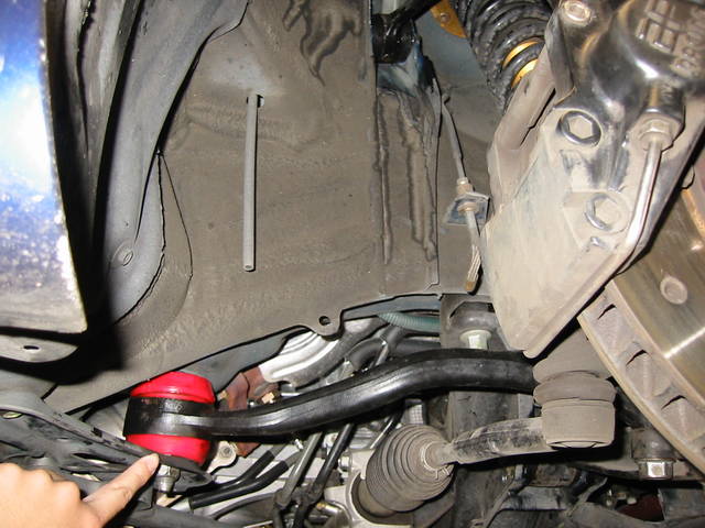

Just did the daizen urethane front control arm kit for my '03 GS430. But I had a question about the Metal Housing that goes inside the new Bushing for the Caster Arm(Control Arm), the Big Bushing. The inside of the Metal Housing has two different ends, one end is more narrow than the other end. Wondering which is the proper way it goes in? The Narrow end pointing down or up?

Here is a pic I found, not sure why the bushing is red?? But this the bushing I'm referring to, the Metal Housing that goes inside it. This housing from Daizen has two different ends, which side points up?

It's red because they were pre-production.

If your talking about the metal sleeve that goes inside the bushing and the bolt goes thru, I believe it only goes on one way. the other way wont fit properly. It has a counter bore on one side and that end goes towards the top.

When you're saying Counter Bore, if that's the end where the inside is wider than that's the way I did it.
I was hoping I did it wrong b/c I still hear some noise from the front end and only have a few of the benefits mentioned. I did do an alignment too. The noise I hear now isn't metal on metal anymore though, oh well, I'll live with it. Also my highway vibration is the same or worse. So far not happy with the results: bruised arms, greased finger tips, cut up hand and all I have to show for it is a little better handling.
BTW my car is completely stock, except for the Daizen Control Arm Bushing and Steering Rack Bushing.
