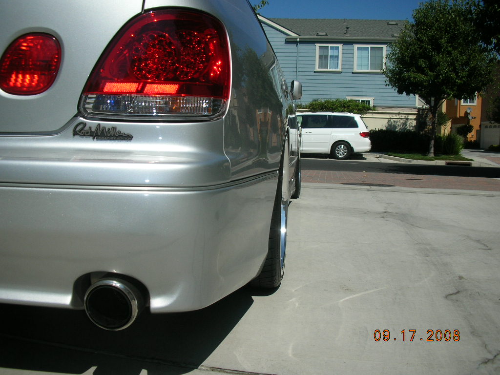

I just installed the rear camber kit in which I'm using Tein CS V2 coilovers that were already adjusted for maximum drop.
Installing the camber kit allowed me to drop the car an extra 3/8 inch. The rear tire on 20's is now tucked by about 3/4 inch.
I actually had the coilover raised about 3/8 inch to compensate for the drop from the camber kit. So that means the camber kit allows a maximum 3/4 inch drop if you don't re-adjust your coilovers back up.
I just aligned the car yesterday and am easily within factory spec.
Camber = -1.3 left & right
TOTAL Toe = 0.00
VERY VERY IMPORTANT NOTE: You should have your car aligned immediately after installation of this kit. Driving without aligning can result in severe tire wear and handling issues.
Now that my alignment is done, I'm totally within spec, the handling is great, I have more drop using Tein CS, My Wheel edge is flush (not hellaflush) with the fender and ZERO rubbing (with shaved inner lip, no fender pull or other fender mods)
Tucked 3/4 inch
Camber and Toe In Spec (No Adjustable Toe arms required)

Even without Glen's specs, you can visually see zero camber on Glen's car, I've seen Glen's before and after as well as compare to my -4 degrees camber when we both got the alignment done together. For those that worrys about camber wear and goes through tires left and right, this prduct is for you but REMEMBER TO GET YOUR ALIGNMENT DON'T RIGHT AFTER. this is adjustable, you can adjust positive or negative camber, Exact can chime in with the details. Time to update my rear's bracket John.
