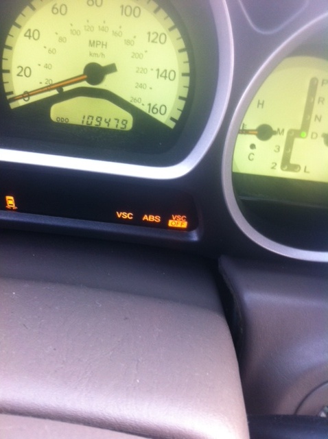

Default VSC, ABS, VSC off lights...
So after throwing on my Moog ball joints i got this...any ideas as to why?
Attached Thumbnails DIY Lower Ball Joints for the 2nd Gen GS. - Step by Step Instructions and Pictures-photo.jpg

you probably did something to the abs sensor when installing the ball joints
Yeah I tried to put the calipers on some blocks so that they wouldn't hang from the brake line but they did slip at one point. Any way to fix this?
