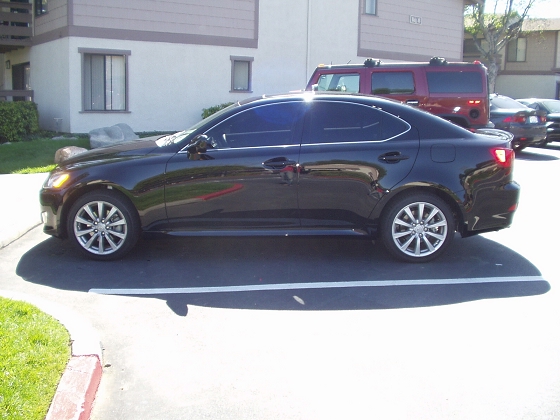

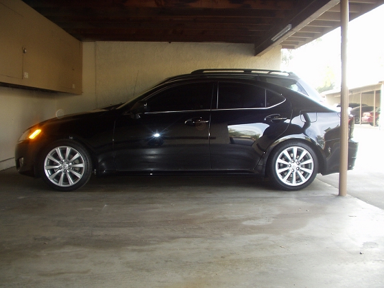

Originally Posted by kcw884
Do you have a picture of your car after (and before) the drop?
Sorry for the bad pics...Also, the fender gap looks pretty even, even tho the fronts are a 3 finger gap and the rear is a 1 finger gap.
Before
After
Before
After

Originally Posted by Phillip31
The first time I looked at this pic I thought I was looking at the first IS250 SportCross!!! Car looks great, by the way...
Javier
