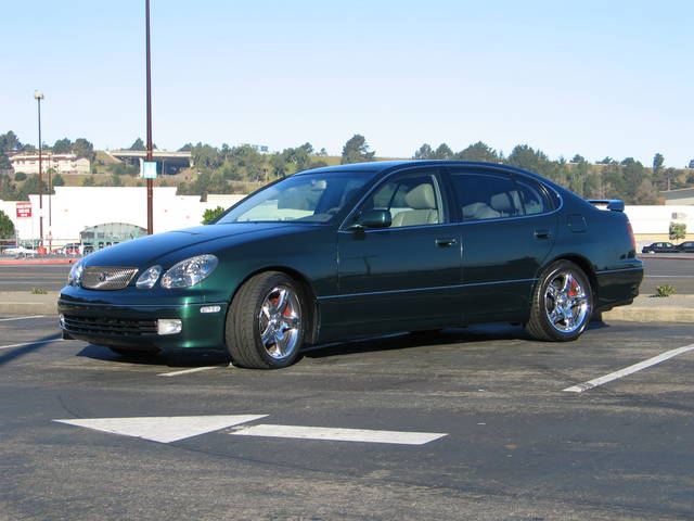

I also used to have this set up. I was very happy with this set set up and also agree with your write up. It did seem to drop the car more than the inch.
Here is a pic when I had them on the car.
If I did not get such a good deal on the Tein coilovers, I would probably still have this set up.
