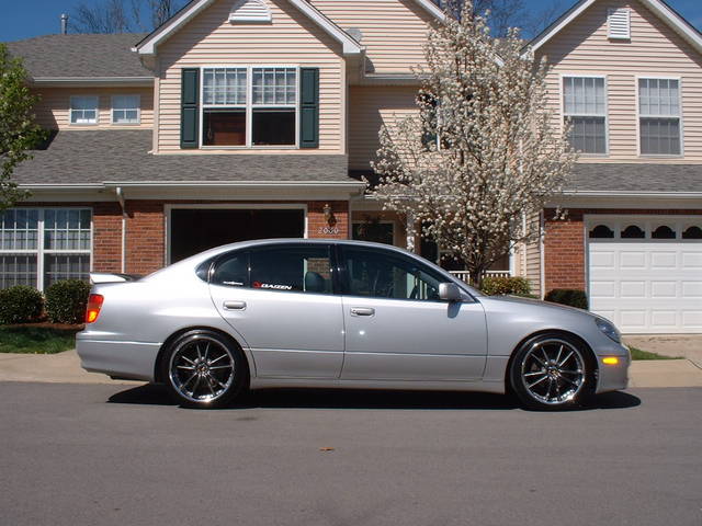

I used to have the Daizen springs (1.9, 1.7), L-Tuned shocks, and staggered 19"(38F, 45R). I had no rubbing...........
