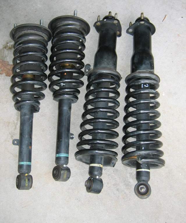

First some info others might find useful. I *weighed* the Tein Flex in the box before I put them on. 61lbs.
Today I weighed the L-Tuned springs/shocks in the same box after I got the car back. 81lbs.

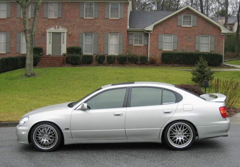

Here's how the car looks right after the install:
I like the look!
I haven't played with the EDFC yet - it's at 8/8 (middle setting). The ride was great, not harsh, although slightly more 'feedback noise' on hitting an abrupt road transition. Not a problem though. I didn't push it on the way home, I was just listening for creaks, squeaks, clicks, bumps, rubs(!), etc., but none of those occured.

I just took the car for a spin to get take-out for dinner, and I played with the damper settings on the EDFC. I programmed all 3 presents, 12/12, 8/8, and 0/0. I drove the car in all settings and could definitely detect the difference.
In 8/8 I'd say it's a little bit stiffer than the L-Tuned shocks and has less body roll. At 12/12 it's more comfortable still, but still very capable. At 0/0 it's definitely stiffer and you feel every road imperfection. So right now I'm ecstatic that it all works, and works easily. I love having a range of suspension settings at the push of buttons inside the car. Having 3 preset buttons is nice, basically comfy, average, and as hard as possible.
And my car is sitting lower than I expected it would right now, and so far, I like it!!!

This suspense is killing me, however write-ups like this alleviate the suspense for me somewhat! The drop on your car is just perfect now (at least from the high angle you took the pic ! ). Take another pic with the camera at the same height as the top of wheels and post that up please. I can't wait to see what it's like. What did you tell your mechanic to set the height to?
Thanks also for letting us know the weight difference between the L-tuned and the Tein Flex!
Please measure the height of the gap between the fender and the top of the tires front and back and let us know what it is. Others on here like TTurbopimp, Rominl have theirs at 1 finger gap all around. Right now my L-tuned drop has the front at 2 fingers (which bugs the hell out of me) and the back at a perfect 1 finger gap. I can't wait to fix this in April. Needless to say, I can't wait to feel how much better it handles!!!!
One last question - have you had the car aligned since the install? Any problems with getting it to align properly?
Well, you can fix this with the Flex. BUT, be prepared to scrape the front (lip and front of sideskirt) a little more.
So far I have not scraped either - knock on wood! So hopefully this will not be an issue in the future coming down 1 finger height in the front.
