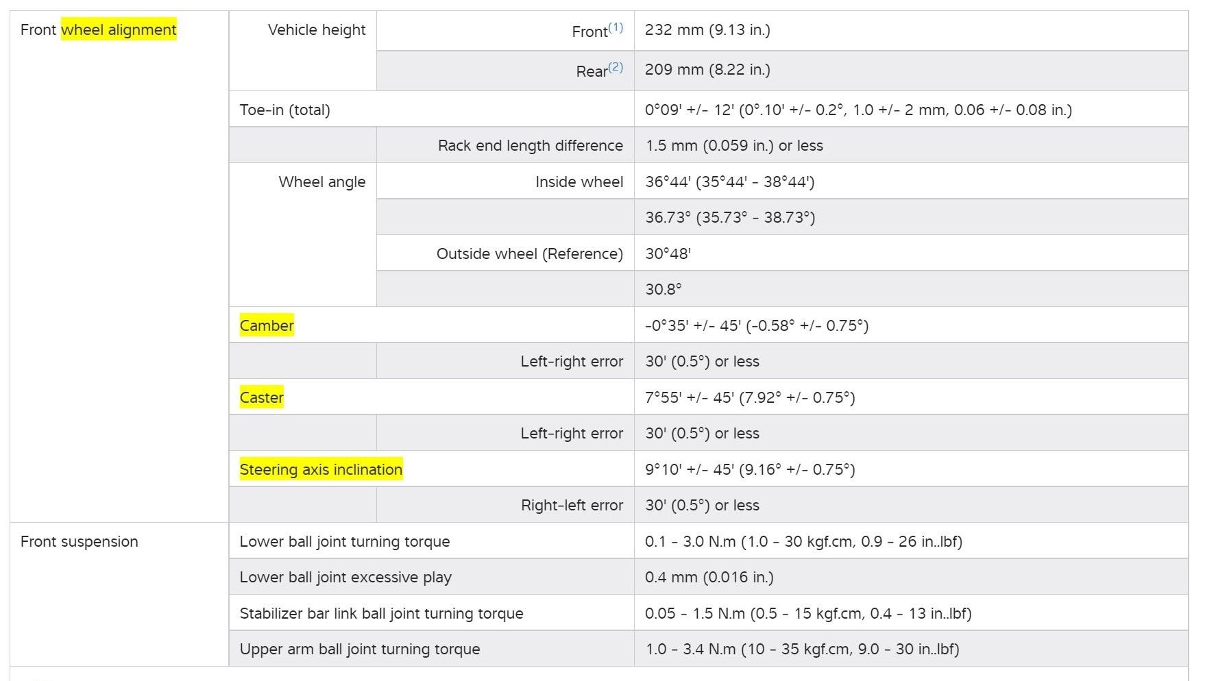

I'm going to start installing coil overs at mechanic school in a couple days. The school has an alignment rack. I already used the search function and couldn't find an answer to my question.
When lowering the car about 1 inch, aside from the coil overs, can the stock suspension accommodate this and achieve correct alignment? I want the tires to contact the ground properly, not be tilting in at the top and riding on the inside edges.
I read this very informative guide by @Seattle SCone and he installed new, but not adjustable, control arms. For others who've already been down this road, I'm wondering whether or not I need to order a pair of these MEVOTECH Supreme control arms that offer +/- 2.0 Degree Camber; +/- 1.0 Degree Of Caster
Here are the specs for the stock suspension:
Front: from the ground to the center of the lower suspension arm mounting bolt = 232mm (9.13in)
Rear: from the ground to the center of the lower suspension arm No. 2 mounting bolt = 209mm (8.22in)
Camber -0°35'* +/- 45' (-0.58° +/- 0.75°); Left-right error 30' (0.5°) or less
See the screenshot below if I left something important out:
