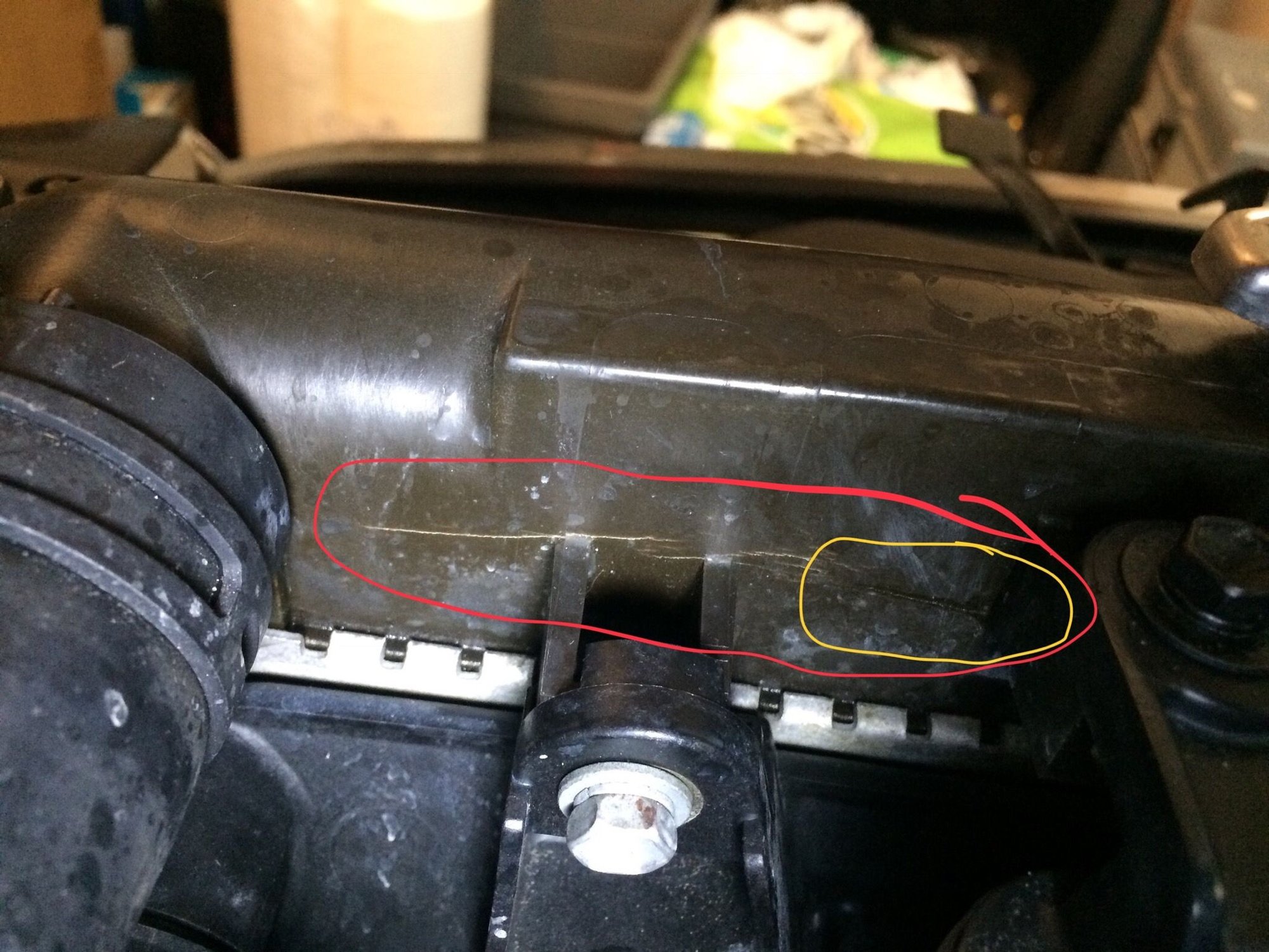

please tell her not to drive it until it’s been repaired. It could fail at any moment…if the engine overheats, it’s all over.
if she lives near Cocoa Beach, I could take a look at it or have her send you pics of the upper tank and look for the notorious “pink stuff”
here is a thread with pics, scroll way down and you will see pics showing a leak.

The SC Radiator is not the best. As BGW said, the tanks crack pretty readily. First a crack and then the whole thing blows. Replacing the radiator is not that big of a deal. You can buy a replacement on Amazon and have it sent to her. She will of course need coolant. If she has a friend who is mechanically inclined they can do it in the parking lot. (I did mine in the parking lot at work)
