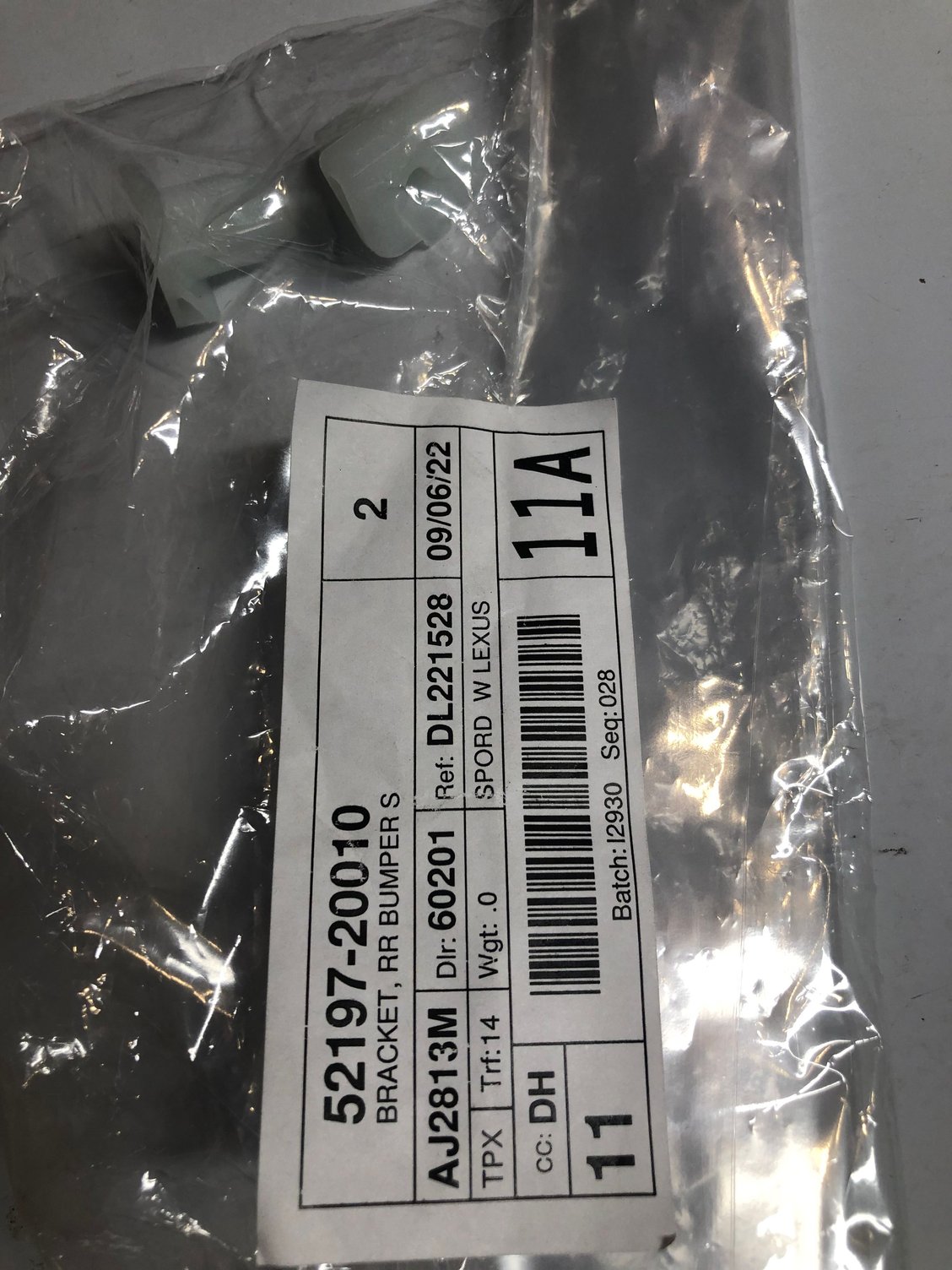

Originally Posted by Raven01750
That's a good representation. It shows the "tabs" that are part of the actual bumper cover and the replaceable plastic "clip" screwed into the body that those tabs pop into holding everything in place and properly aligned. If you have pulled your bumper cover for anything, you get where I am coming from.😁 I just pulled my sons last weekend to replace a front lamp. PITA. But easier than trying to wiggle your hand in there to change a bulb. 😏
Paul
that is really good.

Originally Posted by PWRSLVE
Not sure if it helps but when I purchased my car the rear bumper was a little loose on each side and these were the clips I replaced on each end where it attached to the body. I used the existing screws but the original clips where shot.
So do you need screws and clips?

If the original clip is gone, then you will need the screw and washer also, looks like 90159-60431 in the diagram above. Without seeing the actual area below the tape it’s hard to know for sure but if the tabs are intact, essentially the white clip goes through the bumper and body tabs and the screw spreads the clip to hold them together. This is at the wheel well end. Not sure what’s downstream of that but the fact that your body shop said it was a quick fix makes me think this is the clip he was talking about. As I recall, the clip was relatively cheap.

Ill buy the screws as well. Thank you very much!

Just incase anyone has the same issue.
Not to beat a dead horse but the correct part to fix the rear QP were clips part number is 52161-02020. It took the body shop 30 seconds to install.

Ahhhhhhhhh... The bottom bumper button inserts. Not really close to the taped seem

Yes the body guy when under the rear inner fender well(peeled it back) and stuck the clip in. I think it needs a second one though. I am going to attempt this weekend.
