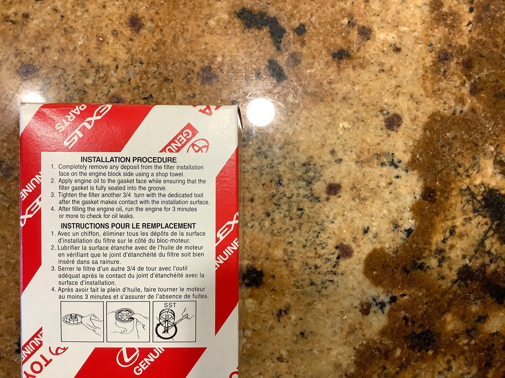

Its not really a torque specification…it’s how you tighten it.
Here is a picture of the back of the Toyota oil filter

Last time I tried to use hand to turn it 3/4 of turn as shown in picture but I remember I wasn't able to turn it 3/4 turn. It was soooo hard. I just made sure it was tight enough. That's why I thought I use torque this time. I can use oil filter cap that has a place for socket wrench and that way I can easily turn it 3/4 turn.

I’ve used the 3/4 turn after contact and have never had a leak or hard removal when replaced for an oil change. Really a “rule of thumb” for all canister oil filters.
