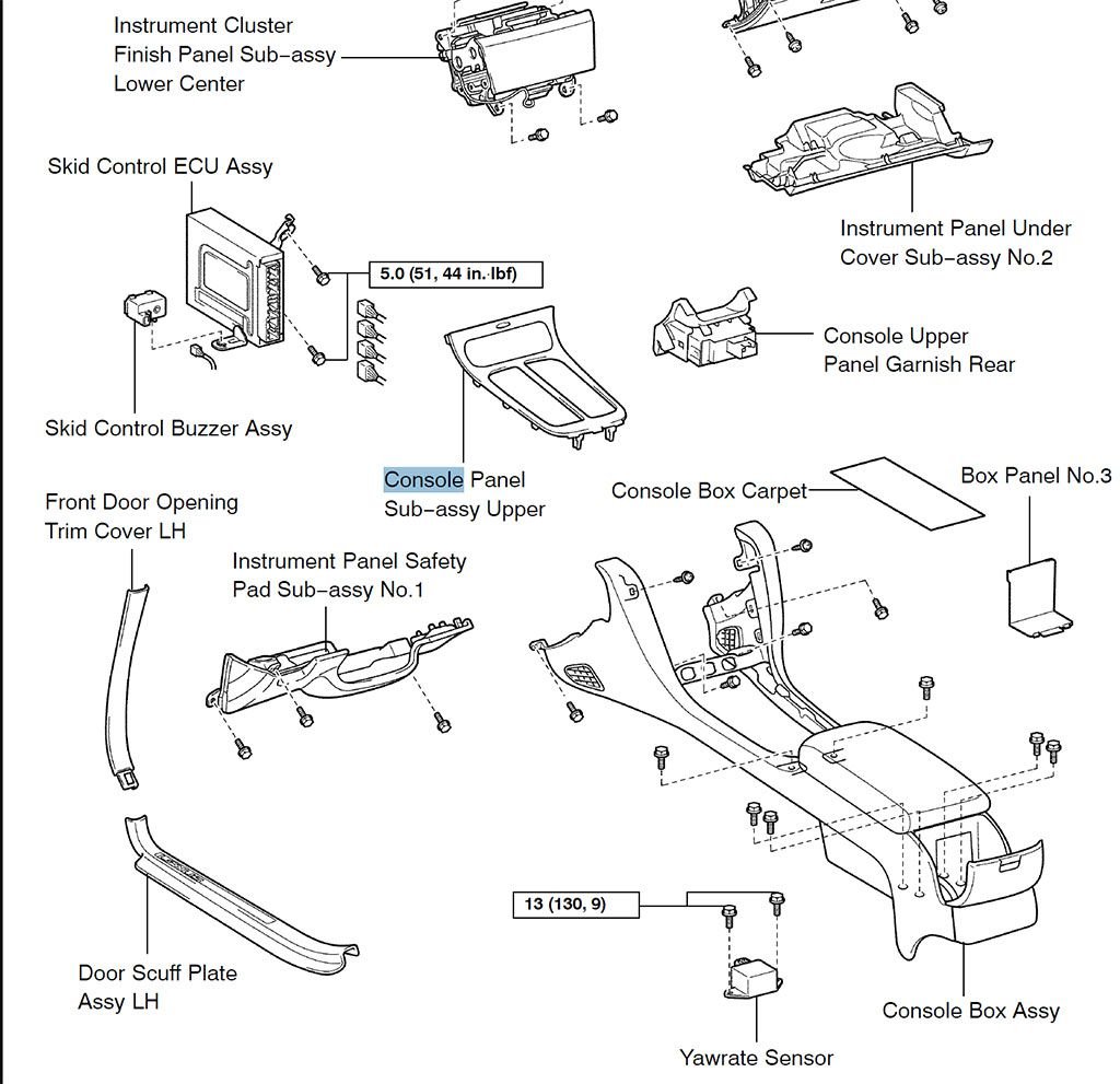

I just scored a cheap silver SC with black interior in hopes of fully swapping the interior over to my ecru-lined twilight amethyst pearl. I've tried searching here and FB groups, but am unable to find anyone who has swapped carpets. I can easily pull seats, door cards, and wood trim, but am wondering if anyone has instructions or a guide to removing the center console and carpets. Looking at the center console, I can't tell if the dash needs to be removed (hoping not). Any advice or help would be appreciated.

based on the image, I bet this video will show you how to take the top cover off the transmission tunnel, so you can see what is needed to remove it.

The video posted above and a pic posted below (out of the FSM for 2002) should give you and idea of what would have to come out. Looks like both sides of the dash under panels, the radio and the climate control panel all have to come out for the bolts/screws up front. The pic addresses the Yaw Rate sensor. Not germane to you, but couldn't find anything on carpet. Hope this helps.

Thanks Lee! That picture will definitely come in handy. I didn't pay close enough attention to the center console when I replaced my navigation screen, but from looking at that picture it doesn't seem like I'll need to mess with the dash.
I'll try to get my hands on the FSM to see if they cover carpet removal.

I can tell you the 2002 FSM does not cover removal of carpet. Having done this job in a LX470, once the front seats and console are out it's a matter of finding which things cover an edge have to come out too (rear seat bottom, etc.).
