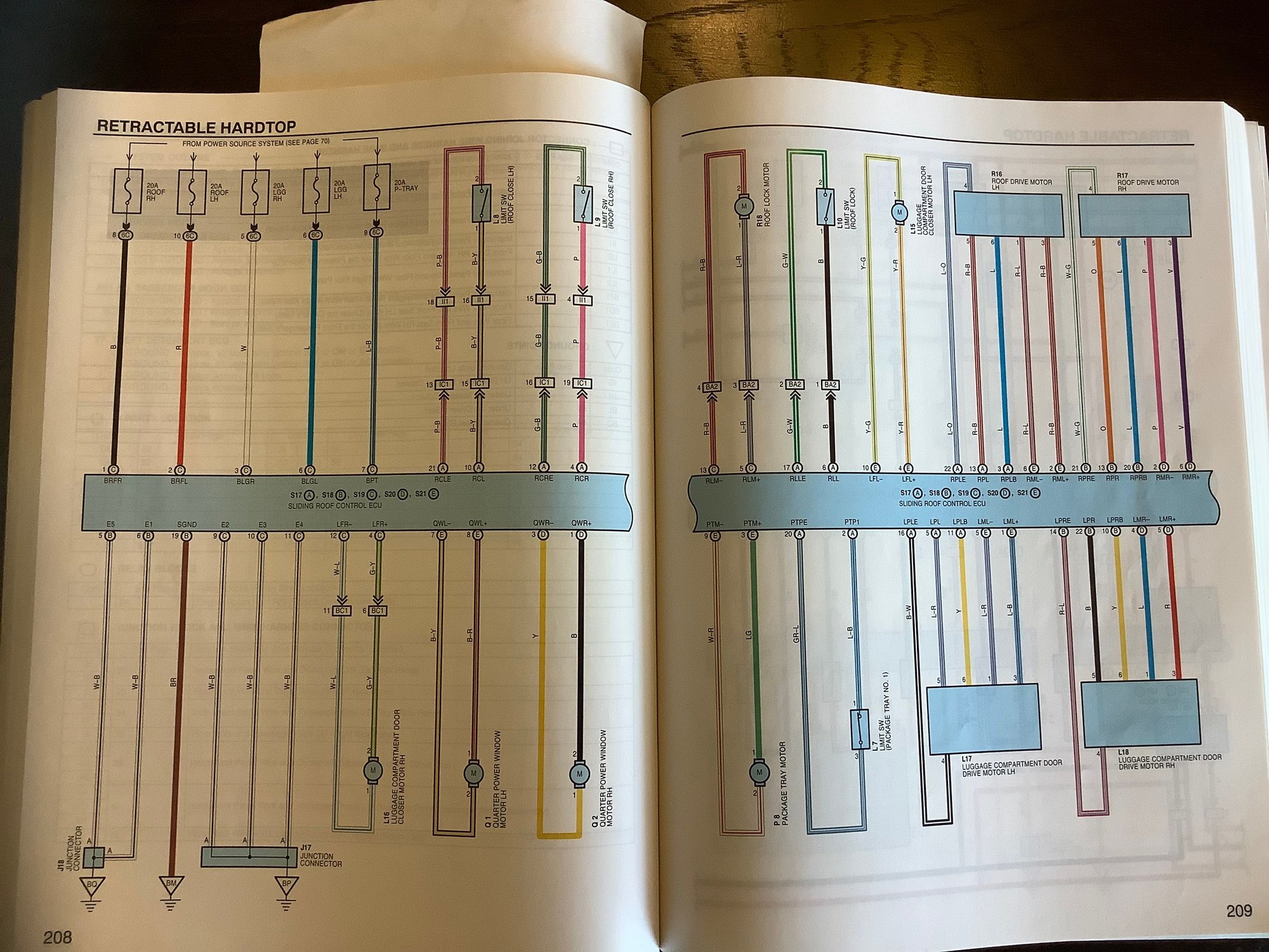

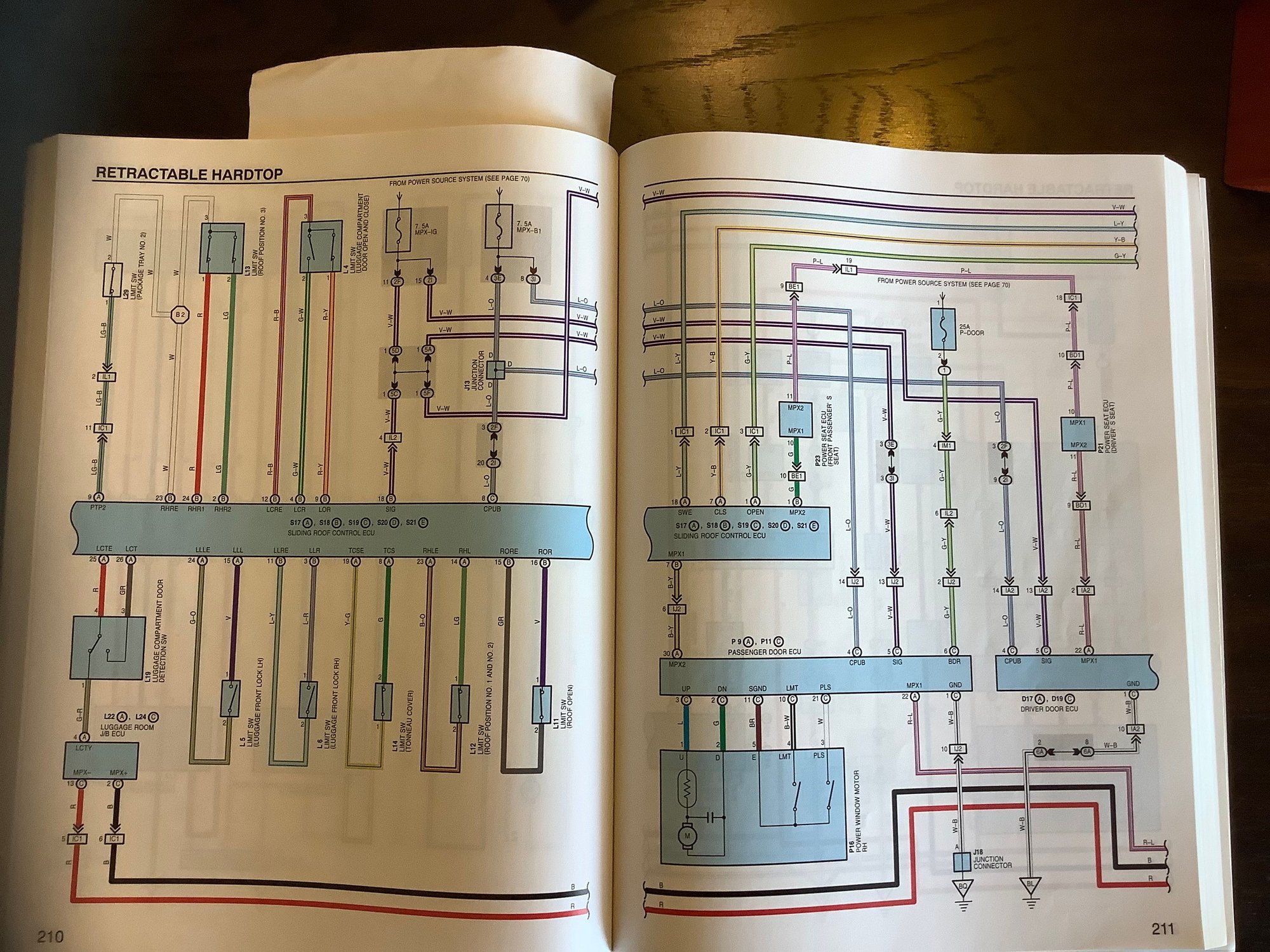

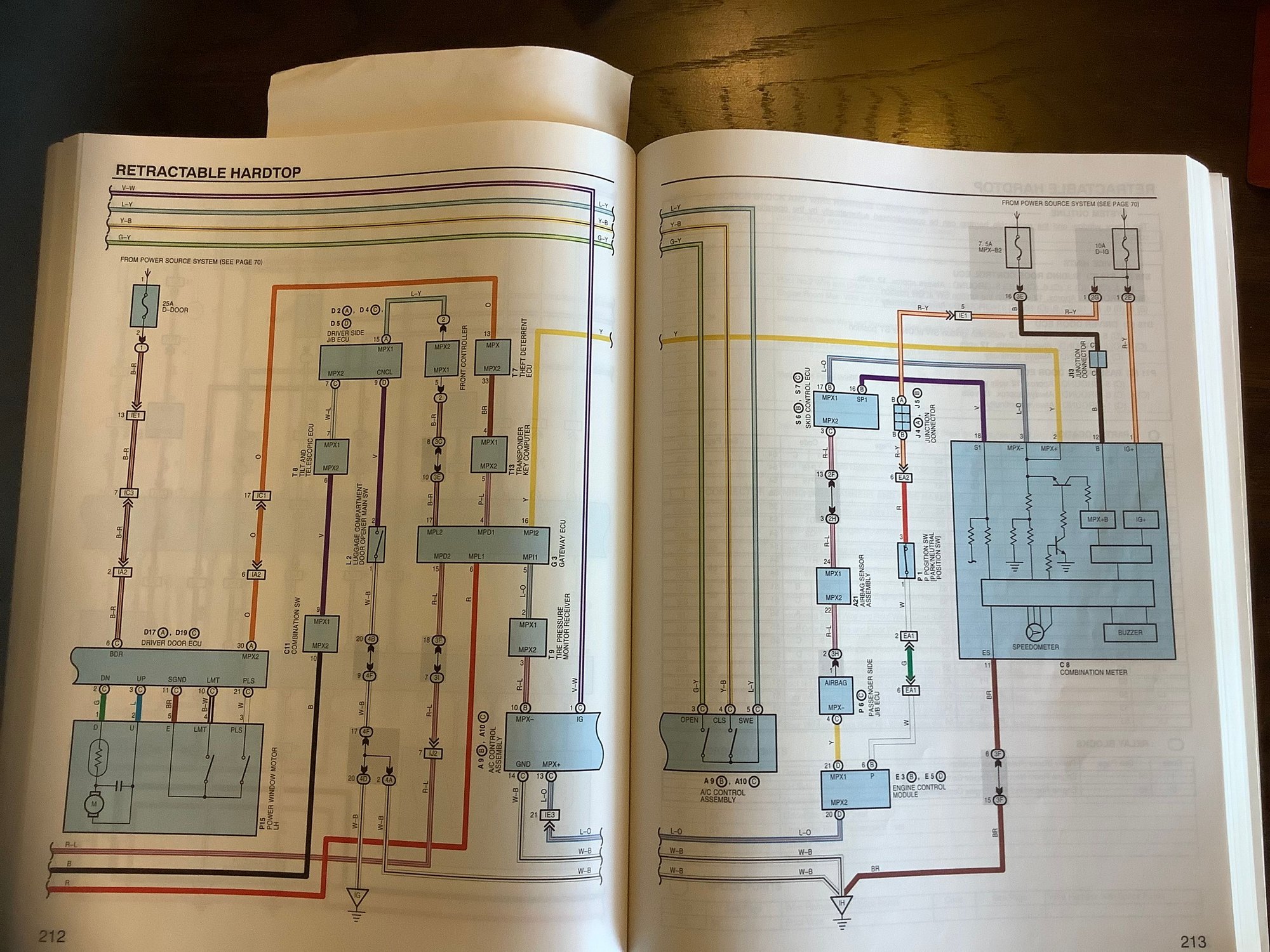

Old Aug 5, 2021 | 08:55 AM
Bgw70's Avatar
Bgw70
Veteran: Air Force
Joined: Dec 2014
Posts: 8,213
Likes: 949
From: Fl
Here are the wiring diagrams…the switch is in the third pic, right page, lower left…let us know how it goes.
Old Aug 5, 2021 | 06:29 PM
JW266's Avatar
JW266
Joined: Aug 2021
Posts: 25
Originally Posted by Bgw70
here is the process, you might be able to do it alone…If I was nearby, I would let you borrow my control.
https://f01.justanswer.com/JACUSTOME...anual_open.pdf
Oh dear lord. That's too much. But I appreciate the .pdf as that section is not in the manual I found. Ill label it something like, "In Case of Emergency, When Suicide is not an Option."
Old Aug 5, 2021 | 06:31 PM
JW266's Avatar
JW266
Joined: Aug 2021
Posts: 25
Thank you sir!
