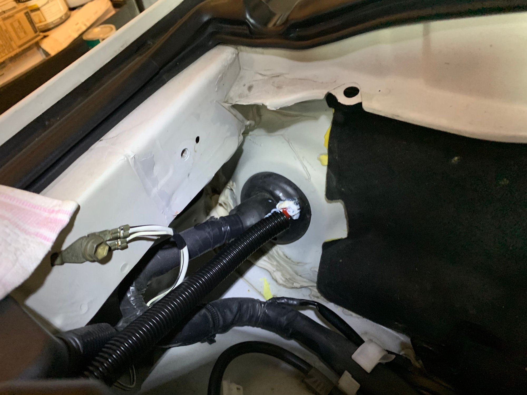

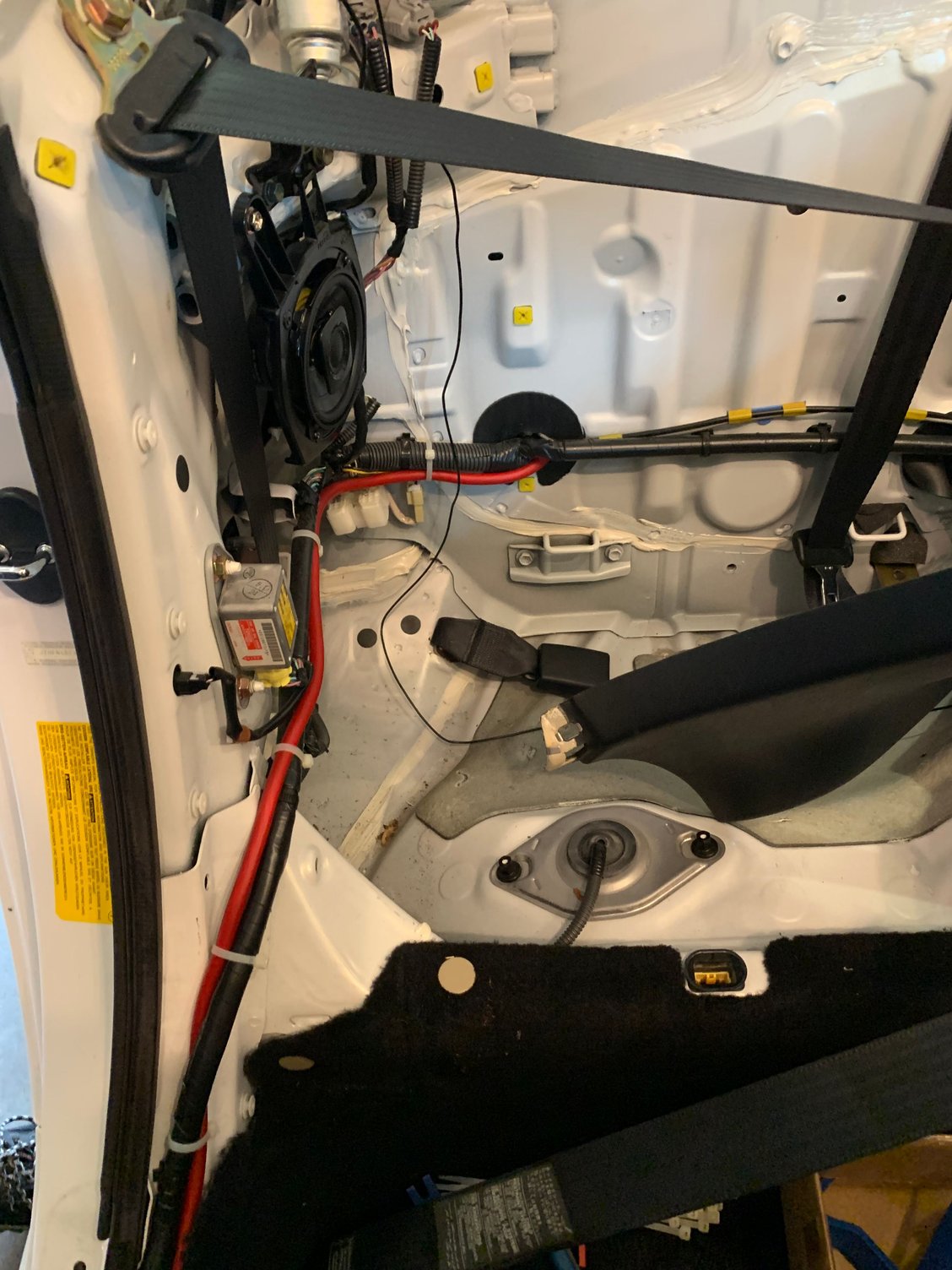

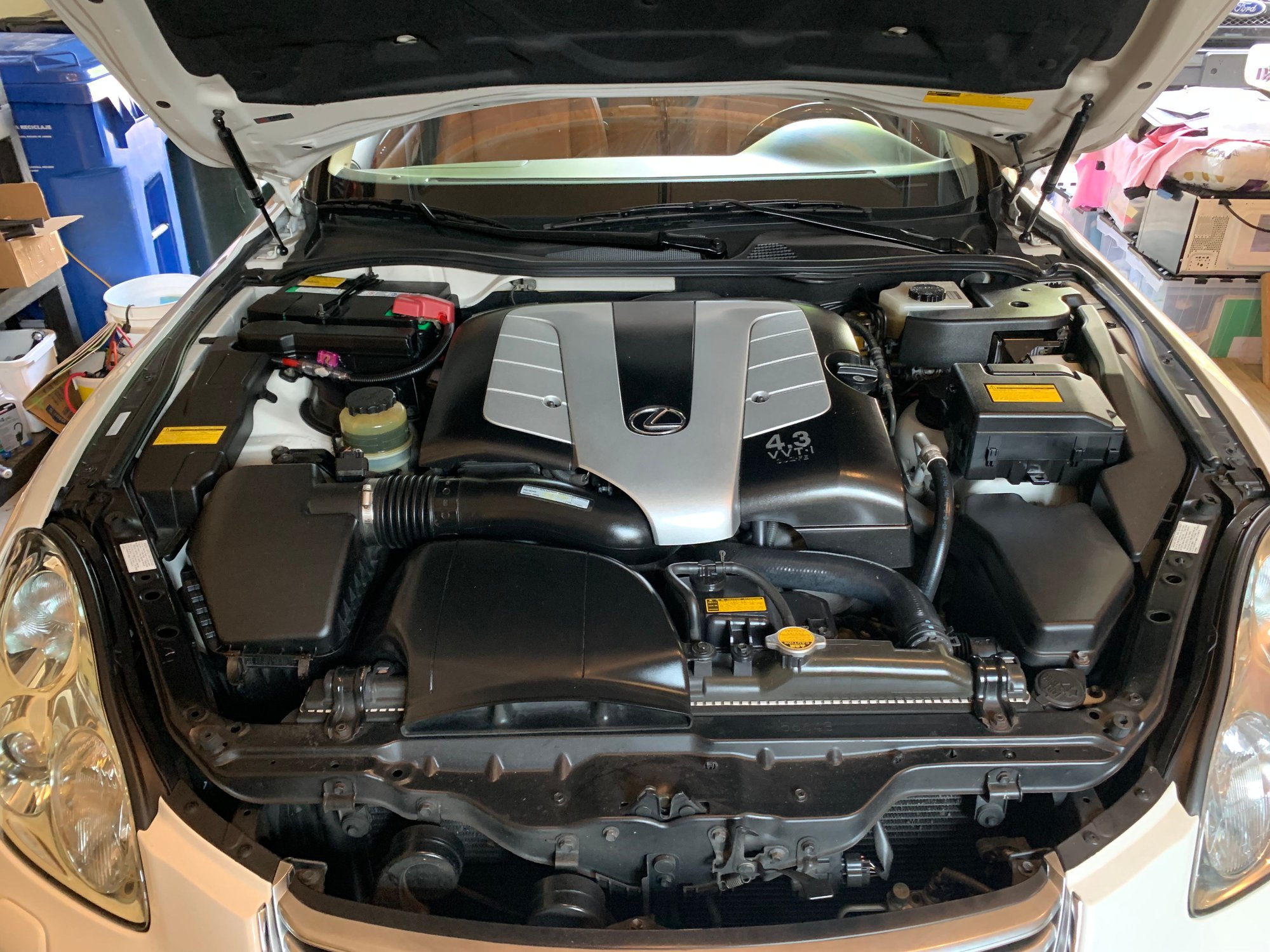

  3. The hardest part of the install was getting the power from the battery back to the trunk. The existing ML amp only has 30 amps to it - not enough for a modern amplifier. So this required me to run a 4-Gauge wire to the trunk. I removed the battery and horn and there was a cable-grommet behind the battery. I was easily able to pop it out, cut a small hole in the middle, and push the cable through. I cleaned the grommet with alcohol and then caulked around the cable entry when I was done wiring it up. Fishing the cable down from behind the glove box was an exercise in patience but I eventually was able to pull it down and run it under the right side door kick plate, up across the back right, and then through the grommet that is behind the rear passenger right side seat into the trunk.
    1. I used a very long cable tie (~30" long) as my fish tape. It worked really well for fishing through the firewall, through the dash, and down the front side of the door opening. Patience was key. I tipped the glove box all the way down by pulling the plugs you use to get at the cabin filter. This expose a slot on the right side that allowed me to see what I was doing behind the dash board when I was fishing the wire though. I also took off the dash board's right side panel next to the door to be able to see and steer the cable.

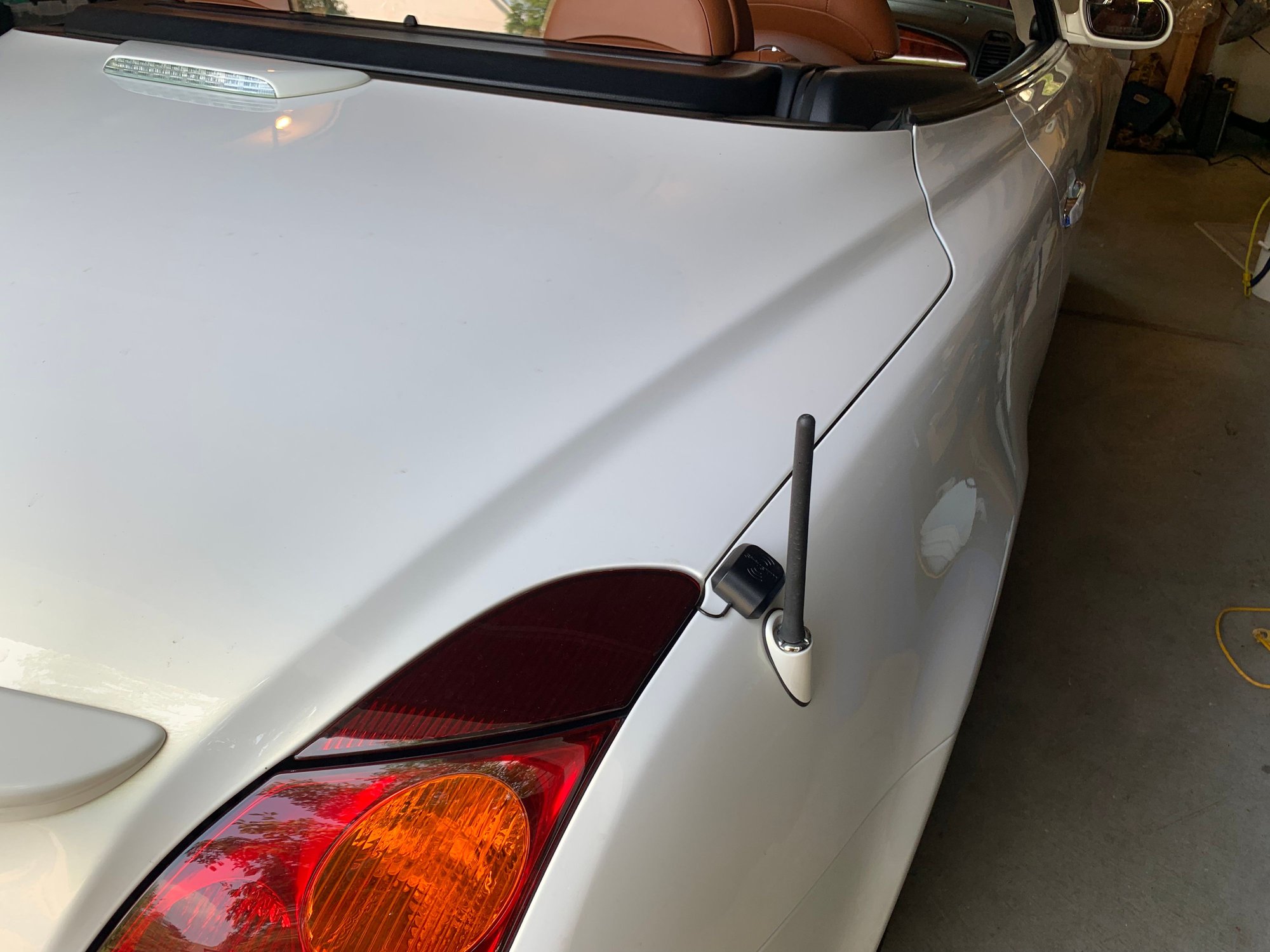

  7. There are a lot of opinions on where to mount a SiriusXM antenna. The SiriusXM antenna is designed to be flat mounted with an unobstructed view of the horizon in 360 degrees, like on the roof of the car. (That's why putting it on a dash board doesn't work well - the roof casts a 'shadow' from the satellites). I chose to mount it next to the rear antenna, run the cable underneath the trunk weatherstripping and into the trunk, then up the center console with all the other cables. I've had very good luck with where I mounted it. Just have to keep the tail away from the convertible lid and mechanism by tucking it in securely.

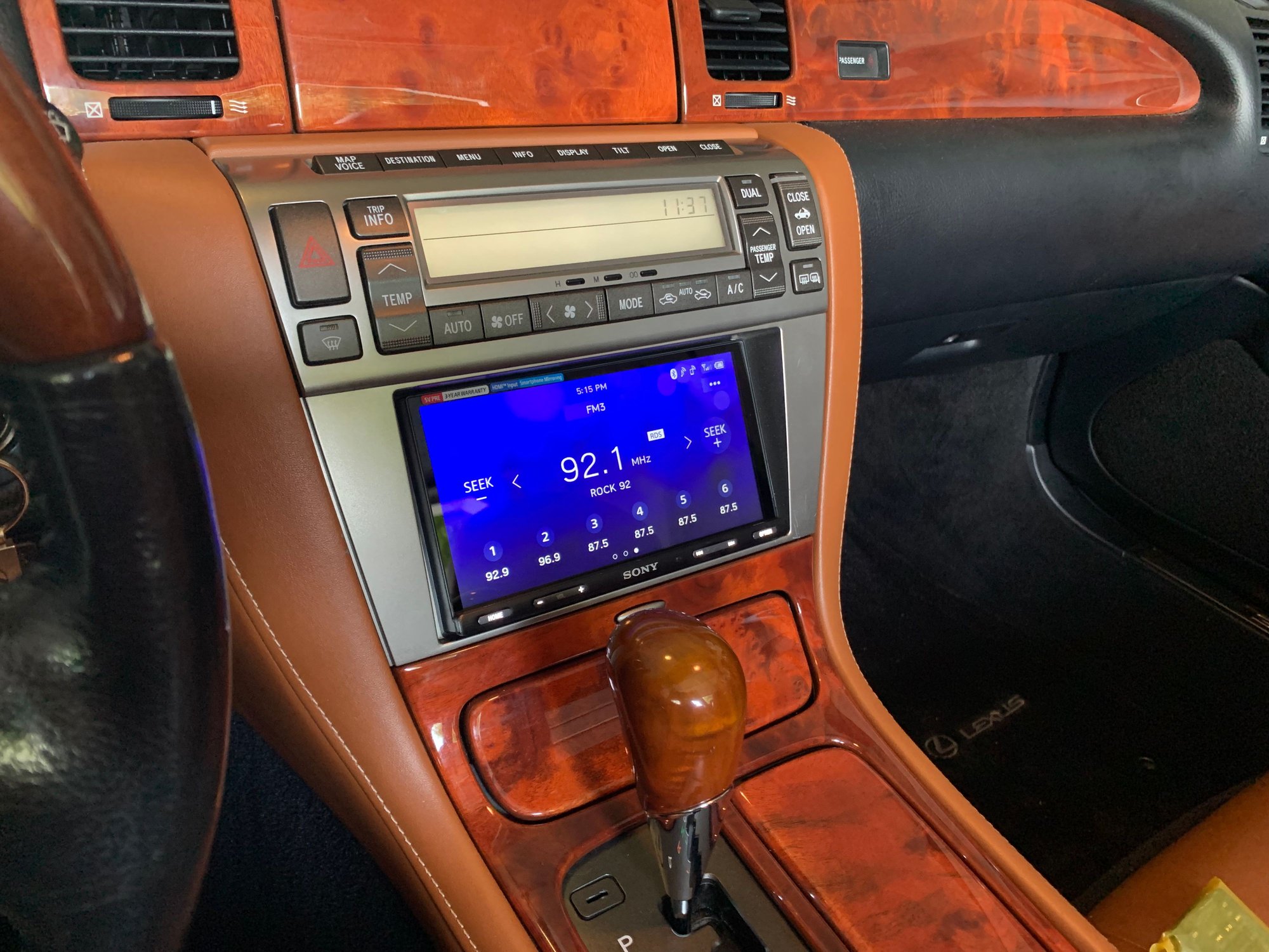

  11. I wanted to keep the original 'factory door' over the radio. I couldn't find the right size thread/length of screws that would allow me to mount the Sony unit inside the factory door module. The factory module has thick plastic bosses where the mounting holes are and need about 3mm longer screws. I eventually gave up and decided to use the Metra 'without door' adapter. It looks decent, but I may eventually go find some screws that can allow me to put it back into the factory door module.
  12. I tried a few tricks that found on the forum to try to salvage the CAN bus so that I could retain the upper factory NAV door function and buttons. I tried a few things and could get EITHER the Axxess module OR the upper door & buttons to work, but not both at the same time. I gave up and decided that the head unit + apple CarPlay was much better anyway.

Grommet behind the battery that I used to run power.
Power cable installed. I used loom around it to protect it. Routed in front of the fusebox and over to the + terminal.
All buttoned back up with the battery and horn reinstalled. That part was very straight forward.

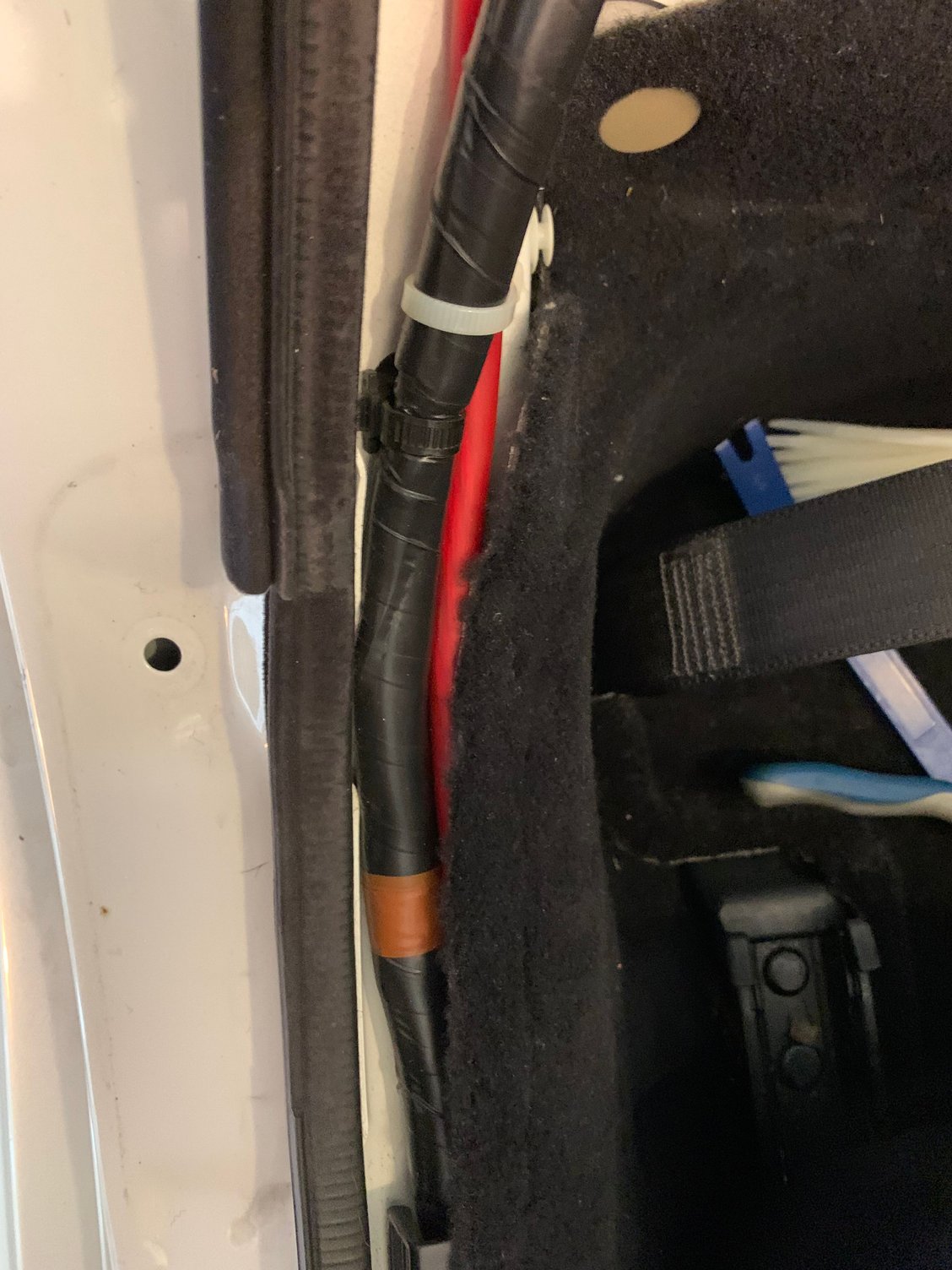

Running the power up the back left part of the door frame and along the side of the rear passenger seat. The red cable is the new power cable.

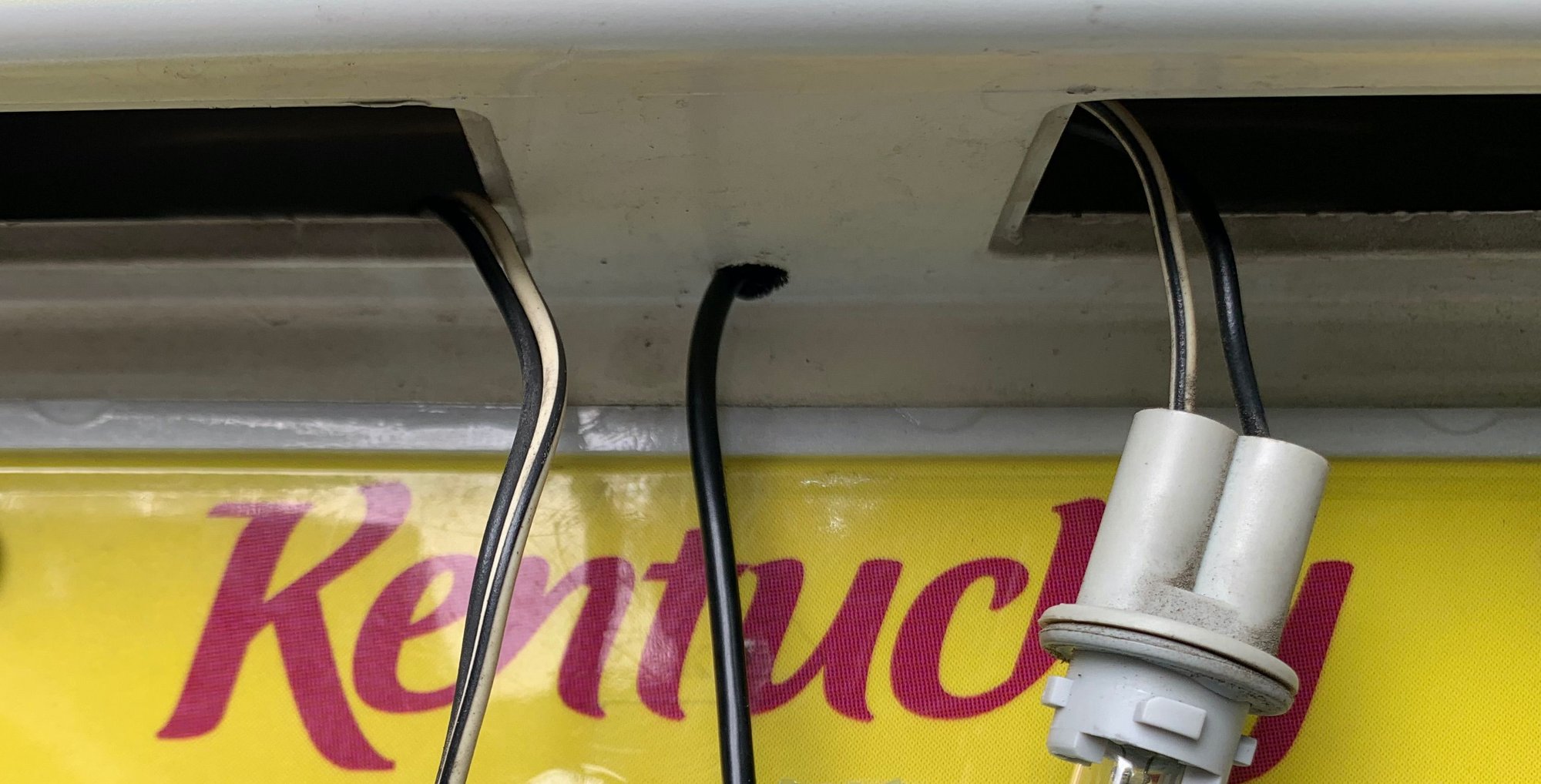

Grommet where the back-right tail light cable comes into the car. This is the easiest place to bring the camera cable into the car. Trace up that existing loom and you'll find a red wire in there that carries the voltage when the reverse gear is engaged. Tap into that to power the camera and signal the head unit about going in reverse.

My new antenna and Sirius XM antenna. Tuck the tail of the XM antenna down behind the black plastic inside the trunk edge so it doesn't get pinched/rubbed when you open the convertible top. Then I dropped it behind the interior trim and it fell out right where I needed it to put it in the loom I was pulling the audio wiring in. Convenient.

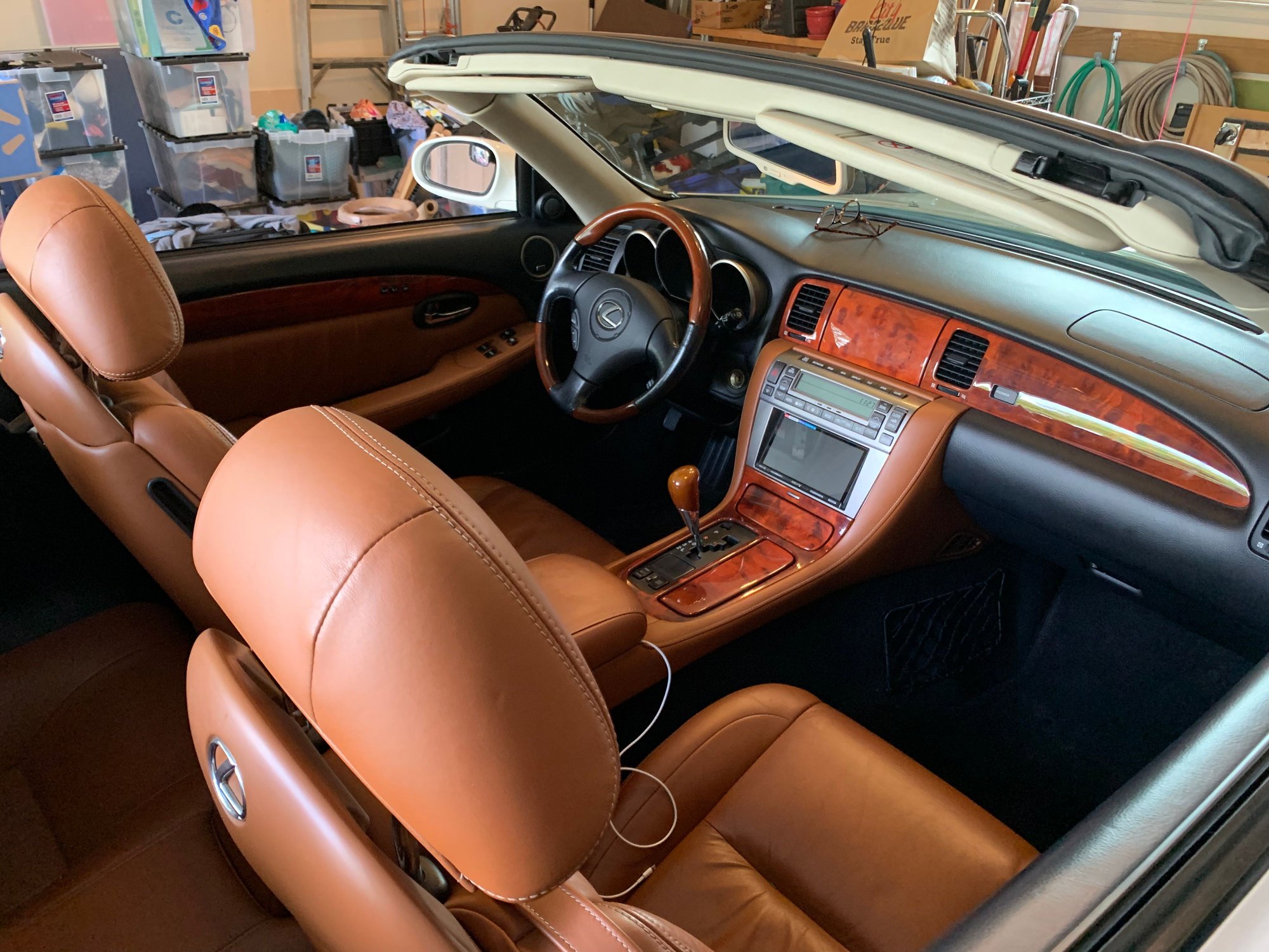

Finished product. Sounds good. Metra frame matches the silver trim nicely.

Okay, now you can't just keep us hanging... Please describe what you replaced and what you installed. Then, of course, you need to post some pictures! How do you like the new setup?

LOL - yeah something happened and it posted before I was done editing. So the original post now has everything and a few pix. I don't have a glamor-shot of the car out in the sun, but trust me that she looks pretty and shiny
I'm really happy with it. Would have liked to get the factory door assembly and the factory nav system buttons working - mostly because I kinda think that's 'vintage' and makes it looks stock. But really, not needed since the new system is much better than a 20-year-old nav system.

Why does it look lopsided? The photo angle?
Old Jul 24, 2021 | 01:33 PM
MattInLex's Avatar
MattInLex
Joined: Mar 2020
Posts: 36
Likes: 13
From: KY
Yeah, not a great picture. It is straight and square - I'd twitch every time I got in the car if it wasn't.
EXCELLENT write up and very professional installation with instructions.
have you considered placing the XM antenna inside?
I put mine here and no dropouts at all.
that would definitely be easier, for sure and looks great. Before I did the install, I had a standalone XM unit piped in through the FM antenna. I tried a few spots for the antenna and most didn’t get good reception. I tried that spot too. I settled on the spot next to the antenna and have had good results for a few months.
Glad your spot works well. It could be because of where I live compared to where the satellites orbit. The ‘line of sight’ might be more overhead in my area?? Just a guess.
