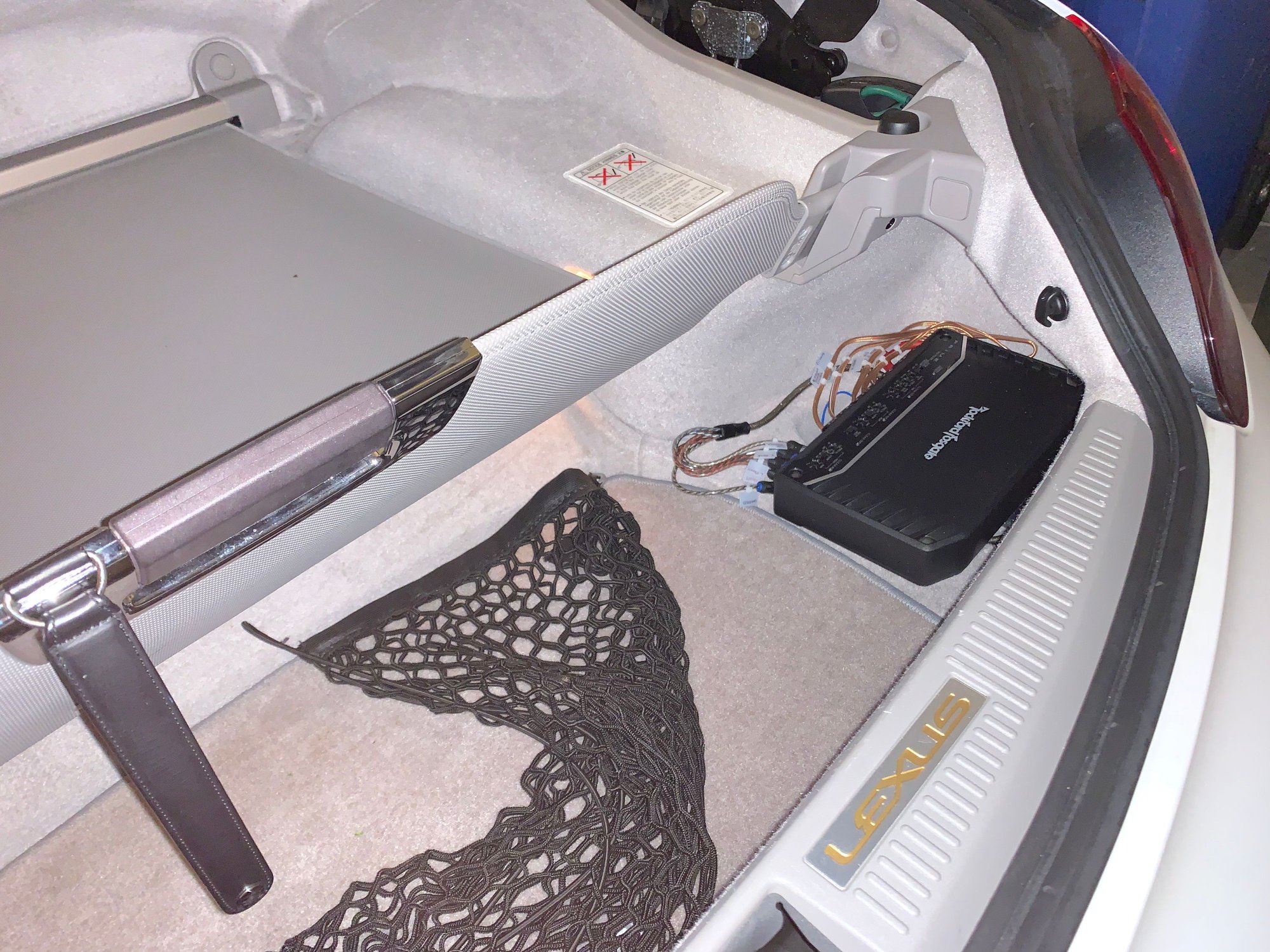

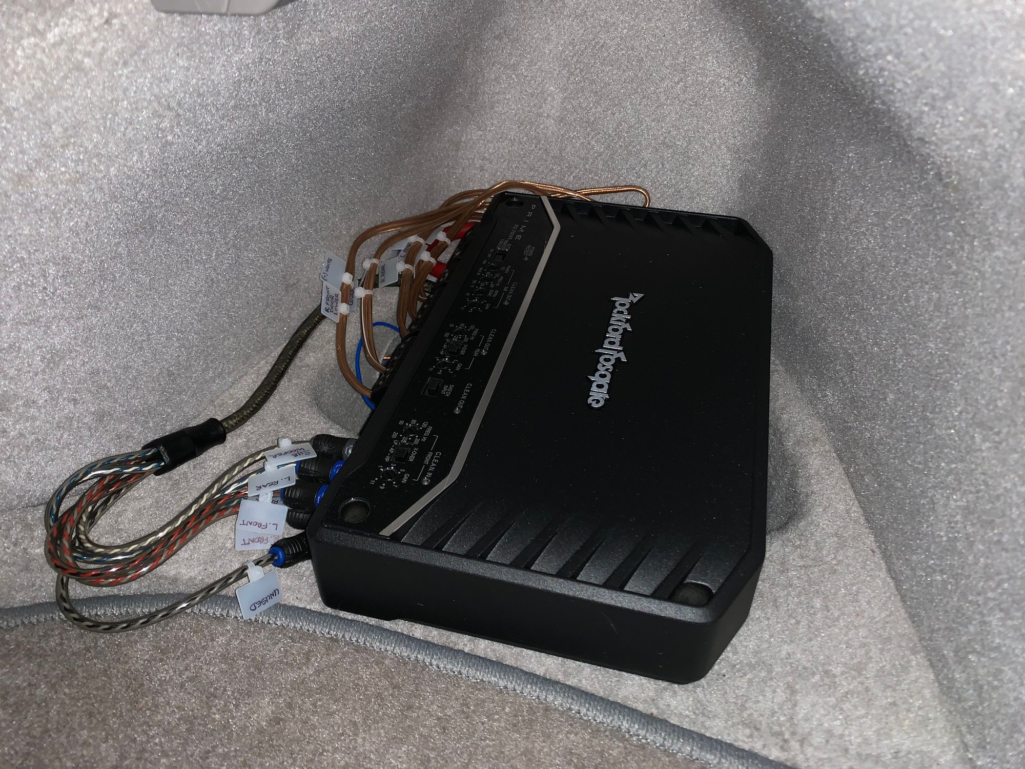

If you already know about audio stuff this should be pretty easy - the hardest part was just finding the information needed. I'll put the info below as well as the lexus schematic for the audio system. Mine is a 2002, the schematics are 2006, but were identical for everything I needed. I've received a few private messages with questions, so I'll go ahead and add a few details after having the system in for a little while.
I also have a picture of my final installation placement of the amp. It sits very nicely in the right cubby and I screwed it down to the carpeted plastic. You can't see it very well, but I used a hole saw to cut a 2" hole on for all the signal wires and another 1" hole a bit farther away for the power/ground/B+ wire. All the wires tuck nicely into the cubby below the amp. I like that it doesn't interfere with the tool tray or the cargo net. I could have mounted it under the rear carpet shell, but I wanted access to be able to tune it and keep it cool.
First: Wiring colors. (See schematic below). Here's what I used:
I looked long and far for matching connectors to the Lexus amp that I could use and keep the factory harness. Didn't find anything so I just clipped each wire pair and crimped them to new speaker wire that I ran to the new amplifier. If I recall correctly, each speaker set of wires was twisted together making it easy to figure out which two go together. The pairs are matched up above/below each other in the connector. Peel back the tape from the Lexus harness a few inches and you'll easily be able to figure out the twisted pairs.

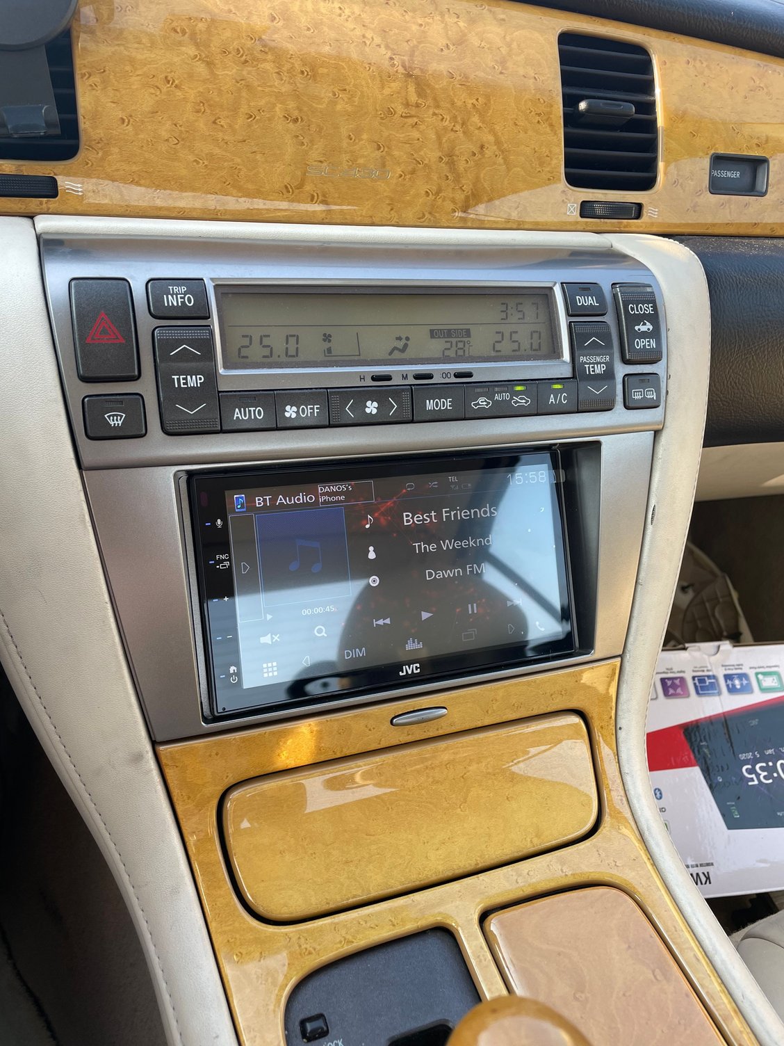

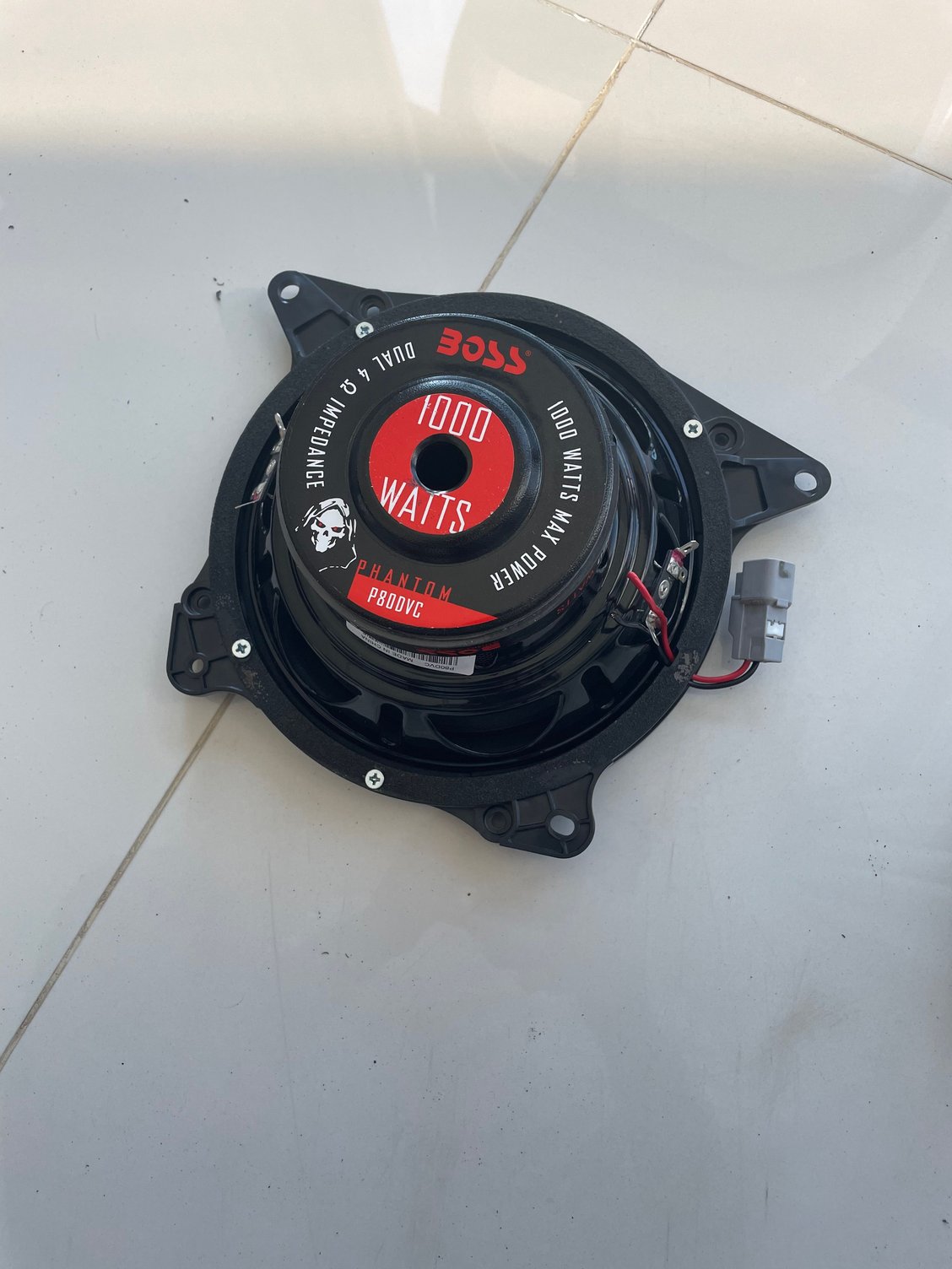

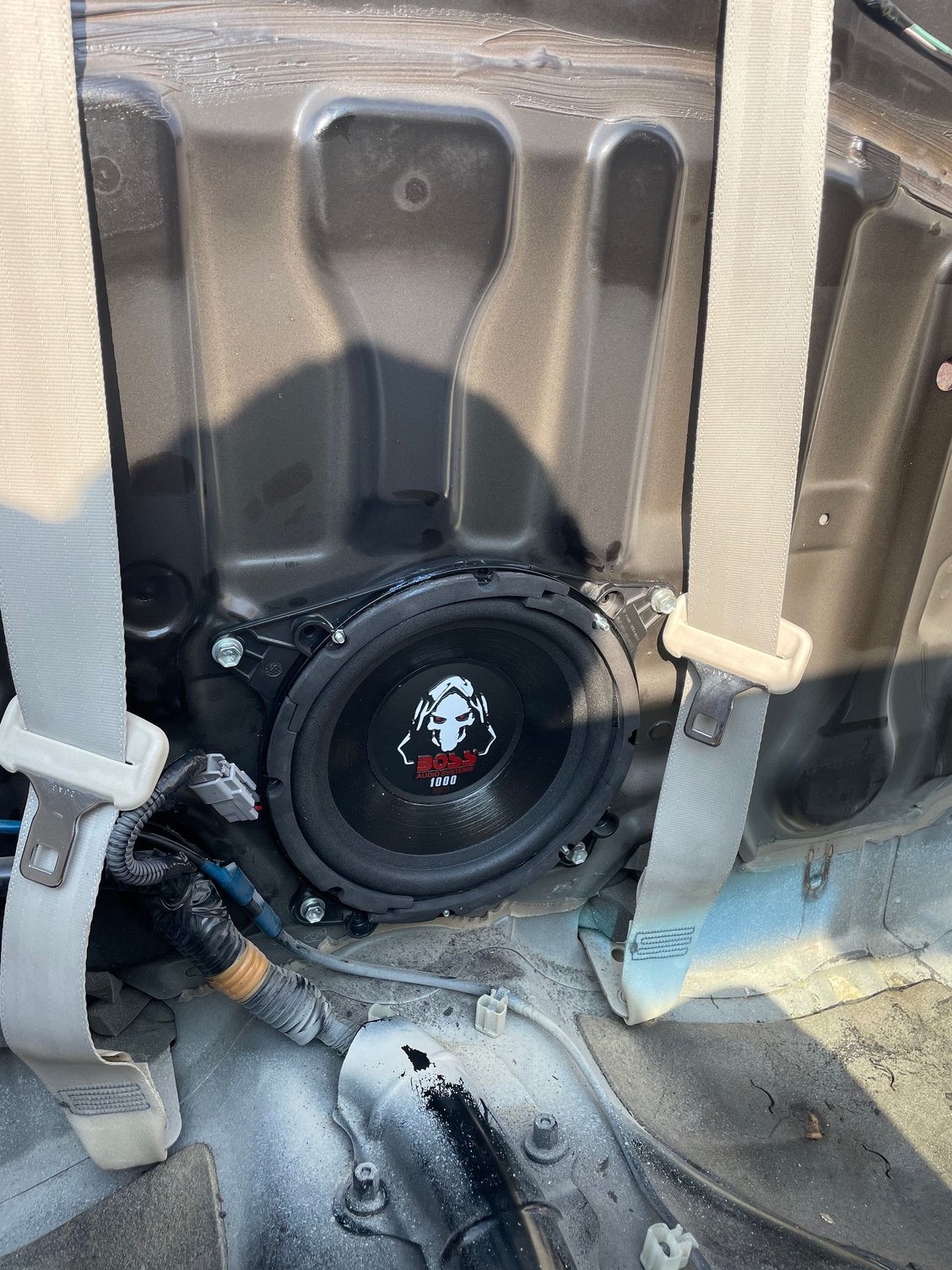

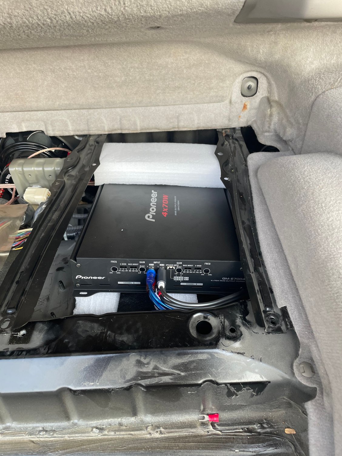

So finally finished today. So happy with the results. Purchased a JVC M560BT as the replacement head unit. Loved the idea of having Apple Car Play. I decided to ditch the stereo motorised door and went for a direct installation. I think it looks pretty good and the stereo surround is a good match to the original silver trim.
Running the front pioneer 6x9’s is a pioneer 4 channel amp. I bridged the rear 2 channels to a Boss Audio dual voice coil 8 inch sub. I managed to drill some holes in the mounting bracket, and rewired the sub to the amp. For the front 6x9’s I used the existing cables. Amp fits in original location.
I followed the writing diagrams from this post. Thanks again. It was so helpful.
