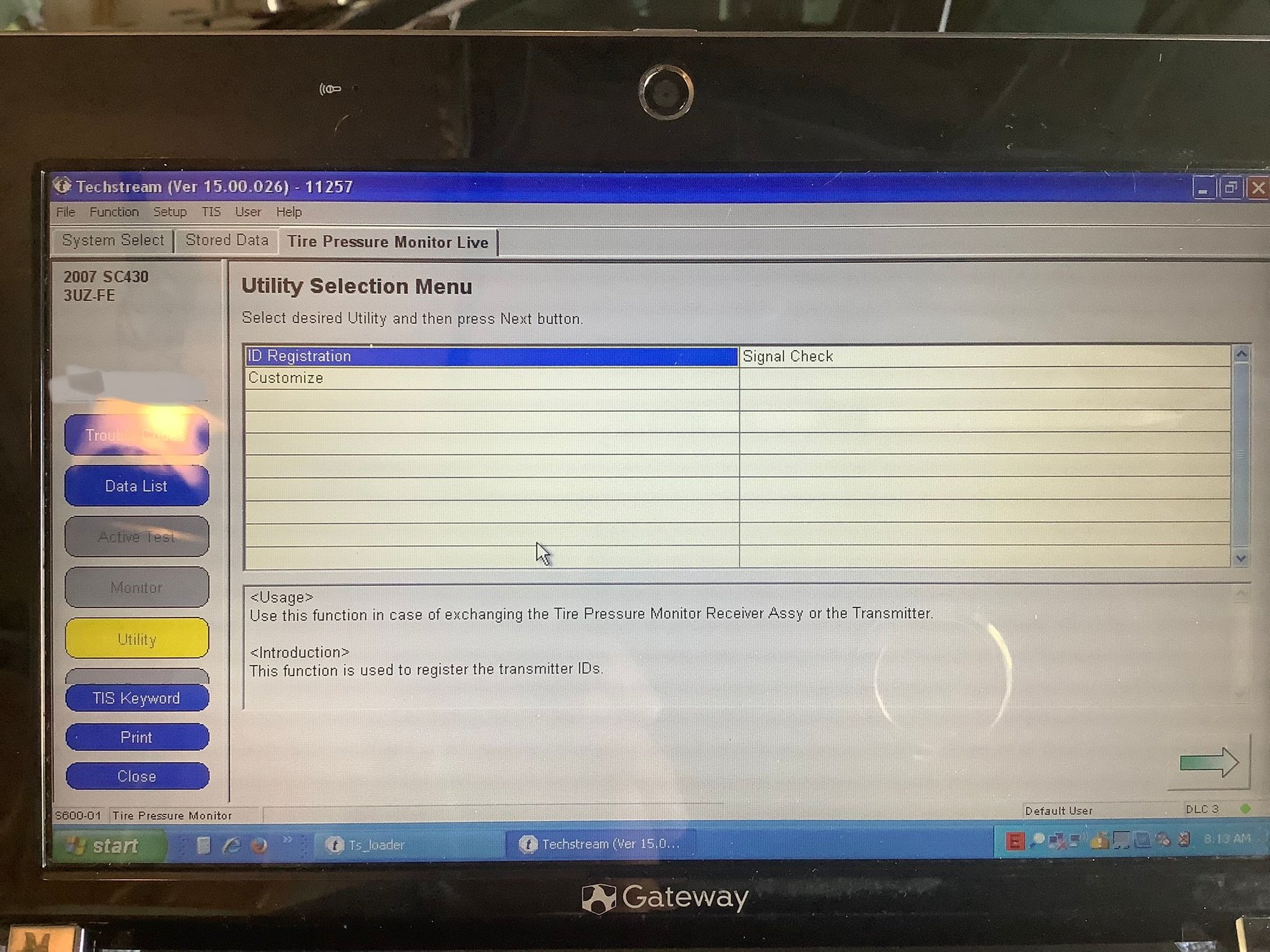

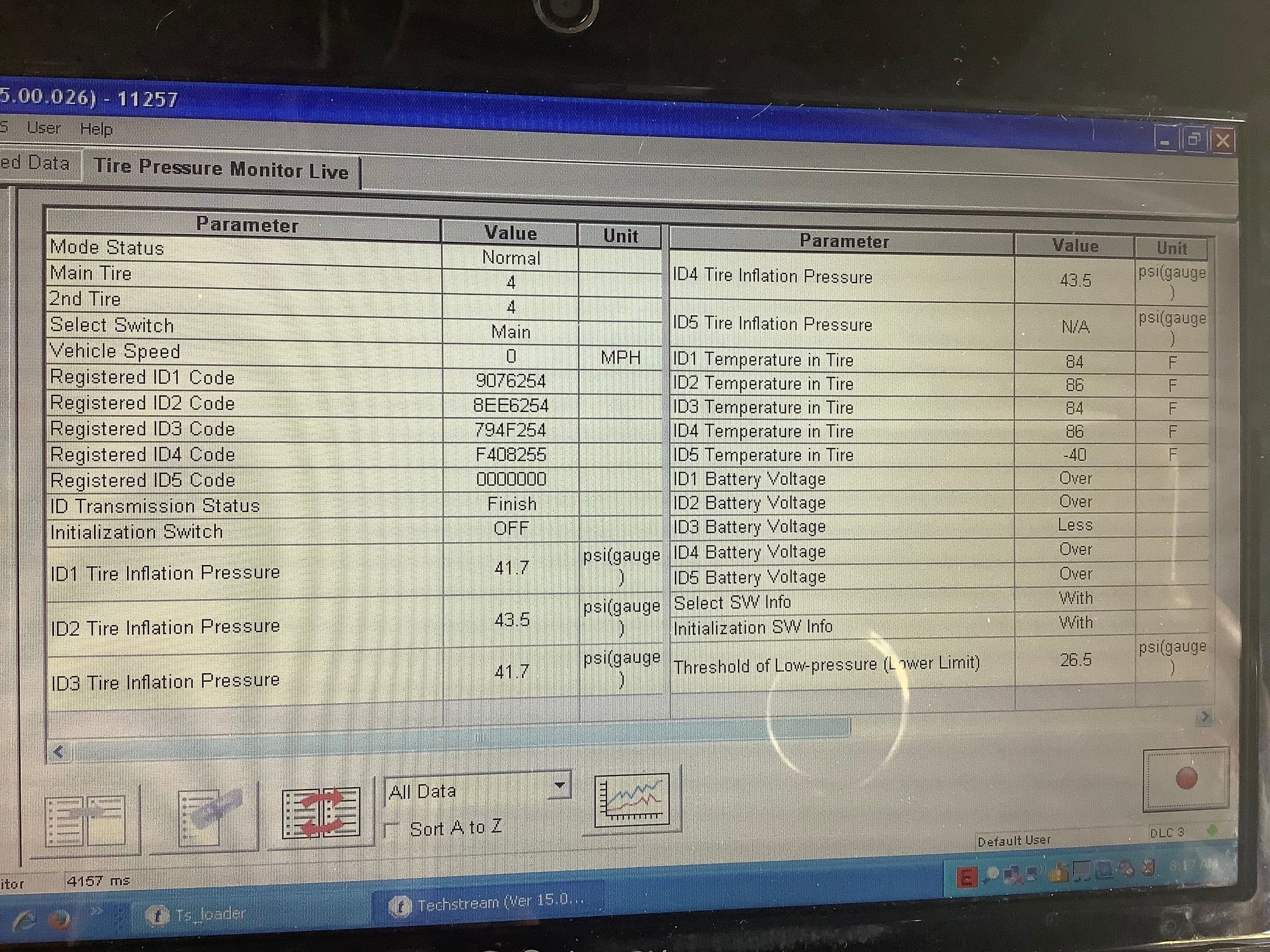

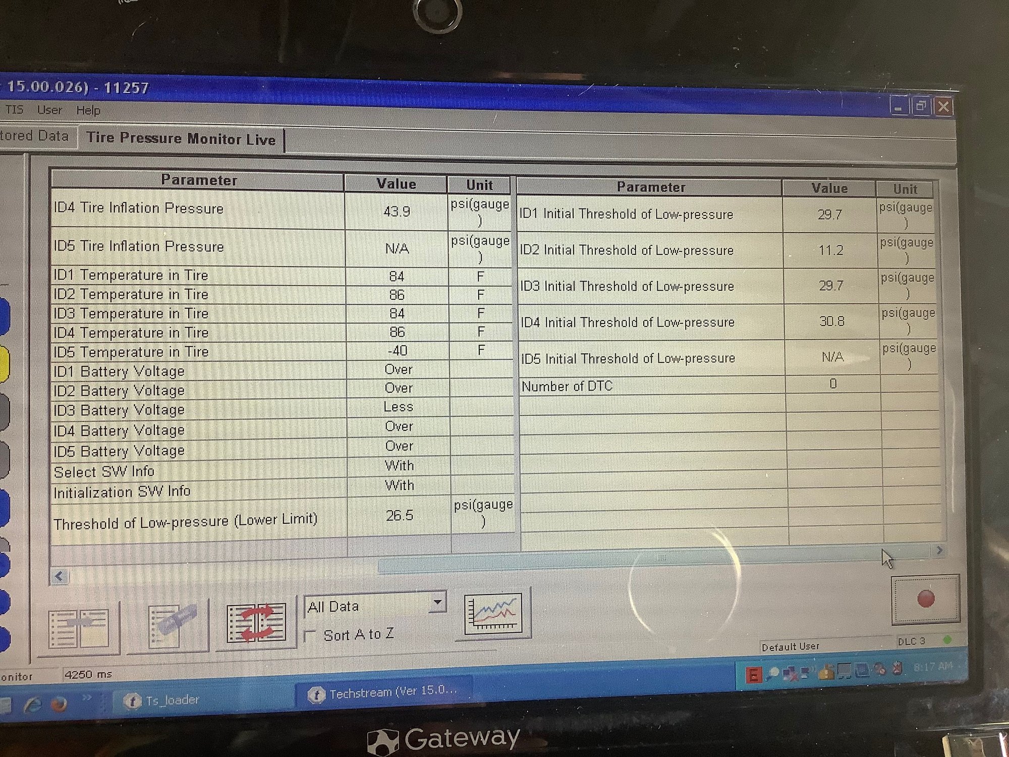

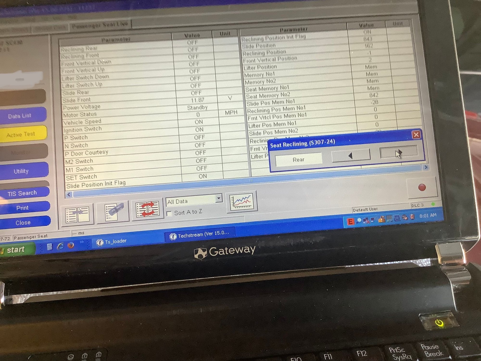

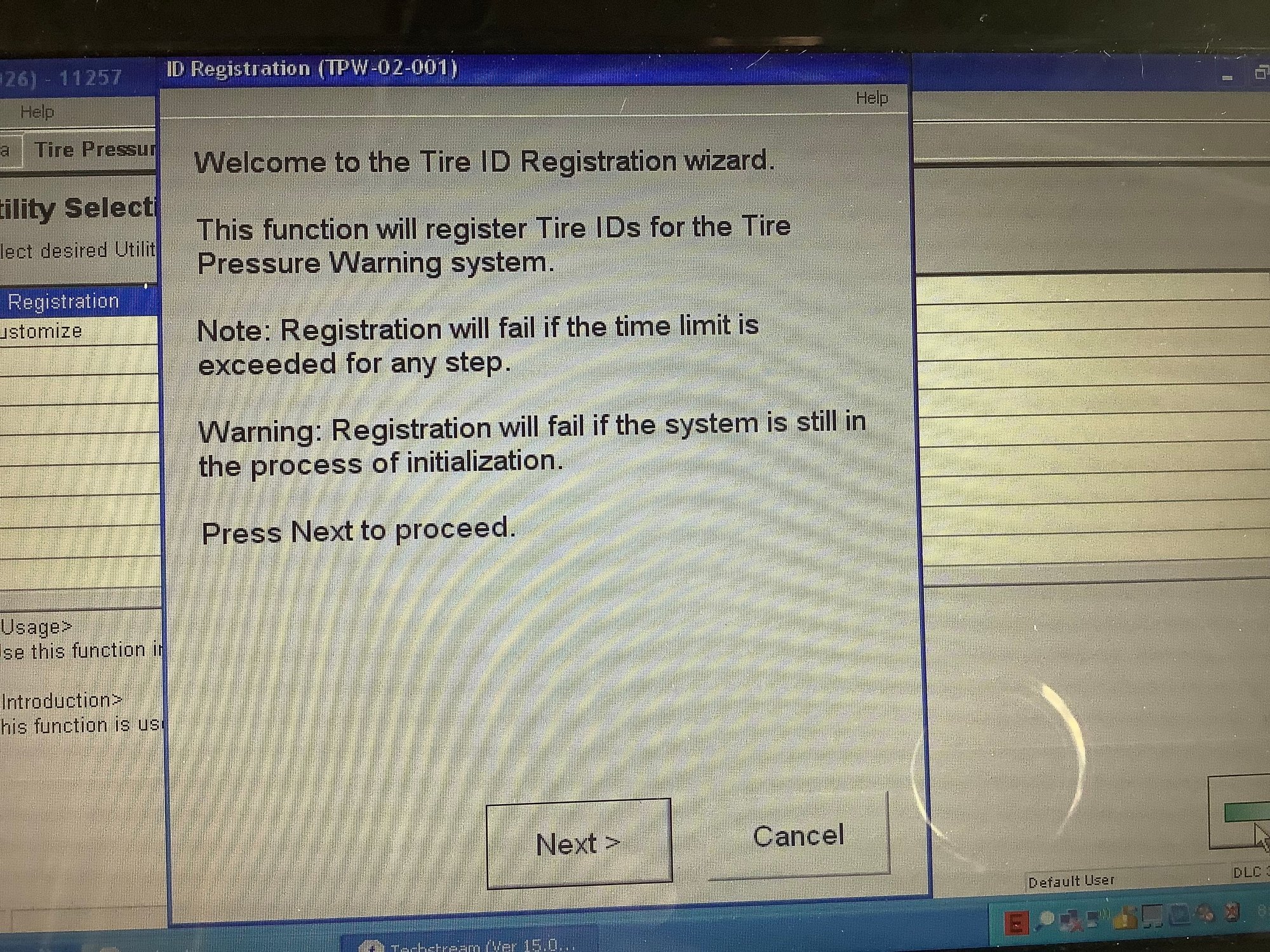

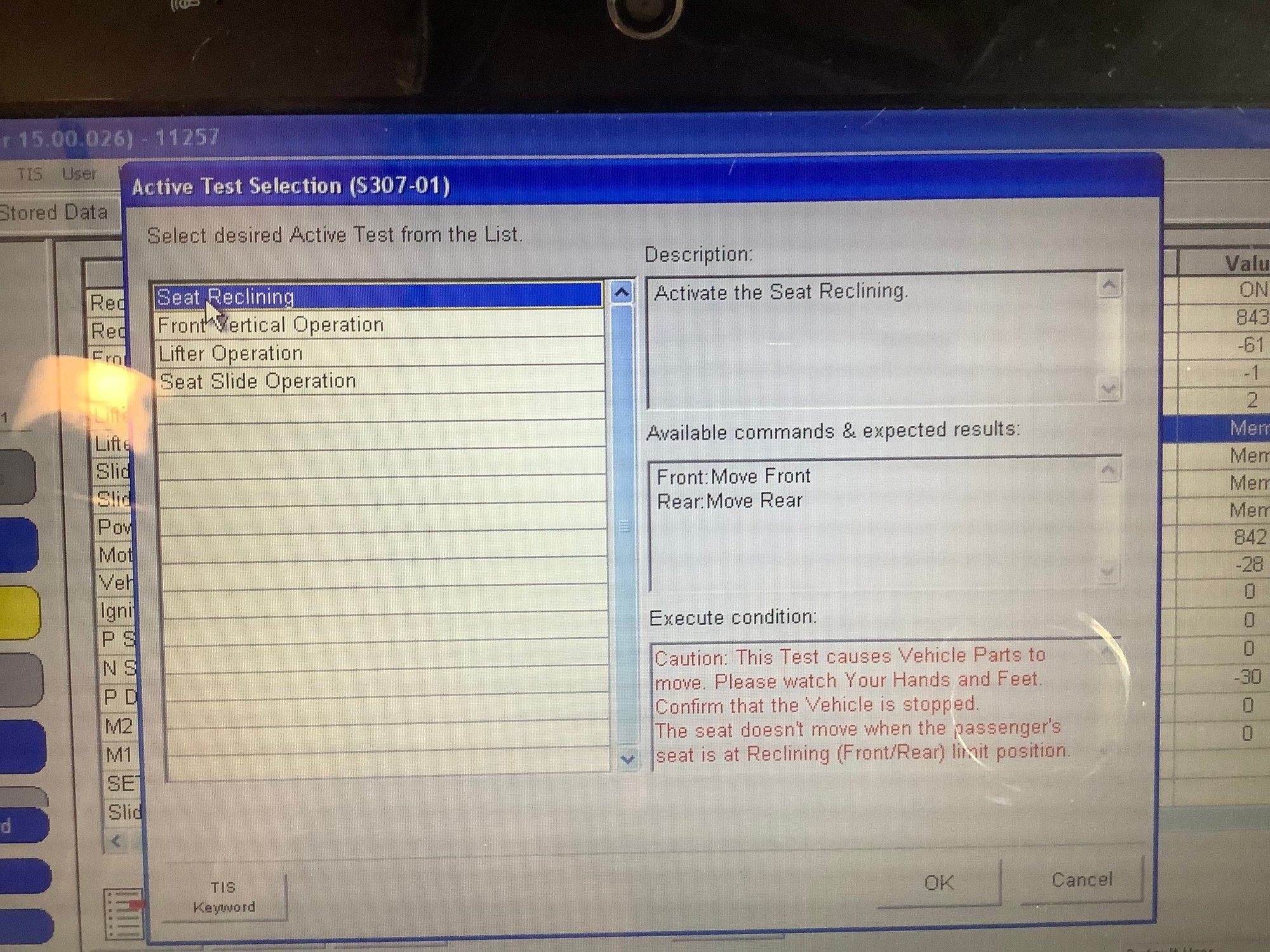

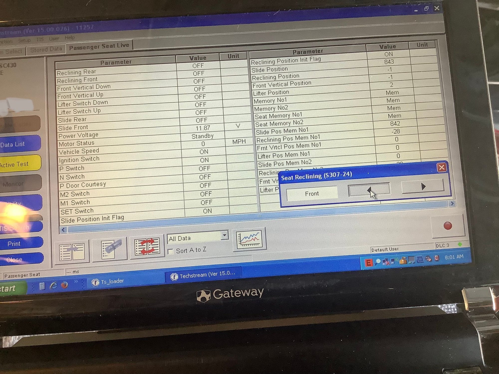

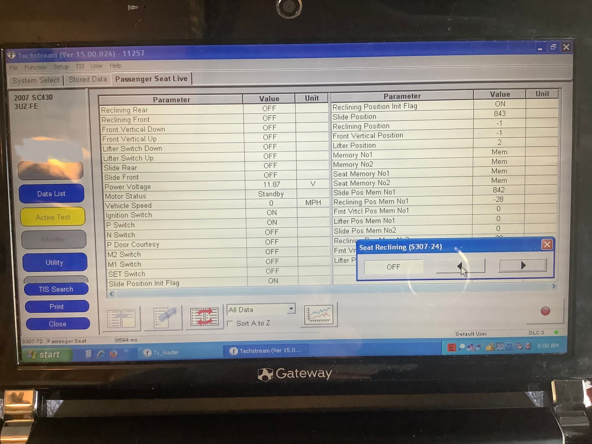

First of all, Great video Daryl…his warnings are so true about the hacked Techstream…mine is on an old throw away laptop.
I went out and fired up Techstream software v15, installed over v12 this morning using cable v1.4.1 and v2.0.4.
let me start by saying cable v2.0.4 only read the VIN data of my 2007 SC430 but wouldn’t change any settings or command the seat ECU to recline the passenger seat back. I think the cable or chip has issues…
Cable v1.4.1 worked 100% as usual.
here are some pics of a couple of operations…as usual, not in the order I originally placed them…ugh
