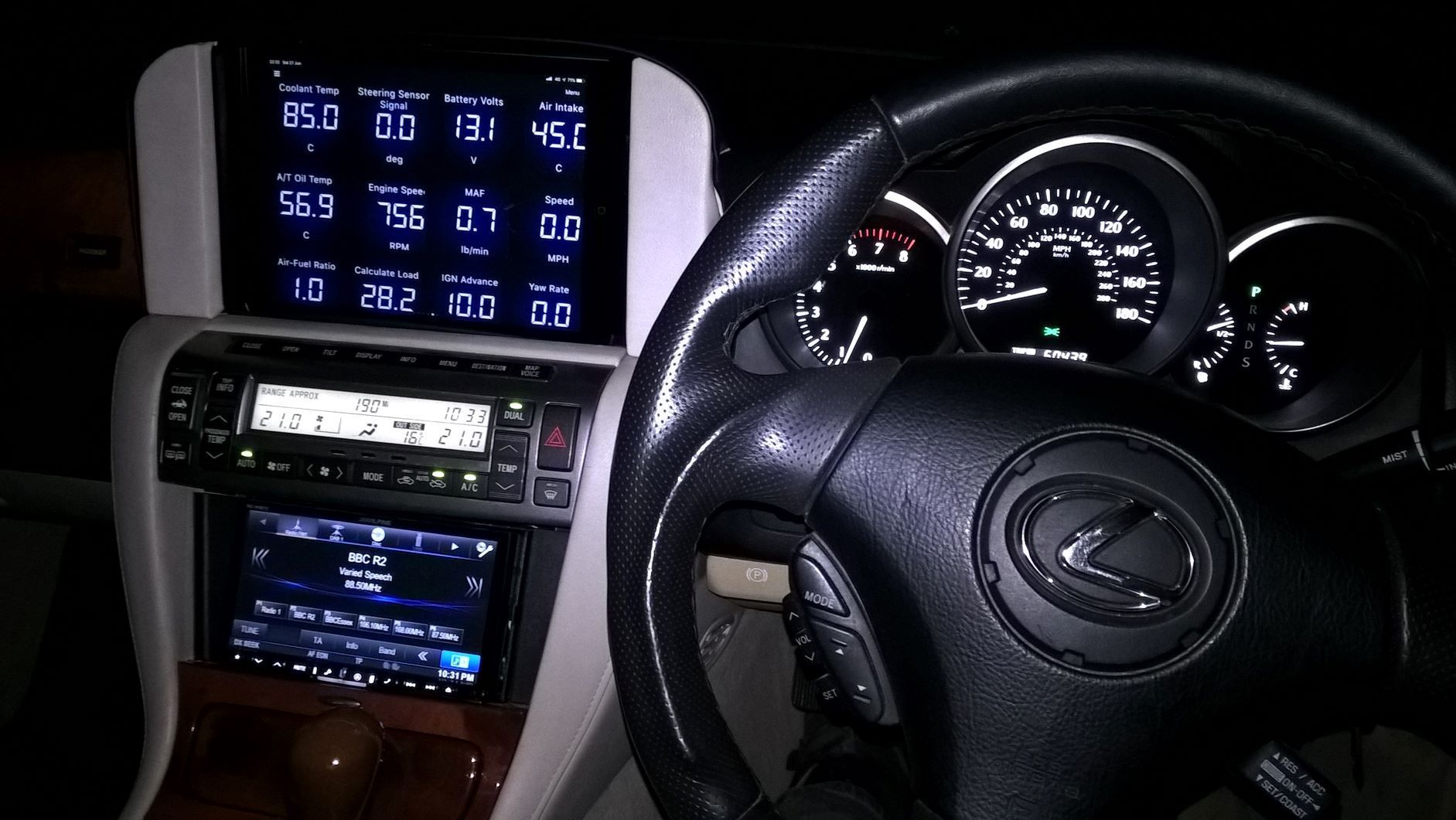

To get a larger nav screen, obd readout and various other options, I have an ipad fitted in place of the nav screen. I assume an Ipad would connect directly to the GTA kit. It's a bit of fab work but would that be another option for you?

Hi Bruce, I know what you mean. Sometimes the headers and exhaust take centre stage but I confess despite my aging ears I still like the music to have some quality to it.
A smaller ipad or feature rich head unit would be more sensible and fit better into the dash with less work. The benefits of the ipad/android device would be versatility and potentially a larger screen. I'm fortunate as the Alpine W987 is used in place of the oem head unit and can mirror the Ipad/Iphone and with duet the ipad can link with a laptop. With the IPad installed I lose the centre air vents. Not too much of a concern in the temperate UK.
Does your car have the Navi screen or a trim piece where it usually goes? Is your's a right or left hand drive car? I do have some pictures with the sat nav removed and in pieces, etc if that would help but it's a uk rhd car.

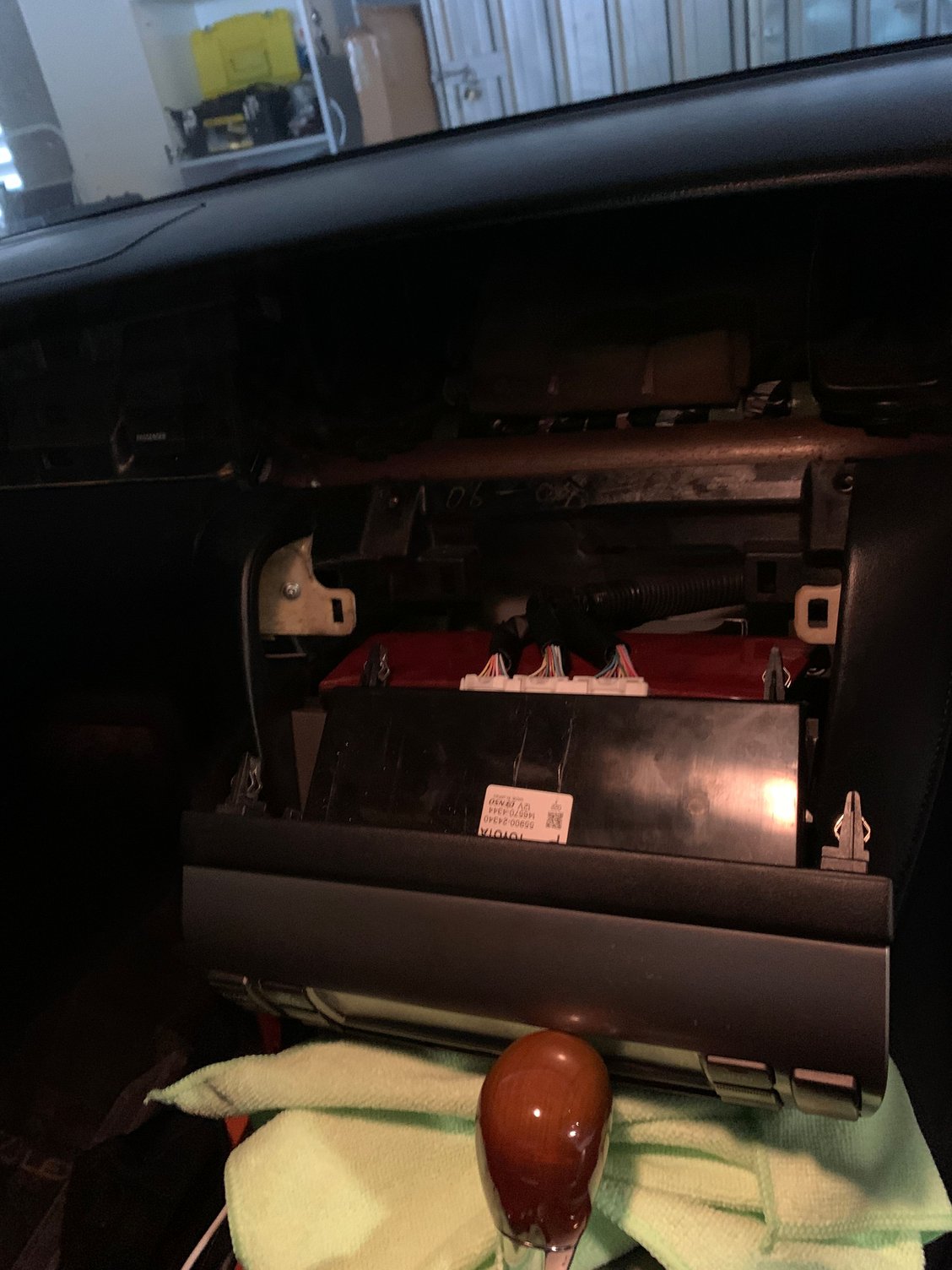

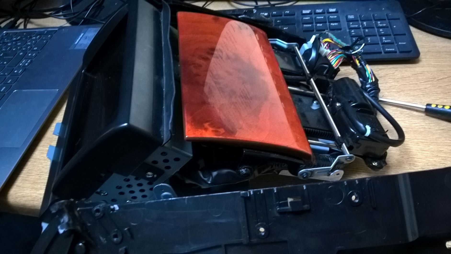

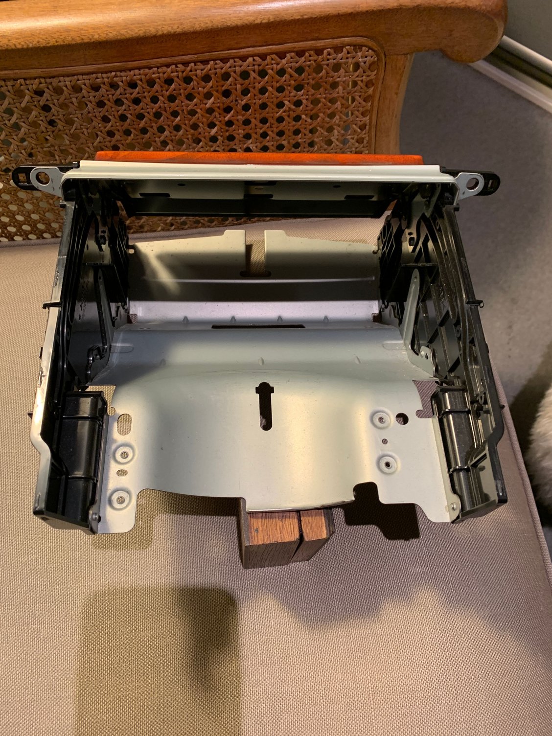

Hi Bruce your nav door and casing looks the same as mine but with the internal screen unit and the motorised door components missing.
Mine is an 2006 too but I also bought a spare navi unit from an earlier car to take a apart for investigative puposes. There are some subtle differences as the later has more functions. Here are some pictures I took a few weeks ago when I was looking at the options.

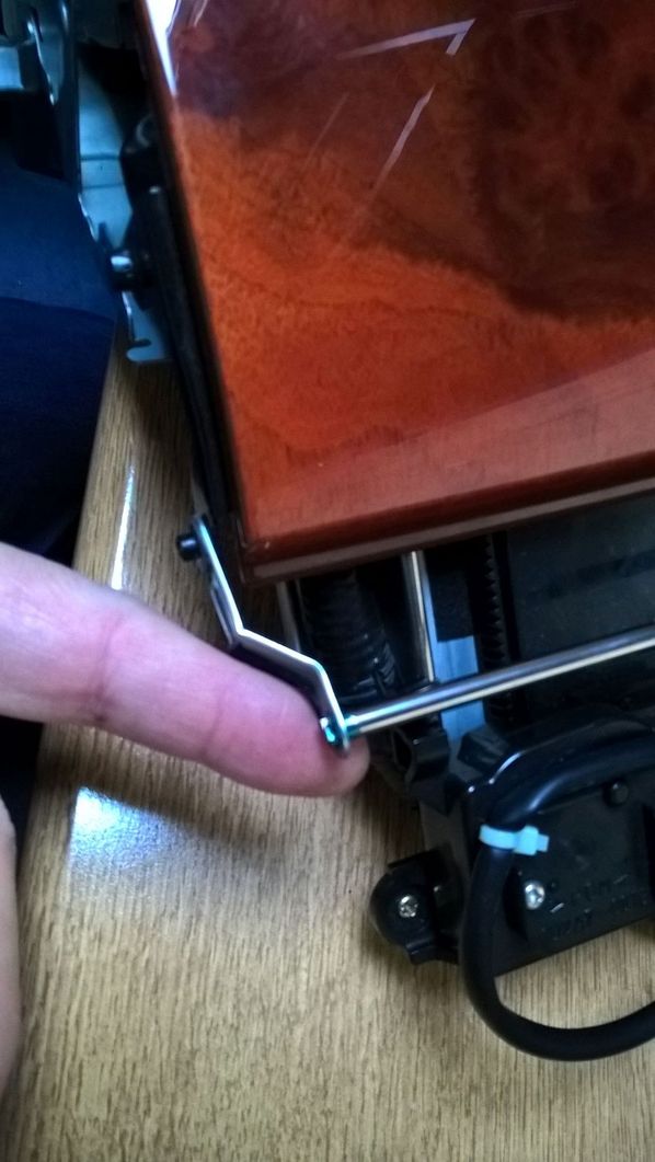

The later model as in the pictures has the 2 multi-plugs. The earlier model has one but the door mechanism appears to be the same.
A 2 din full size head unit such as my Alpine wouldn't fit behind the door but if you took the unit out then I'm sure it could be neatly adapted to fit. I would say there's room for a fold out screen if that appeals to you.I did think of doing that with a different Alpine unit and retaining the door but it's too much of an engineering headache.

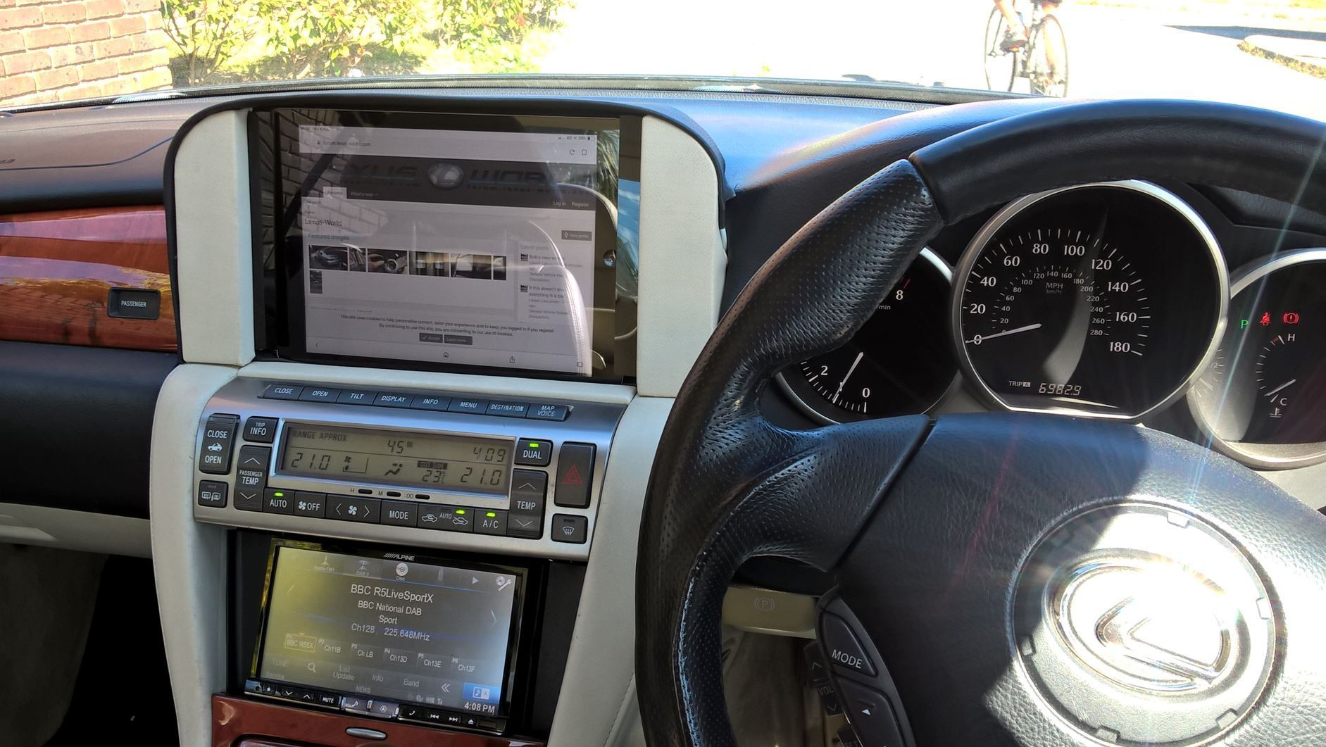

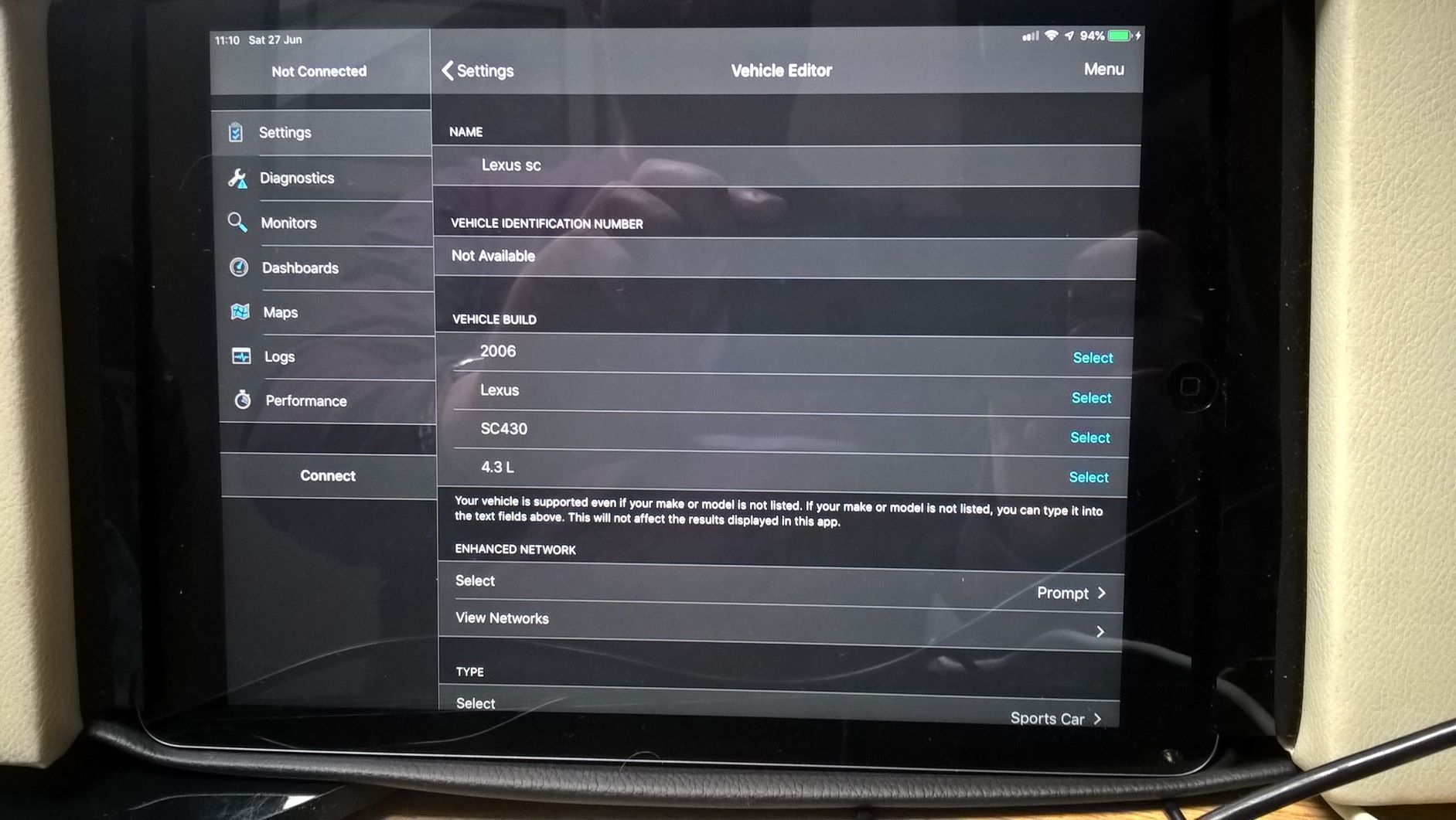

So this is the direction I've taken with the Ipad and an OBD2 bluetooth interface. The Ipad with a cellular service provides all of the 'delights' of the internet, it can mirror whatever I have loaded on an attached laptop using the duet app. Via bluetooth connection to a Scantool reader, (OBDlink MX) it can also display in (more or less) real time a selection of the cars sensor outputs by reading the Toyota PIDs.
The screen surround is a first draft to give me something to set it up with, I will improve it when I have a free day to create a better version but it's okay for now.
Standard navigation unit in situ
Navi removed, wood facia and air vents trimmed and removed
Ipad air2 with surround and USB cable in place.
Dashcommand app using obd2
dashcommand custom gauges from a distance
at night
Setting parameters
digital gauge readout using obdlinkMX from the US
checking on the forum in the rare hot English sun.

That is a really neat setup and I like they way you dressed it out to match your car. It has functionality and nice aesthetics.
Do you find you miss your A/C Vents? Being from Sunny Arizona, we kind of survive off A/C.
Old Aug 7, 2020 | 01:36 PM
Neil E's Avatar
Neil E
Joined: Apr 2008
Posts: 177
Likes: 86
From: W.Sussex UK
Personally I don't miss the vents at all.The car still maintains temperature with the roof on, even today, one of the hottest recorded days in the UK 36 degree C but sunny West Sussex isn't Arizona
Easiest thing to check by shutting your centre/center vents off for a while to judge if it's okay or not.
