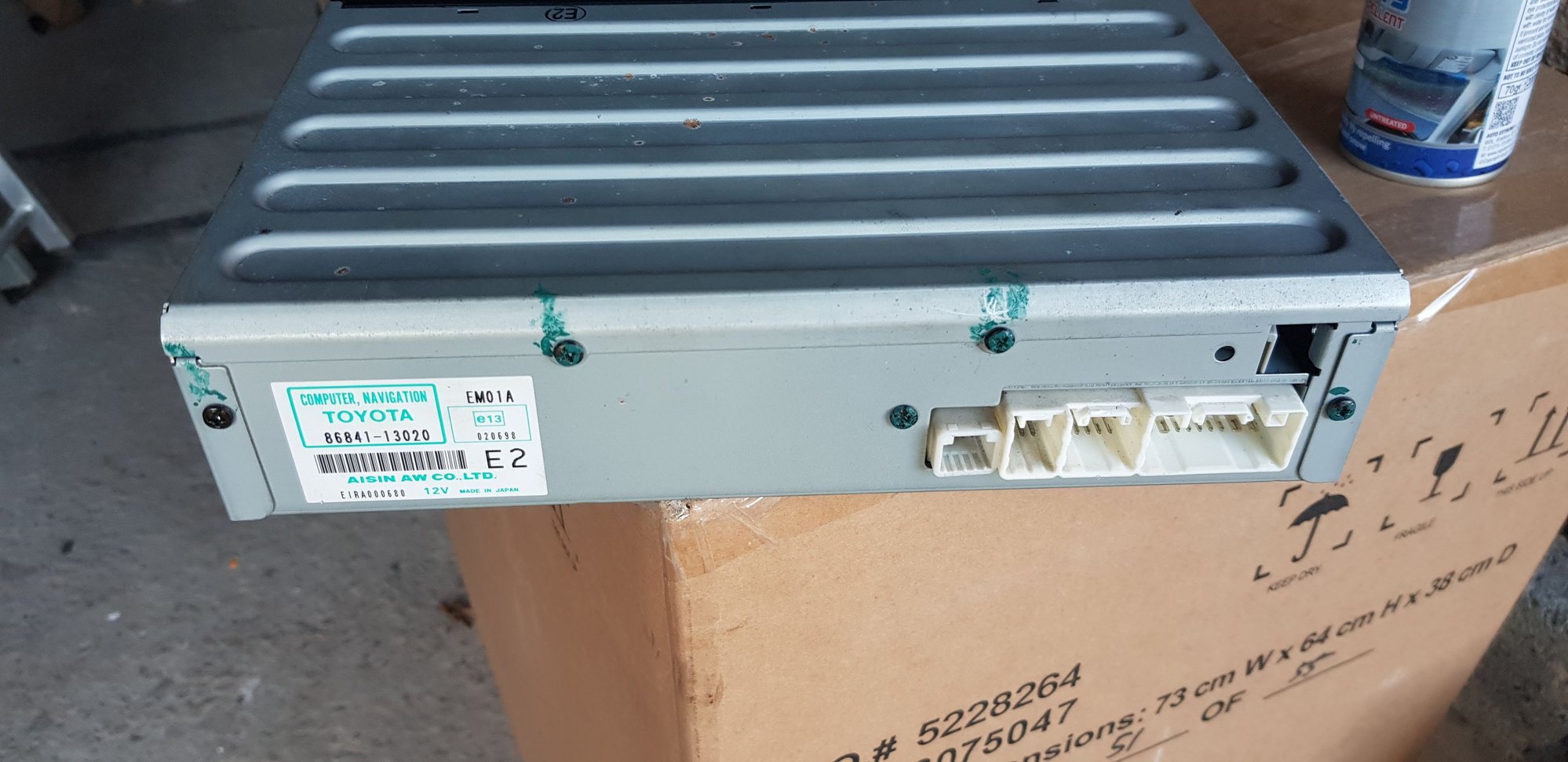

Muddy car photo!
This is the control unit was in the car.

Well I feel foolish. .... I failed to notice your UK location so the info I posted really doesn’t apply. It is for North American models of the SC430. There are different parts for the European models and different DVD maps disks too. https://www.lexus-mapupdates.eu
