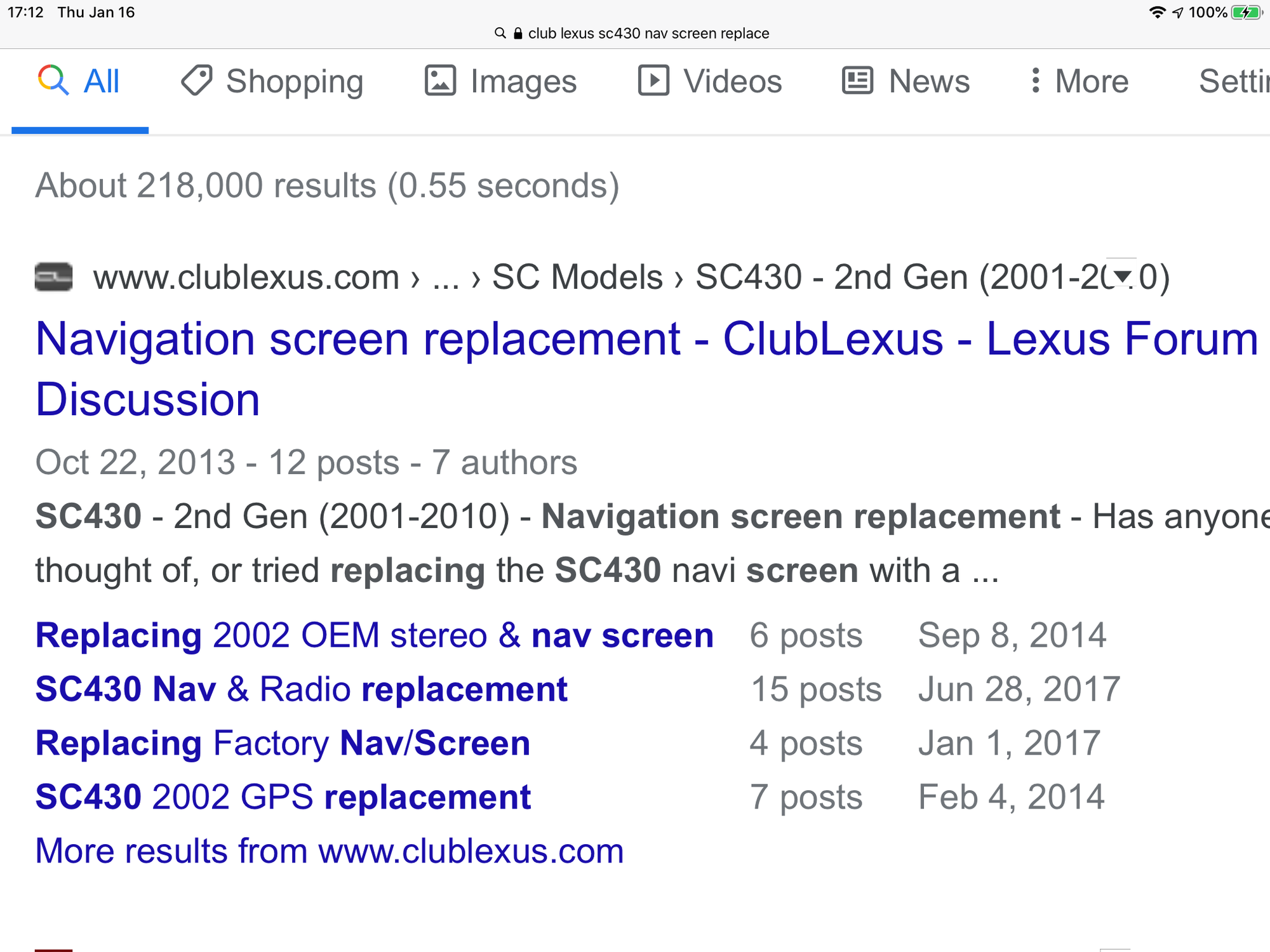

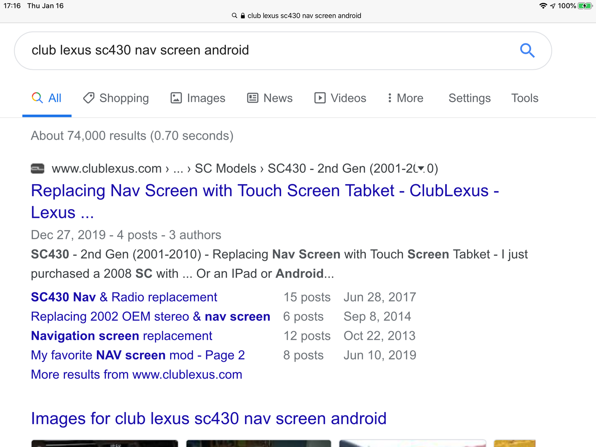

Google is another search engine trick I use... always start with “club lexus SC430” then the subject.
here is an example...then go back and modify the subject words based on what google finds...Google’s AI seems to know what you want, LoL
let us know how it goes or post something in one of the threads you find.
