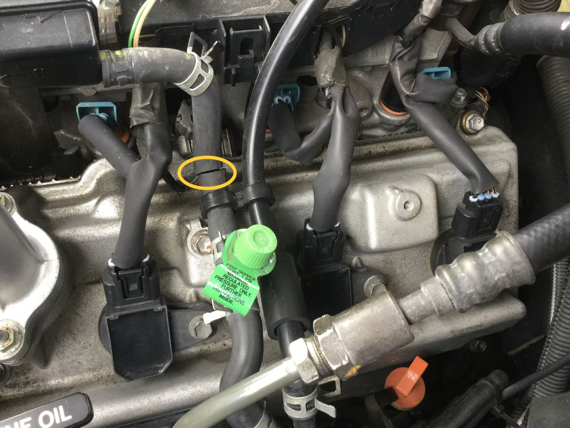

Originally Posted by DJWLDW
Well it turned out to be a vacuum line had come off. Plugged it back in and all lights went out. Out the dealership door for $139.00.
Dennis
sounds like the P0440, P0441, P0446 faults...Evap line.
BTW, when you visit again, check the vacuum lines for cracking...I just posted a pic of one that broke the other day and caused these codes.
here it is again...
also, these are the lines that usually come off.
