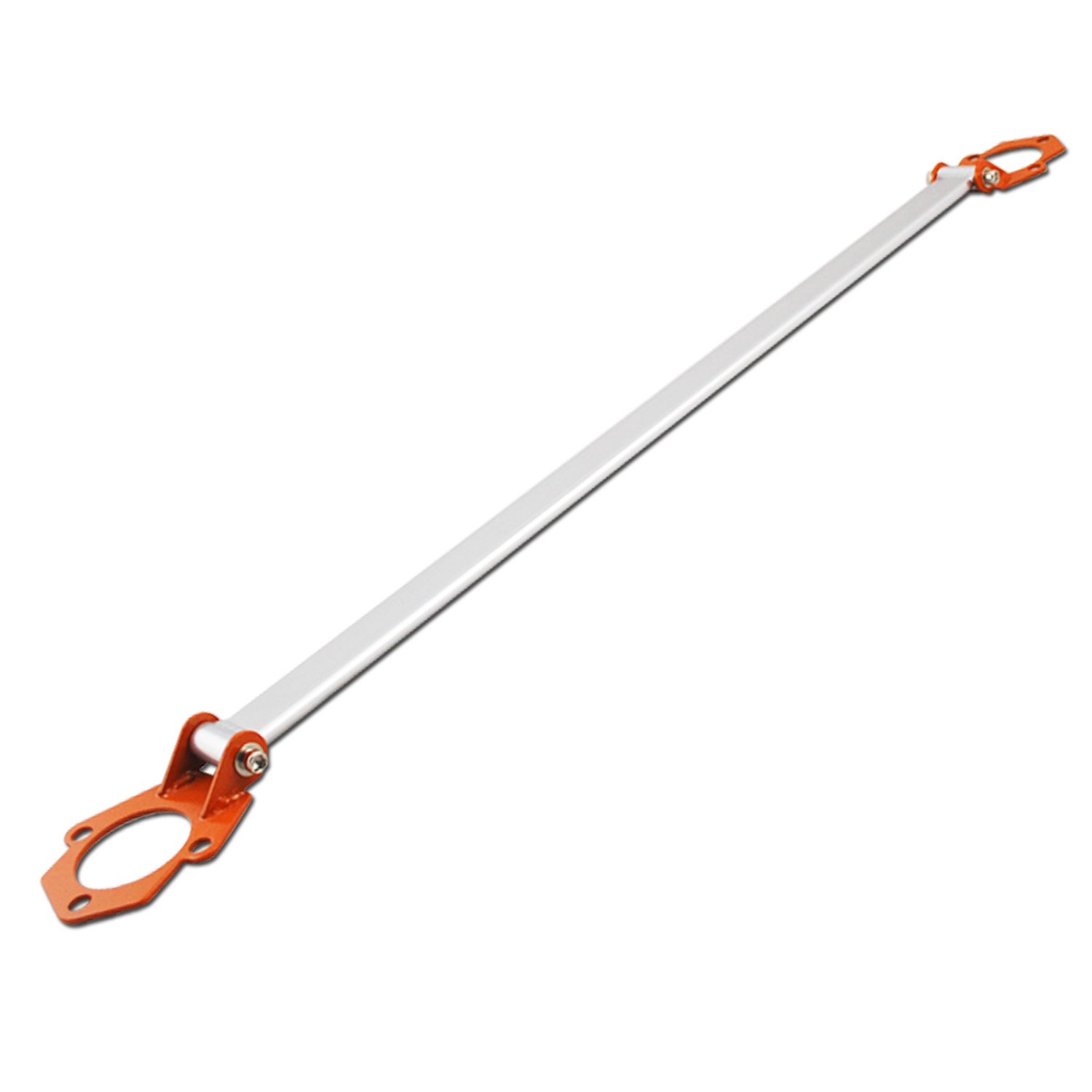

This is a TC Sportline REAR strut tower brace for the GS430.
First, a review of the bar. For a $45 STB it's fantastic (aside from being orange on the sides, but that's hidden anyway). Build quality is good, welds look nice, the fit and finish of the aluminum bar is pretty and wouldn't be an eyesore in the trunk. I was even thinking if it works out to just have "Lexus" engraved in the center or something like that. It's obviously not the same quality as my carbing front brace, but that brace is like $250.
It fits perfectly once the trunk liner is out of the way (I was thinking if I can make this work, to trim a small hole for the bar and use a grommet to make it look nice.
Ok, now to if it can stay:
You can see from the pic of the trunk cover that it sticks up what would presumably be too far.
I carefully had someone lower the top as I watched the back. The top closes, no sound of contact from what I could tell, reaching my fingers in, there's probably a few mm of space between the bar and the window (not enough for fingers). When I put it back up, you can see there is a thin line of dust removed from where the window touched the now-raised trunk cover. Note: It's the thin lines of dust missing, not the big smudge, that was my finger.
I'm pretty sure this won't do... I don't know if the top moves at all with bumps or anything, but it's a little nerve wracking without knowing for sure.

Do you understand how expensive and complicated it is to fix the sliding roof. So when the car flexes, and it will, no matter what they claim, and damages the mechanism so it won’t close you’ll have a tarp at the ready for the inevitable rainstorm, right?
Not trying to be Debbie downer on your dreams, just keeping it the realm of reality. Makes me wonder why one was never engineered for the SC.

I’m very interested in this mod. I just finished installing a front cusco strut brace and the difference is dramatic. The front end is so well supported that now the back feels like a wet noodle. I never would’ve guessed the rear was so flimsy. A rear STB is needed, I think. And for such a low price, why not?
There are risks involved but this isn’t rocket science and we can find a way. I’ll be placing the order tonight for the rear STB.

That's a Cusco Type OS bar - #187541A. I'd like to see a real pic of it and not a stock photo. This looks like they used the pic of a front bar, i'm not convinced the rear bar has the bent bar. But you get the idea.
Does anyone understand physics enough to know what affect, if any, flipping the bar would have?

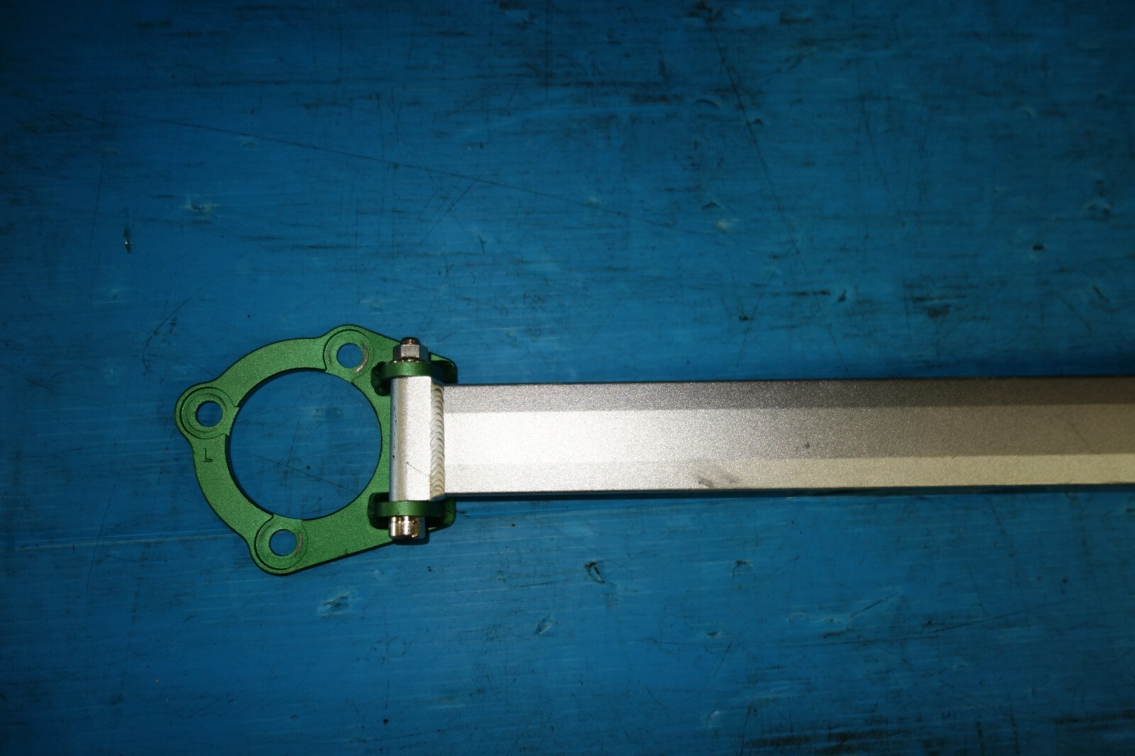

The Tein bar looks pretty compact, but that could also be an optical illusion because the bar sits back further on top of the mounts.

Reply from Tein:
I will have to measure from the flat portion of the mount on the TCS one and see if there's a difference.
Hello Joe,
Thank you for your interest in TEIN High Performance Suspension
products. The overall height is 39mm from the flat portion of the mount
to the bolt flange of the tower bar.

I measured the TCS bar and it's about the same height as the TEIN bar... so there wouldn't be any meaningful clearance increase. Just l33t JDM points for having something TEIN on your car
