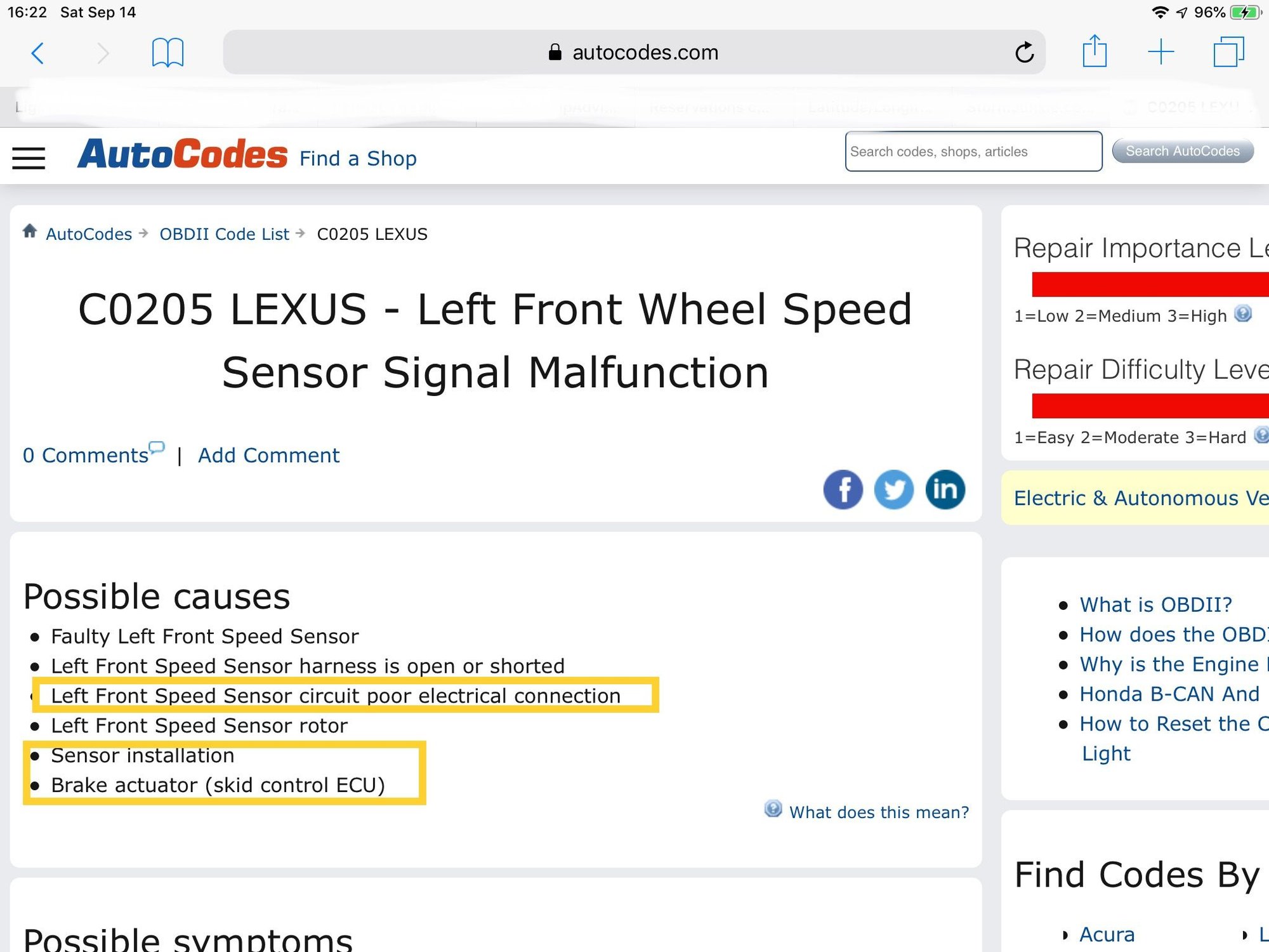

check out this link...
https://www.autocodes.com/c1236_lexus.html
