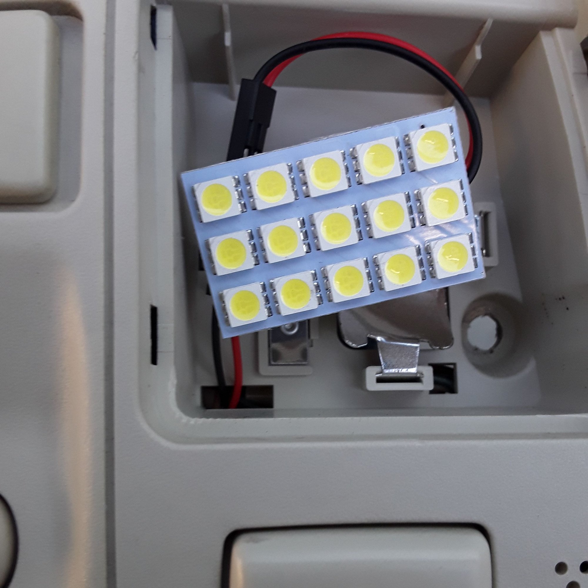

Here's a photo of mine. Red to green was positive, black to top brown wire on each map switch. Soldered connections.

Forgot to say had to solder in connection instead of using the bulb adapters included because light had failure/loose connection @ the metal rivet that goes thru plastic housing and makes pressure connection to the green crimped wire end. I cut off the end of one of the led bulb adapter and used that so the end that sticks into the bulb location will have the correct end to unplug/replace if bulb ever fails/needs replacement'
