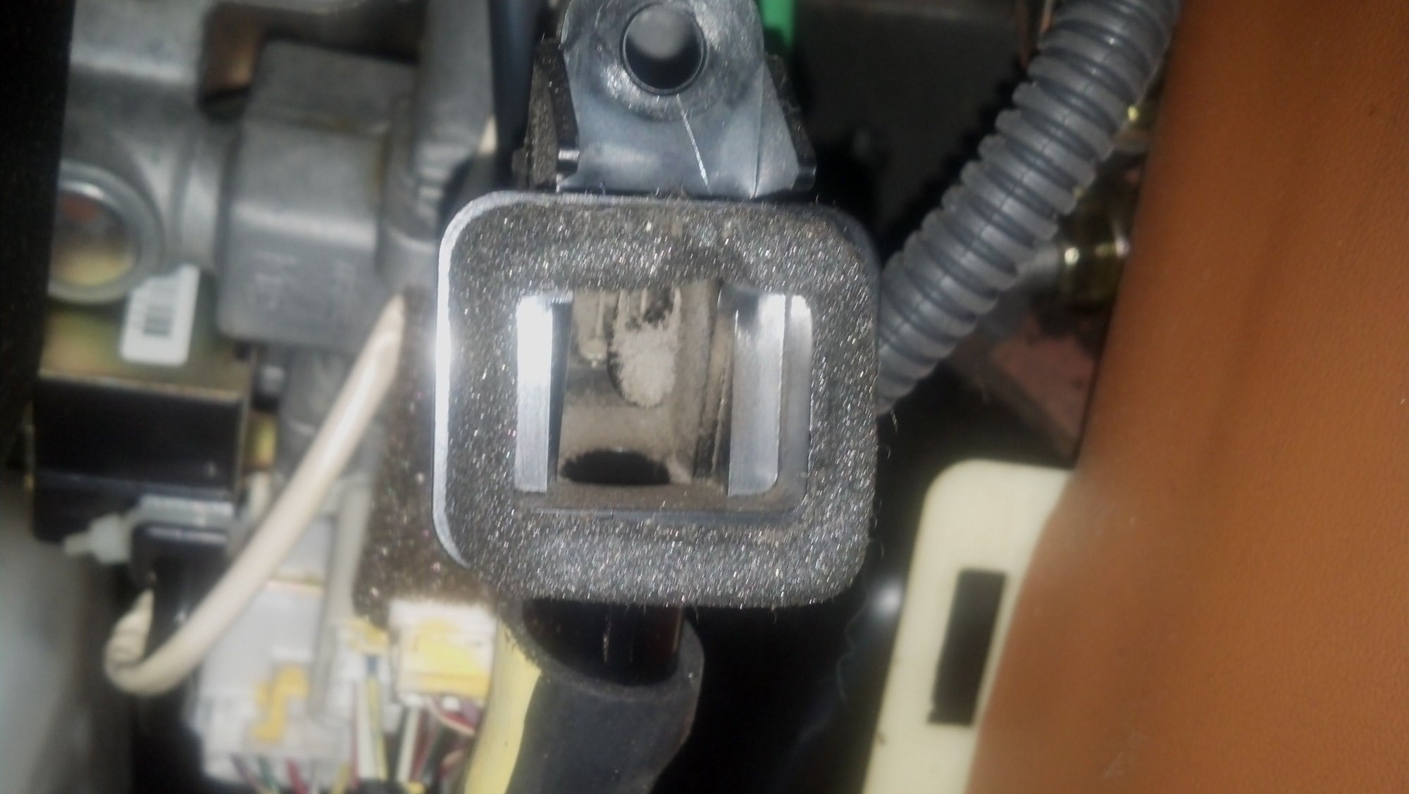

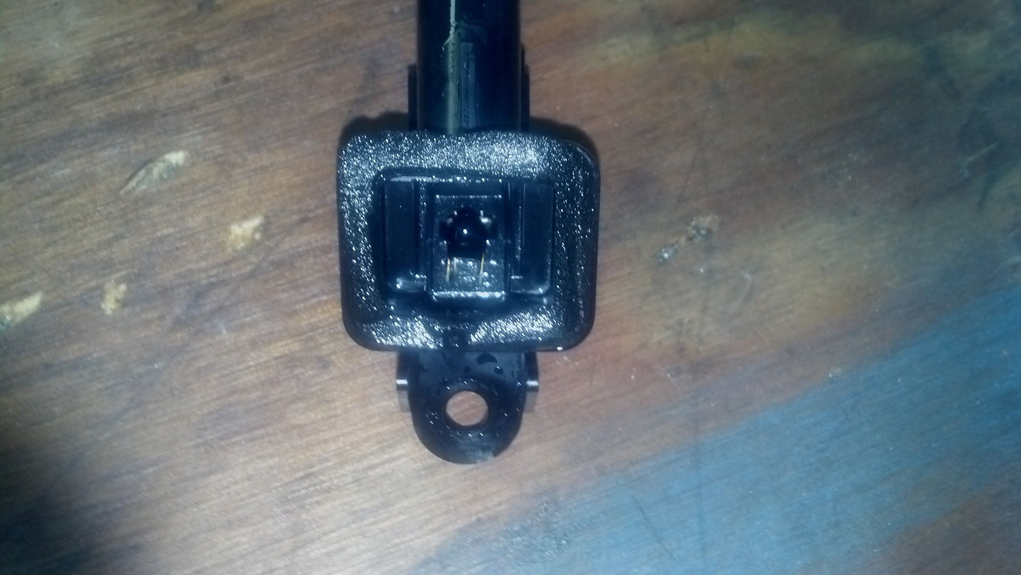

Here are two pics of the sensor which is located just above the drivers right thigh. You will need to remove three bolts on the lower panel which will then give you access.
Dirty...
Clean and still wet. Yes I used water. It will not hurt it.
Dirty...
Just to be safe, you should use electronics / MAF cleaner. Do you MAF too since you bought the can
It is a sealed sensor, but if it makes you feel better use the Mass Airflow Sensor cleaner. I live in Florida with plenty of moisture in the air...the sensor gets wet.
