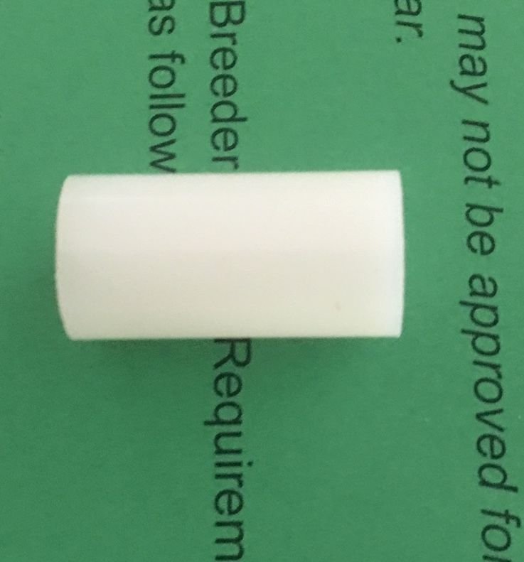

Originally Posted by digitatc
Please let us know how it goes. Obviously, plastic is much easier to cut than steel. I got a steel sleeve and still figuring which is the best way to cut it.
  1. Mark your 6mm section lengths on your sleeve bar. Obviously you'll need two.
  2. Place the hollow bar in a vise so about 10mm or so sticks out so it can be cut easily
  3. Use a hacksaw or a motorized equivalent mini-cutter
  4. After the first piece is cut, loosen the vise, feed the bar out, tighten, and repeat the procedure.
Does this make sense? You may want to take a file or equivalent to smooth any burrs.
Consider that the sleeve should not really need any special adhesive to hold it in the 13mm bar hole, as that is taken care of as the link nut is torqued down. Both sides drawn together will press the sleeve into place. Or am I wrong.?

Default Update on ISF Rear Sway bar install stock suspension
I had the ISF rear sway bar installed along with new ISF bushings, and new stock SC430 MOOG Sway bar links. The issue was the sleeve that goes into the ISF bar. It was child's play, or a doddle for our UK friends. The install tech agree with the speed shop when he installed the plastic sleeve - he said it would last as long as the new bar links.
The tech measured inside the ISF bar hole, marked, and then cut to length as the procedure above. Afterwards he took some sandpaper to square it and smooth it. It was about 6mm or 3/8s of an inch long.
The link bolt fit perfectly inside. The taupe object behind it is part of the ride height sensor assembly.Its subsystem comprises an arm with a bolt that attached the lower part of the SB Link. BTW unfastening this is NOT mentioned in the Service Manual I have. SB links in the rear are not keyed to the side as are the fronts.
The SW bushings were a tight fit on the bar and chassis so we lubricated them with some tire dressing. We kept the stock SC 430 brackets.
