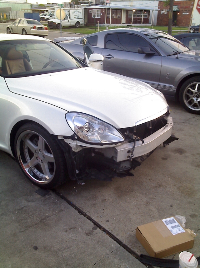

You cant swap the motors. I ended up doing what Ken said plugging in the old motors and pull tie it in place to leave the system in loop so the light on the dash stays off. I hope its just a temp fix untill I can get the right parts from Japan.If i had my aero and 20" id take some more pics
