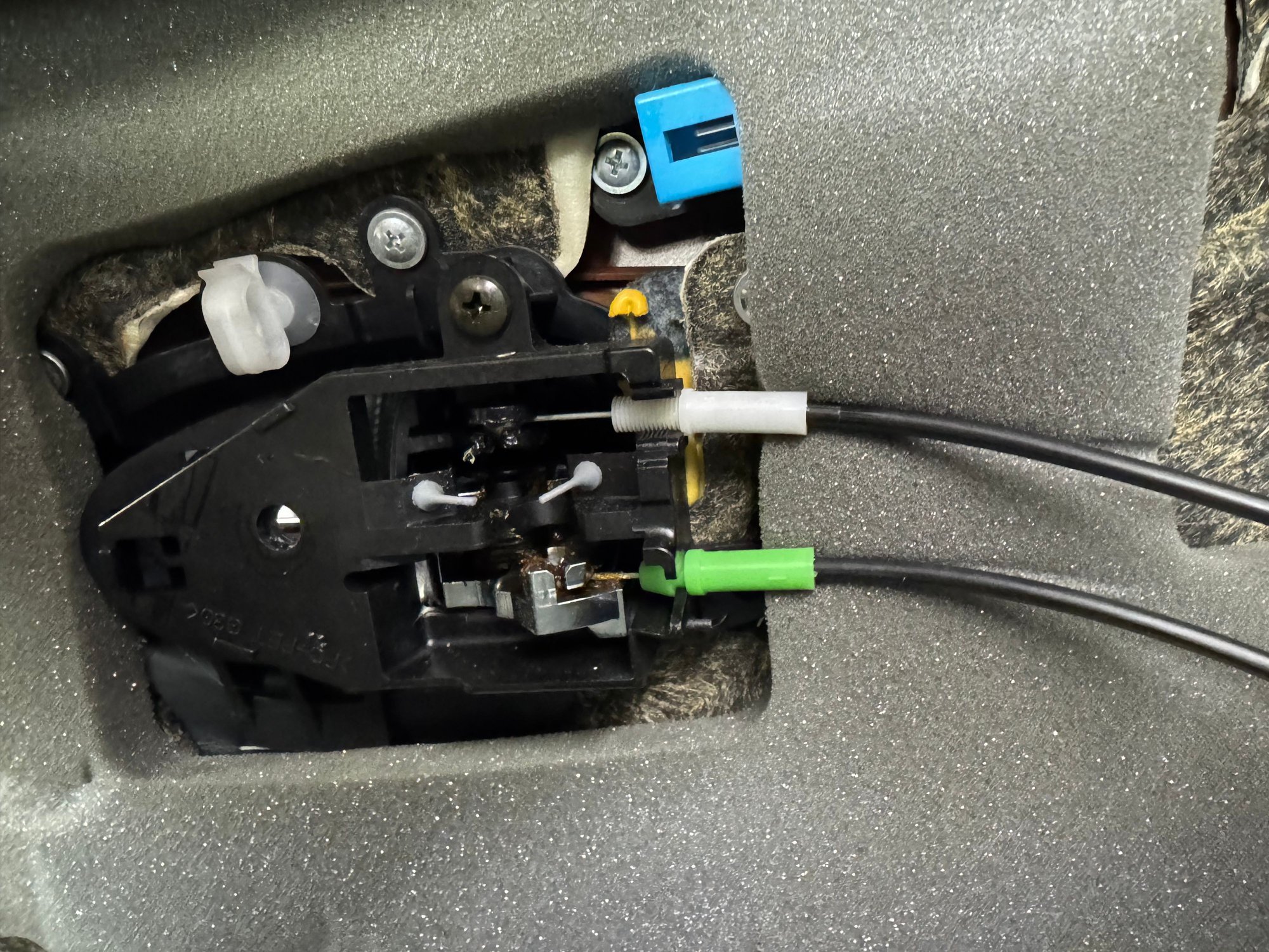

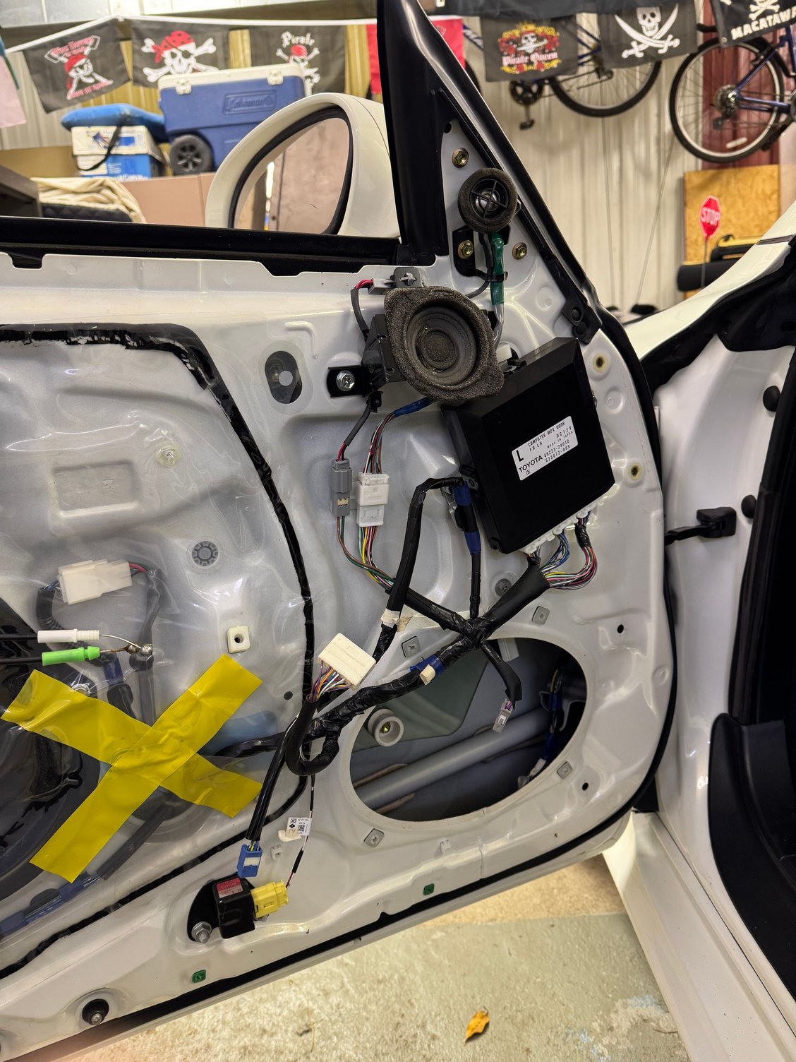

See these photos I took when I refoamed my speakers last winter. I believe it shows what was described in the previous post
Loose cables after taking off door panel
Photo of cables attaching to back side of door panel handle assembly.
Photo of cables attaching to back side of door panel handle assembly. I took the photo to have a record of how I needed to reassemble them.

thanks for all the replies with link and pics. My cables looks normal and attached properly. My guess is the top cable with the white plastic maybe broken at the actuator end. Will have to take it apart when I have time and take a look. I read on another thread somewhere that they took the cable to a bike shop and had one made.
