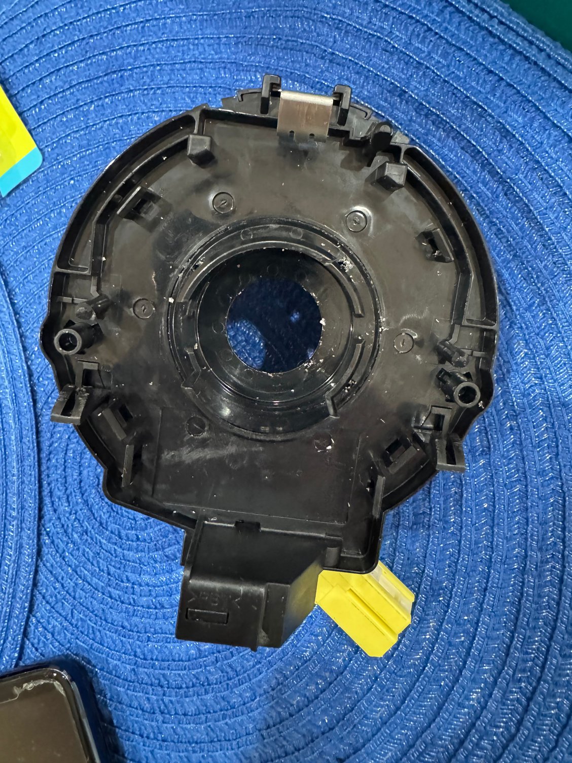

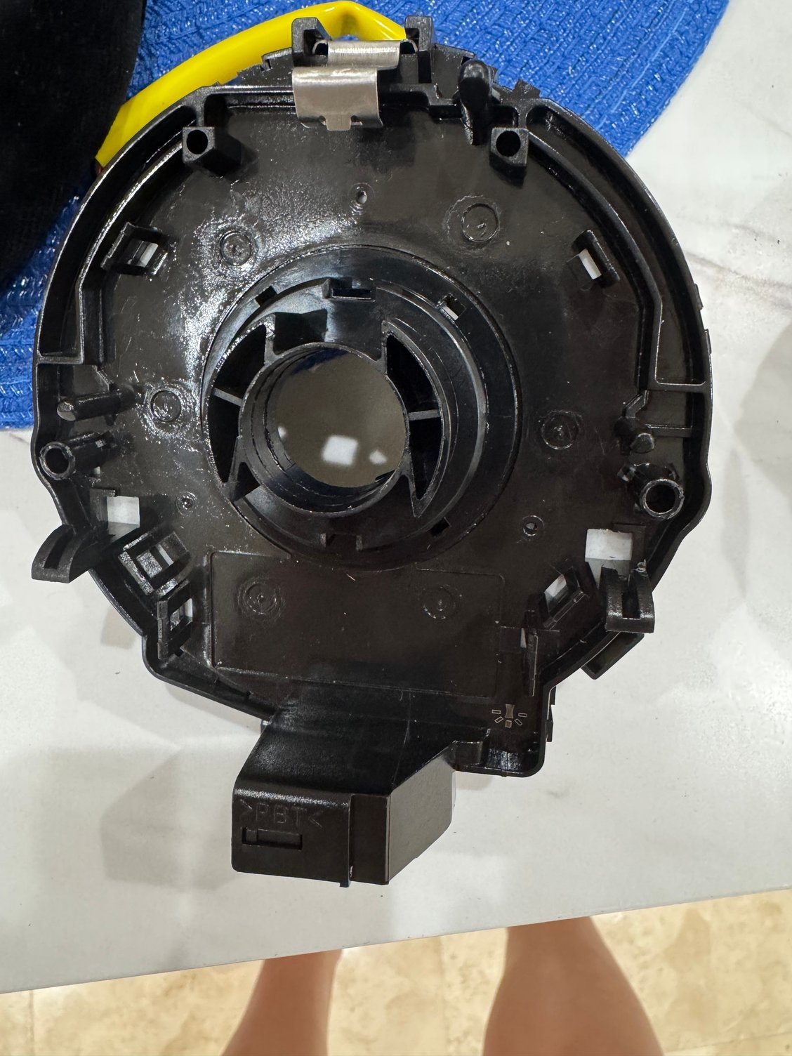

Wish I had found this thread earlier. Clock springs sold on eBay have the wrong connector. Cars built prior to 08/06 require 84306-24080 and clockspringexperts.com's replacement with the same number has correct wiring but collar does not fit over steering column. Mine was built 02/06 so be cautious not all Lexus parts vendors know this. Many Lexus dealers believe the correct part is 5130 it replaced 2480 but will not fit the earlier cars. Very confusing and totally frustrating but the only option seems to be OEM part from Lexus. I hope this saves someone else's weeks of frustration and hours of fiddling and searching. BTW I am still waiting for the right part so I am unable to completely verify what has been posted and my research. I will update when I hopefully get mine back together and functioning. PS The metal filings are from having to drill out and Helicoil the threads. Even with a steering wheel puller the original threads just gave out. These wheels after so many years can be a bear to remove. I've replaced wheels on many of my Porsches and even 50 year old Panteras but this was a doozy!
What was on sc430
What was on sc430
Clockspringexpert replacement
2480 for cars built prior to 08/06
