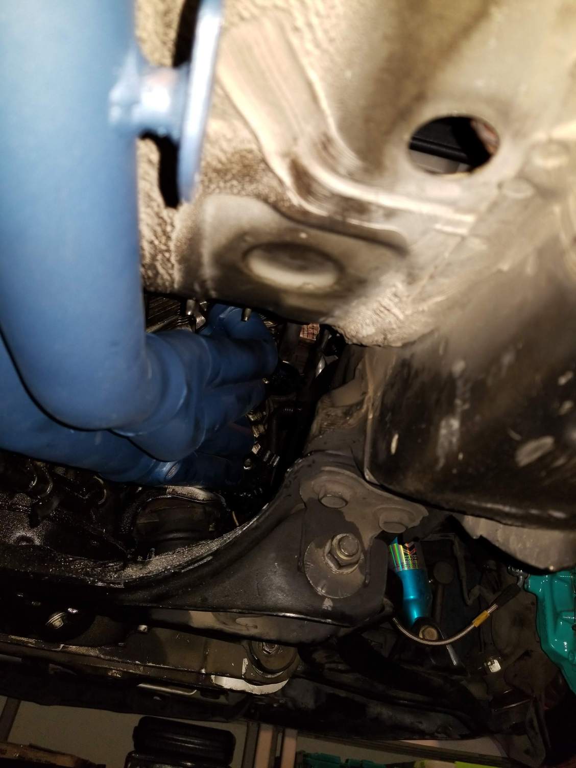

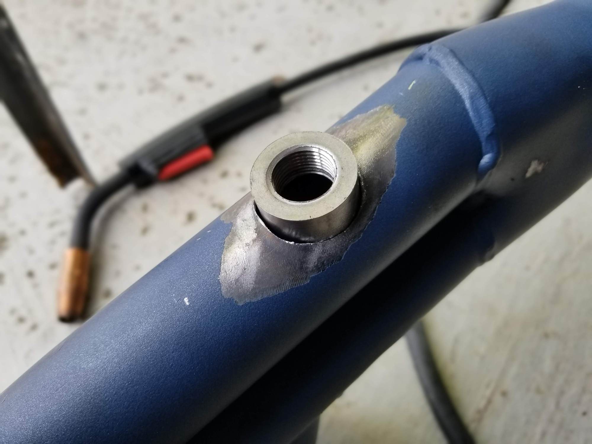

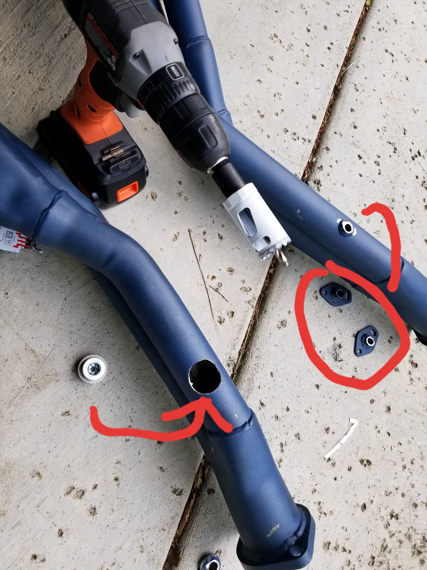

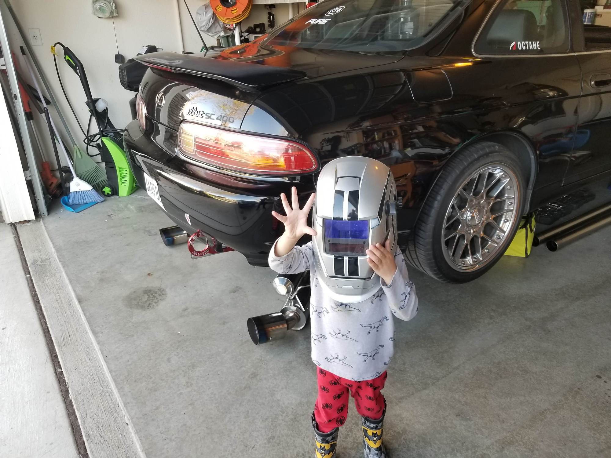

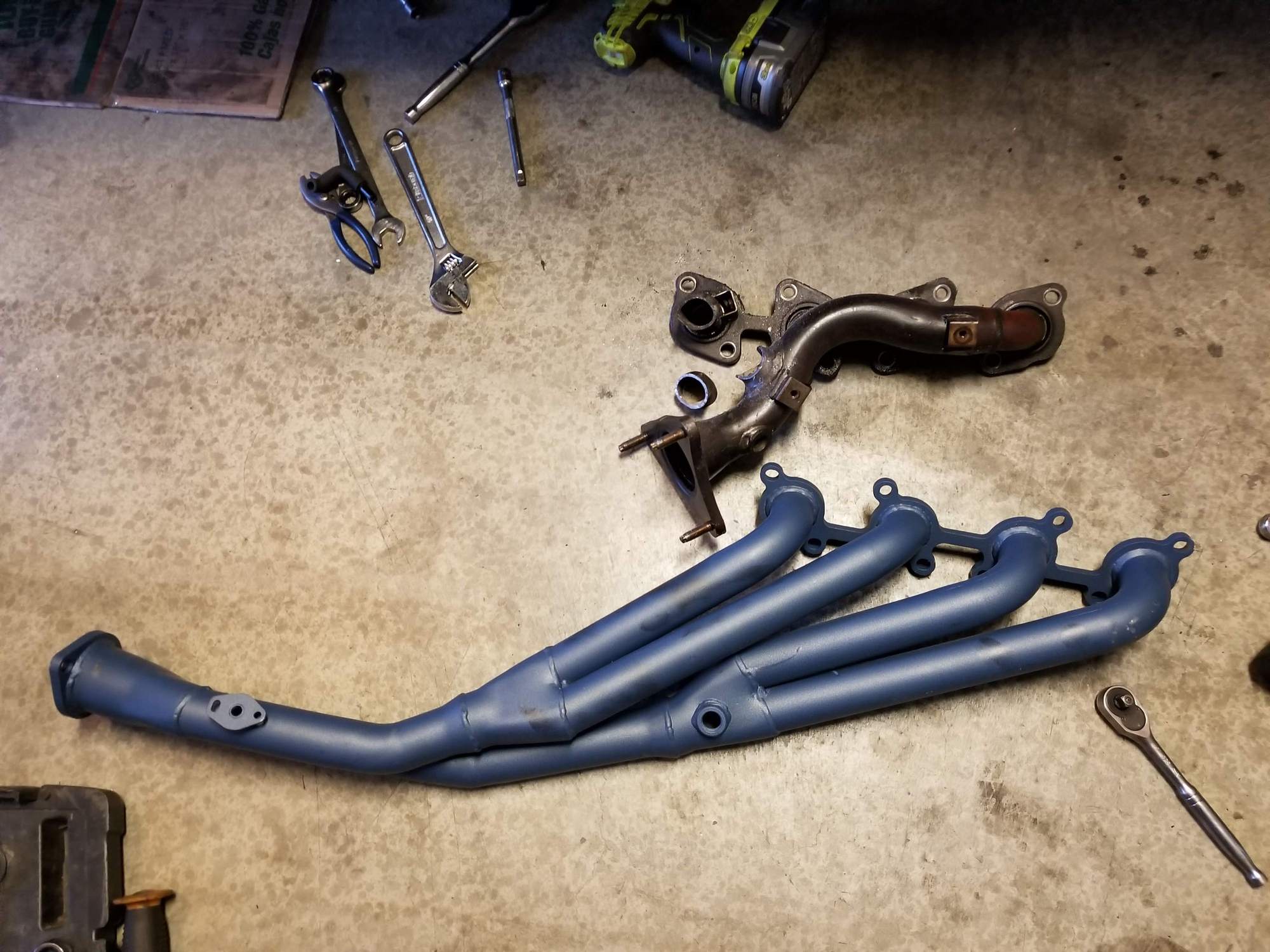

This was the process of my long tube headers from hurricane and custom exhaust build. I hired an apprentice and he was pretty affordable, he accepted payments in candy and other snacks lol
The O2 bung provided didnt fit my factory threaded type.
The easiest way would have been to block these off and weld in a new set of bung at the beginning of the X pipe section but i already cut new holes by the time i thought of it and it was too late 😢

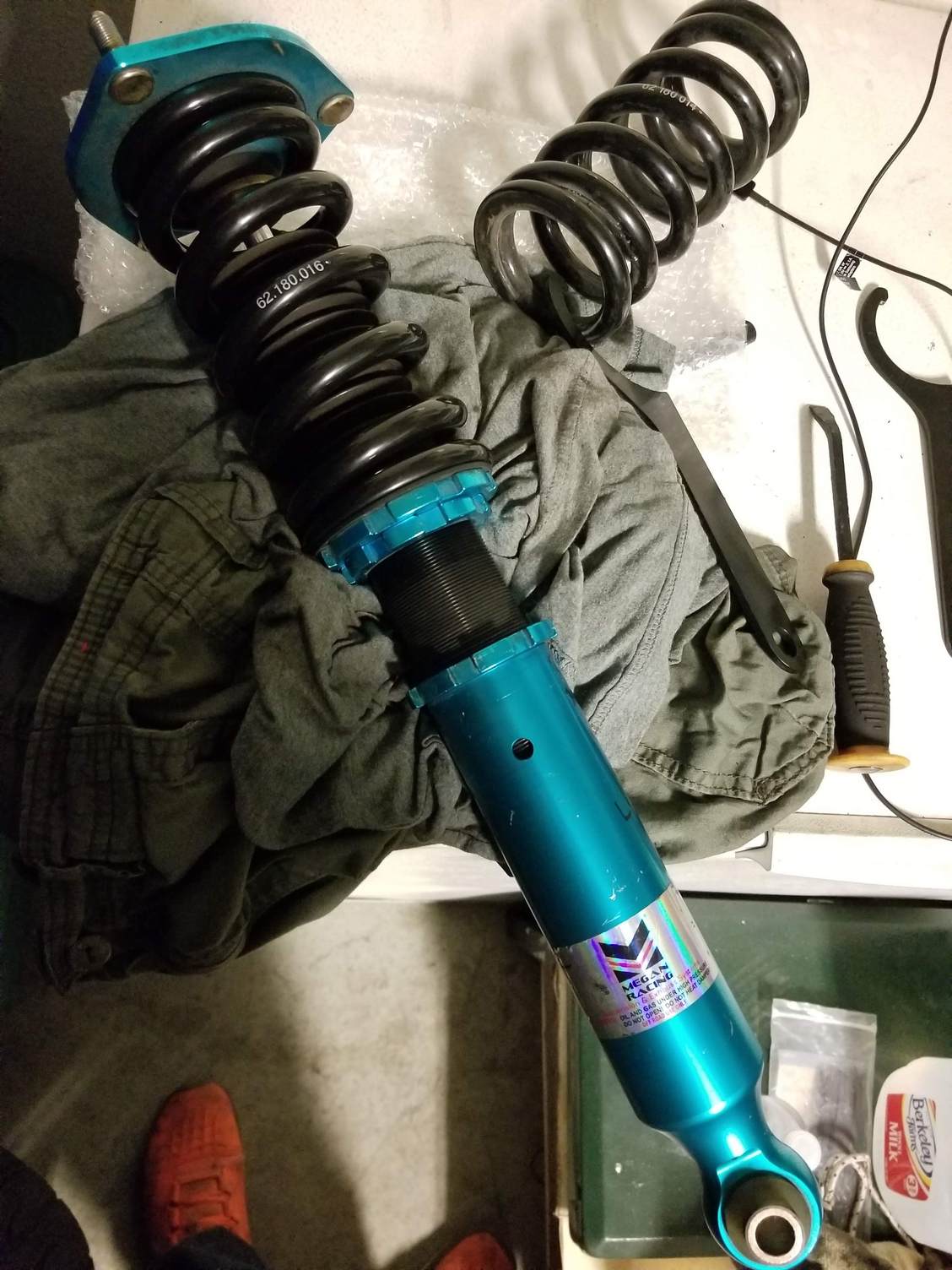

Megan racing ez2 coilovers originally came with 14kg front and 10kg rear for spring rates. They are able to go 2kg+/- without needing to be revalved so i went ahead and got stiffer spring rates to make the setup a bit more aggressive. 16kg front and 12kg rear also went polyurethane mounts from Xcessive

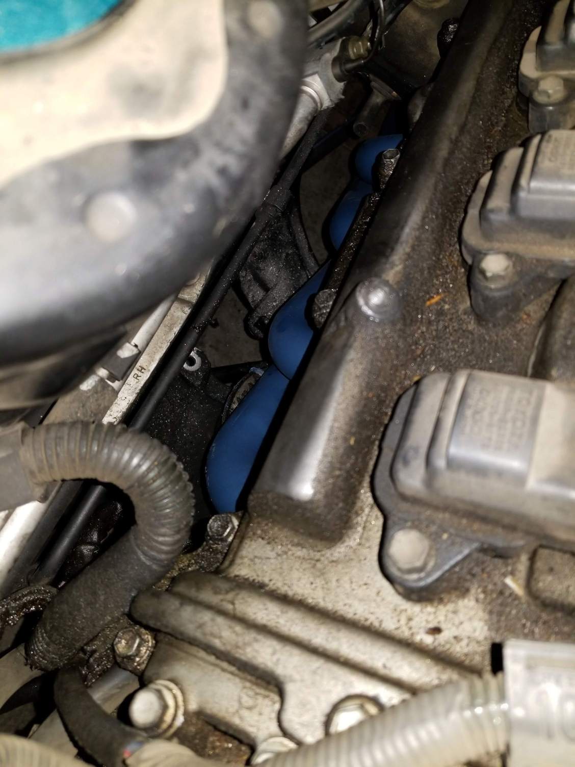

Got tired of the CEL so i installed the fouler. Shiuld have done this from the start

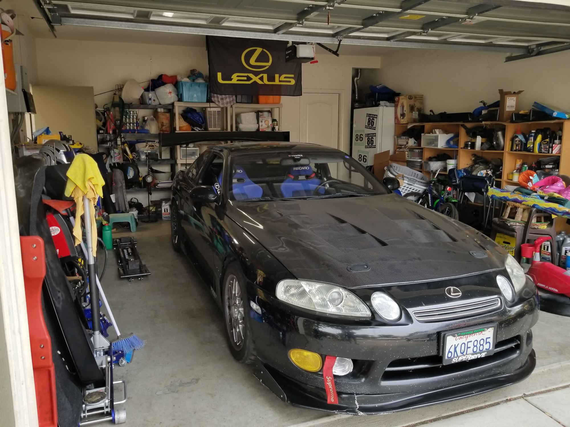

Couldn't find the Fujin Lip, settled for the KBD one instead.
Big Country Labs 1850mm atmospheric demolisher carbon fiber wing for the sc400
Yeah it's a big ****!
Looks like it belongs on there. Install was straight forward. Their mounts aren't the best design but it does it's job.

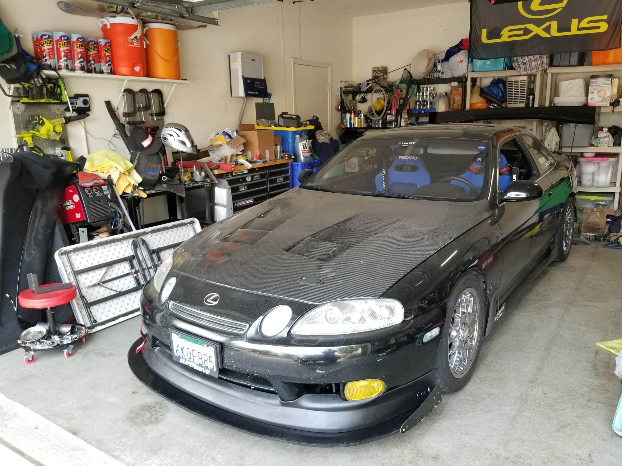

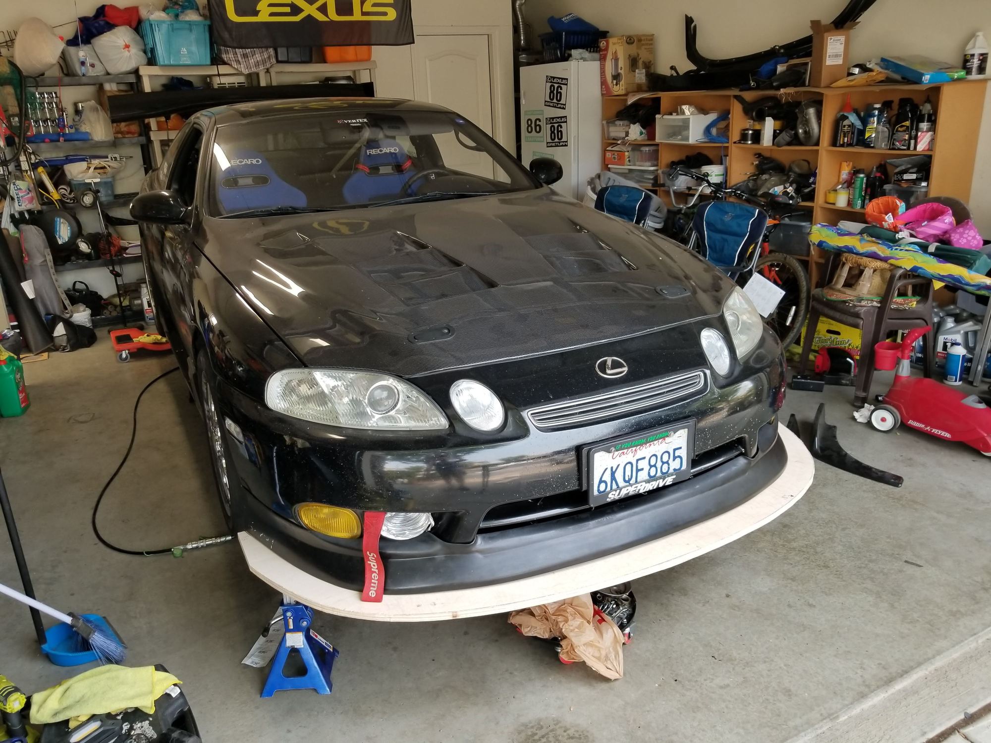

Sc400 front splitter diy since it doesn't have any available off the shelf.
Cooling cutouts
Cut out for oil change service
About 21lbs total, eventually I will re-make the front splitter out of something more lightweight but this will serve it's purpose for now.

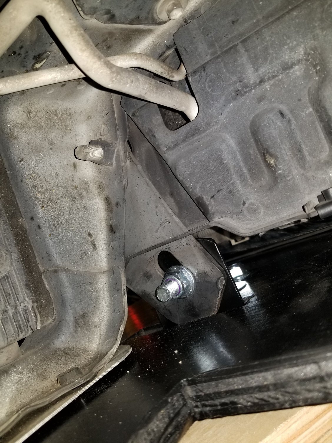

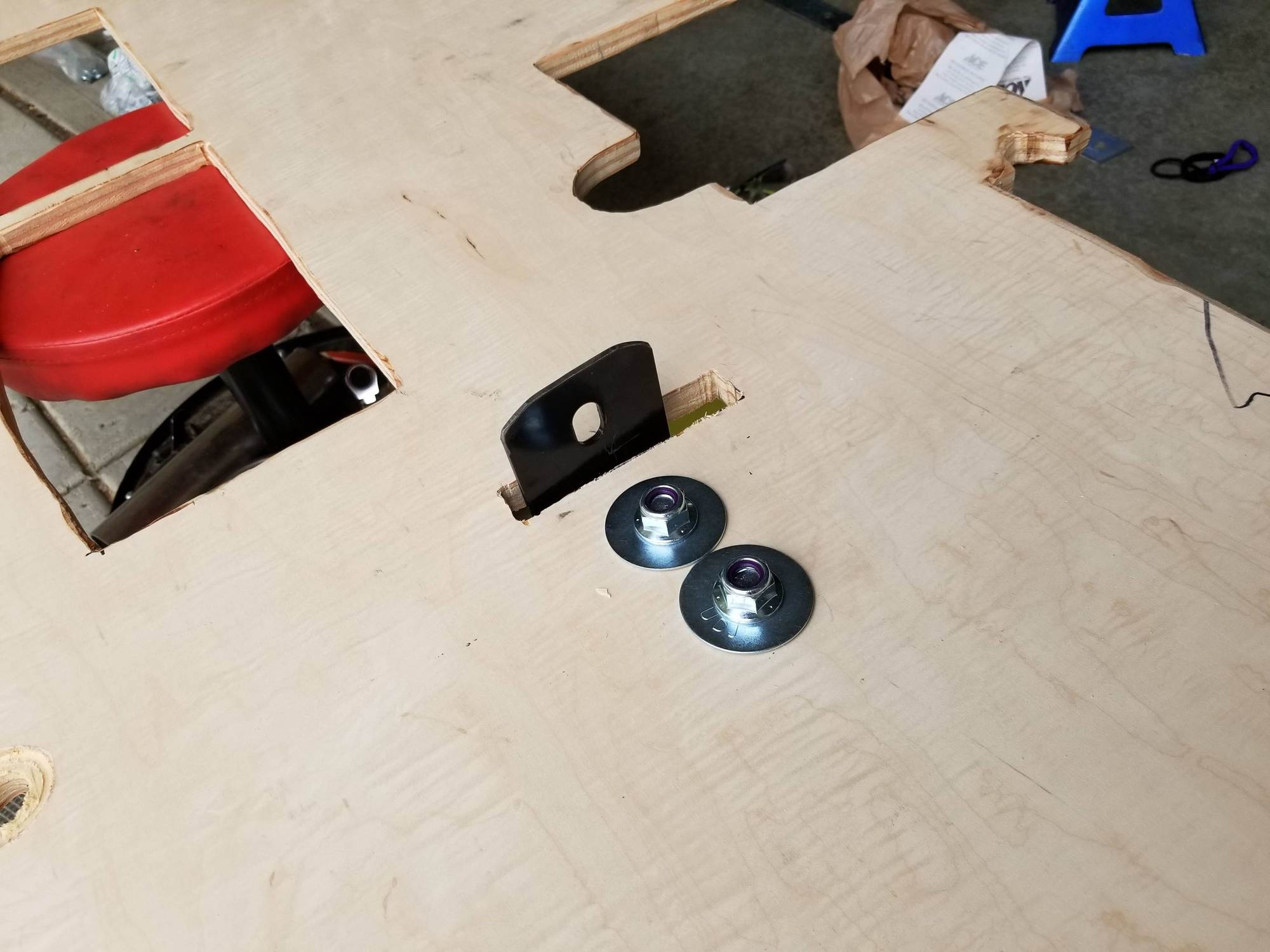

Hardware for chassis mount setup
Nylon Nuts works wonders
It's business time.
Front splitter Painted and sealed and ready to be installed onto the sc400
Chassis mounted splitter to tow points
Endplates from old ridox style lip was re-used for new splitter.
Looks meaner now. I present to you all, sc400 with front custom splitter. Time to go hit the track!

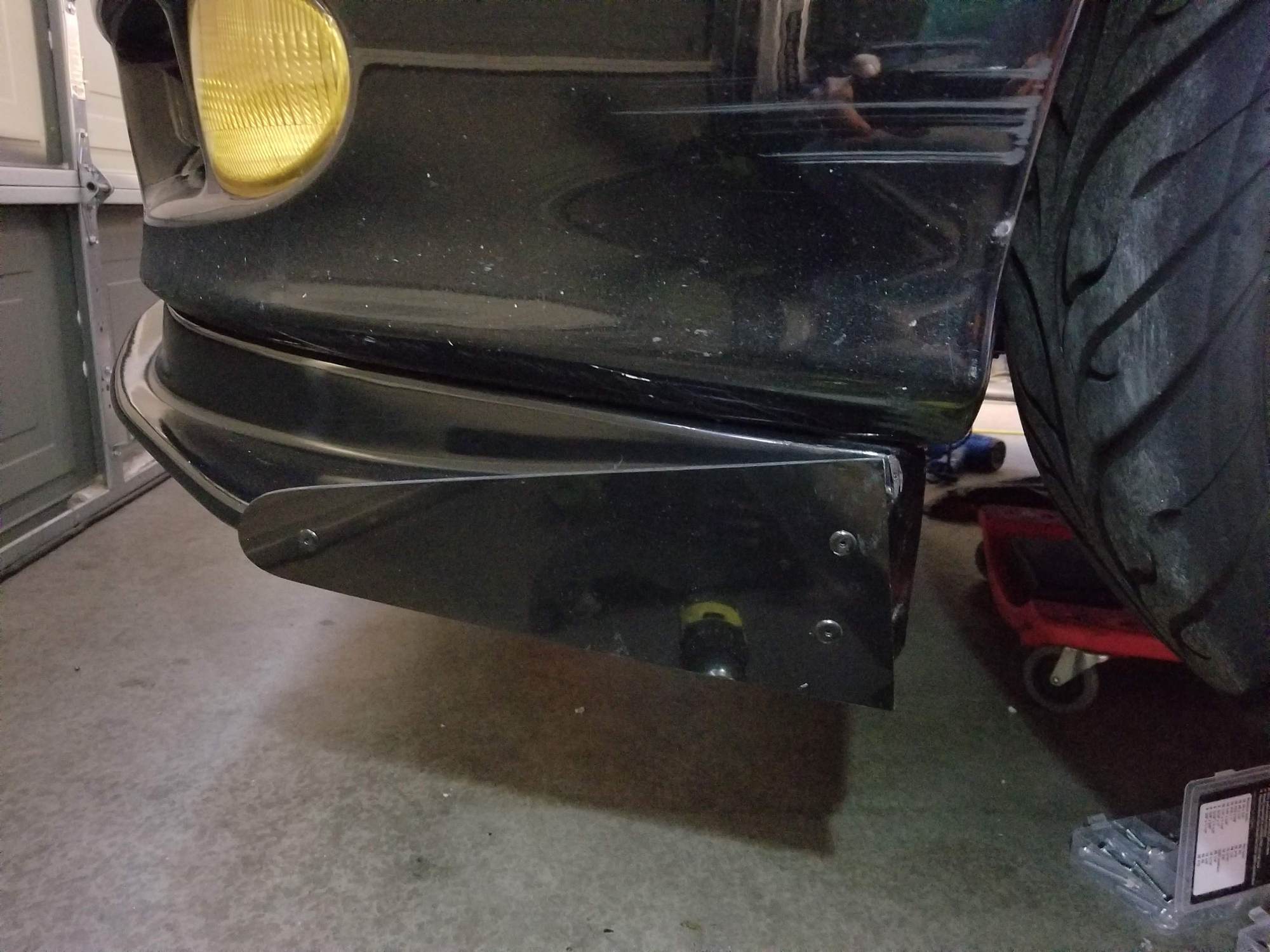

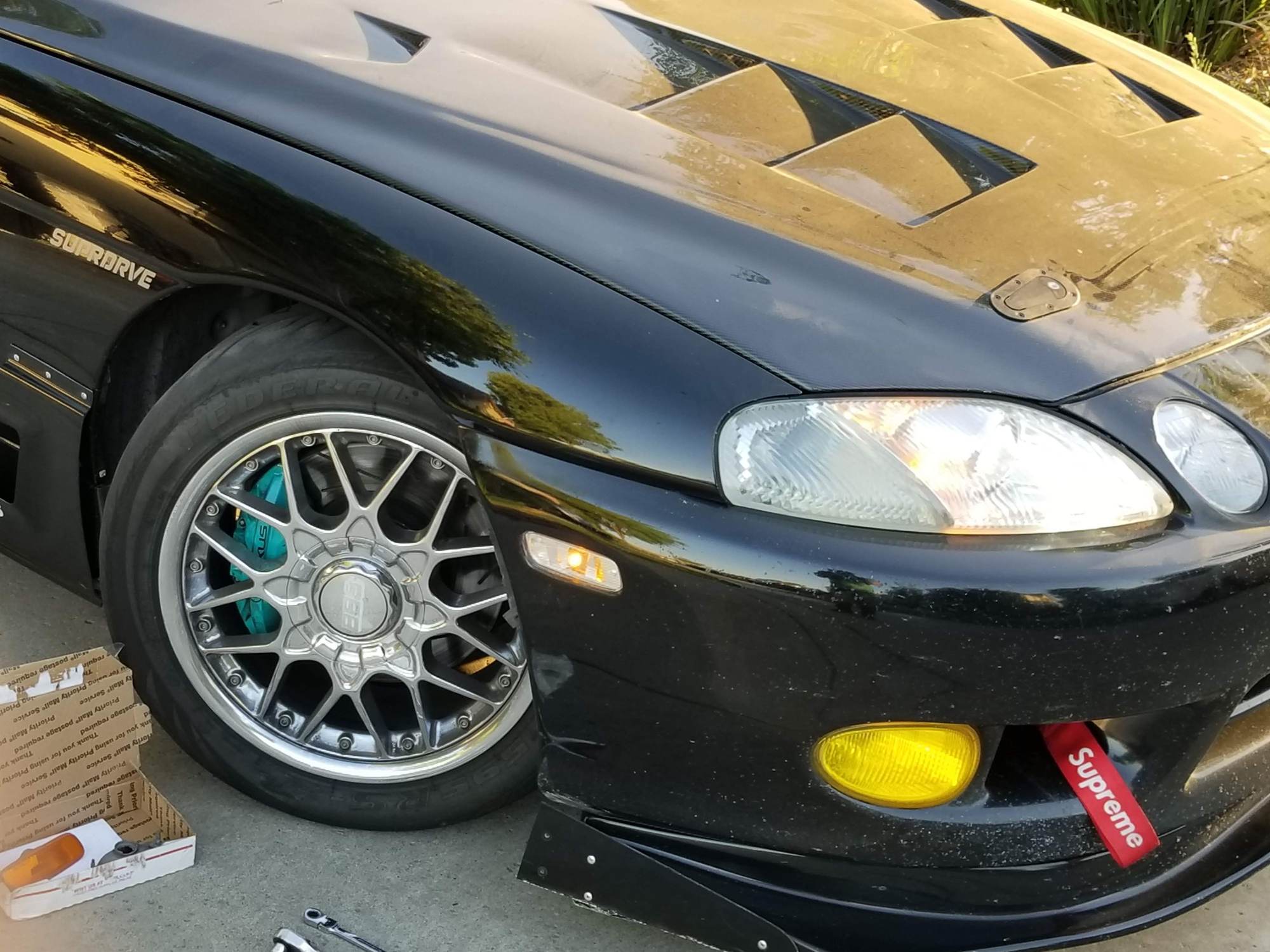

Squared up the endplates. It sat a little to low on the front angle.
