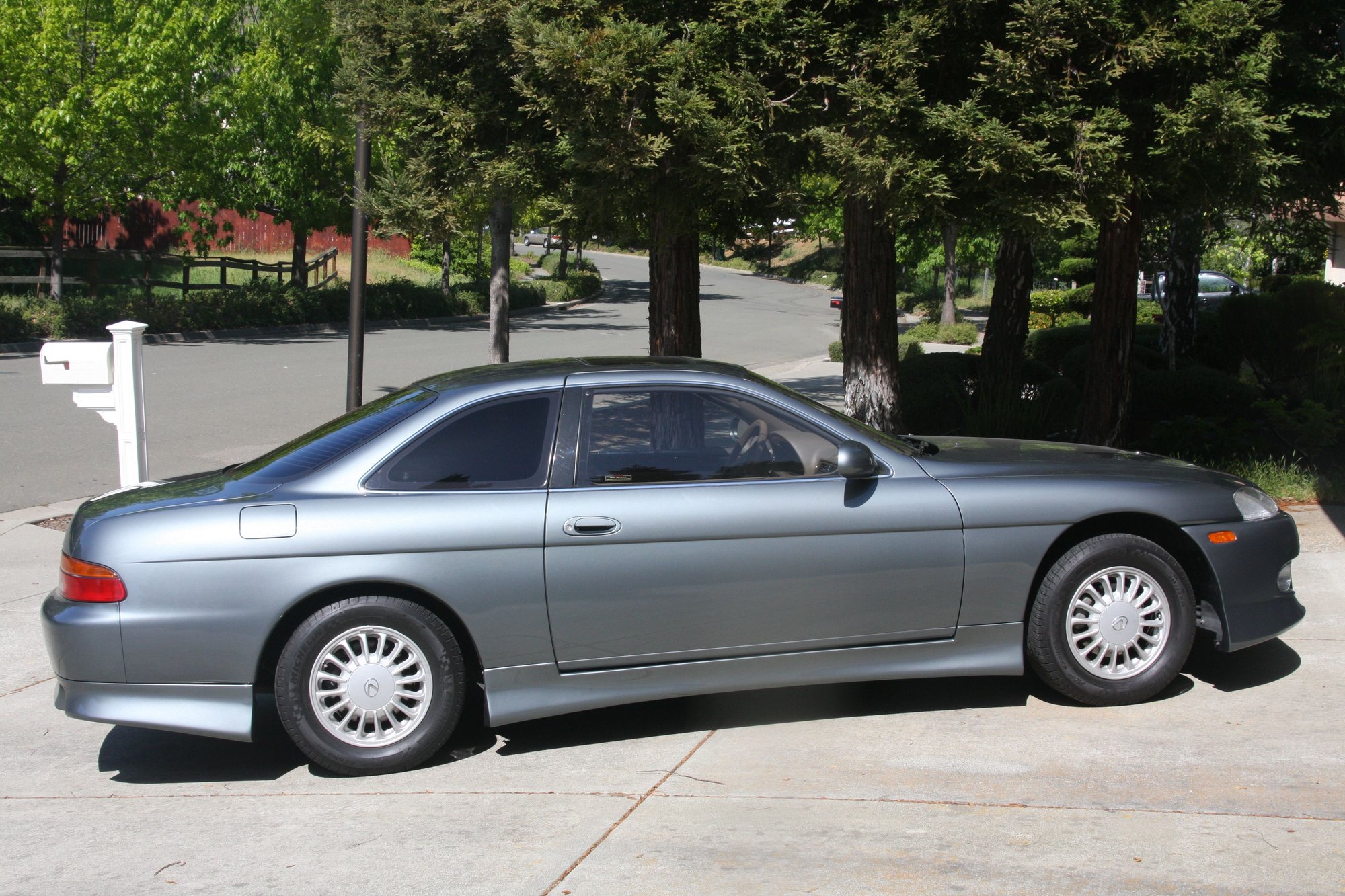

Starting point; stock.

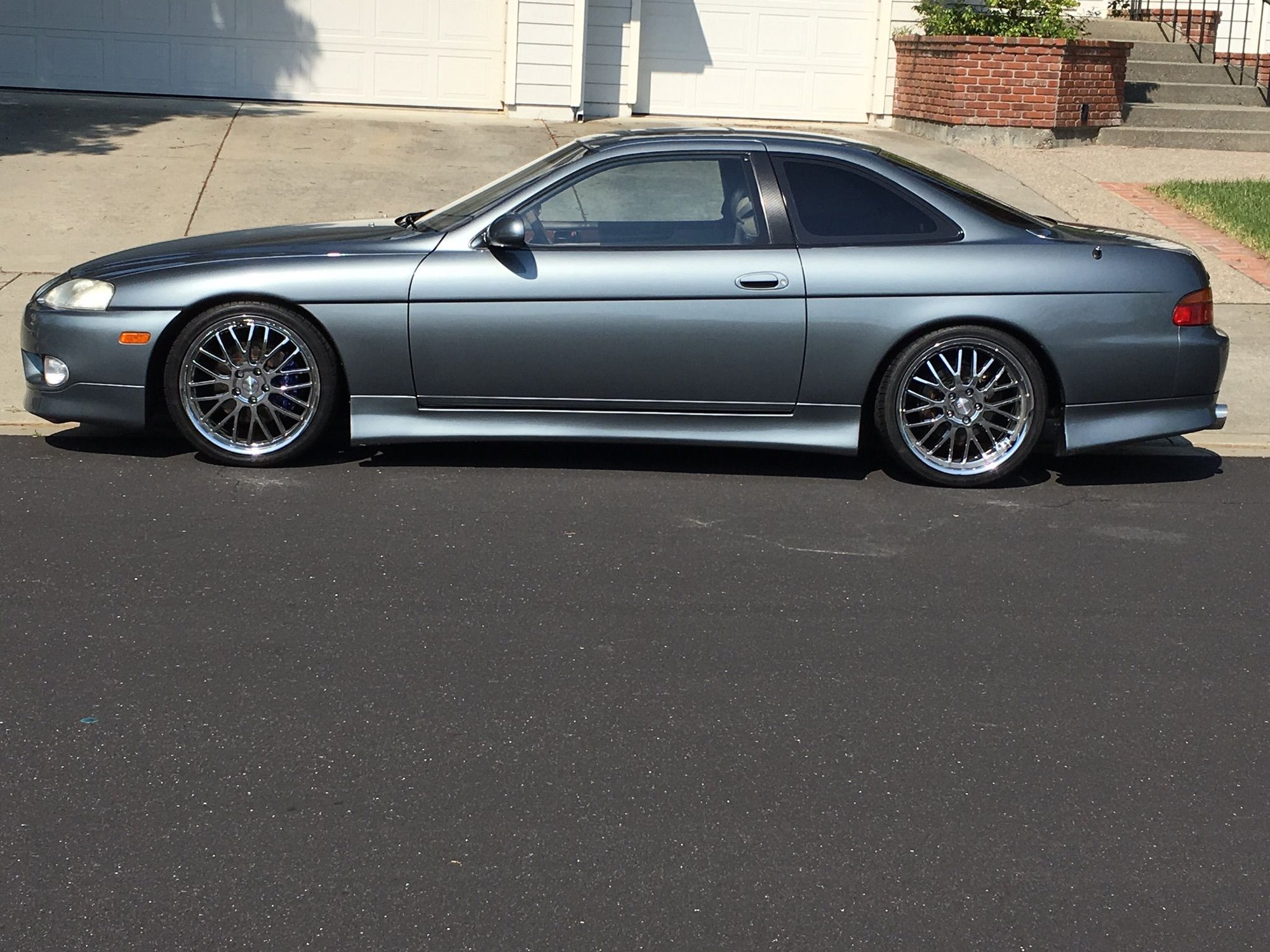

After the coil overs.
With wheels and tires.
