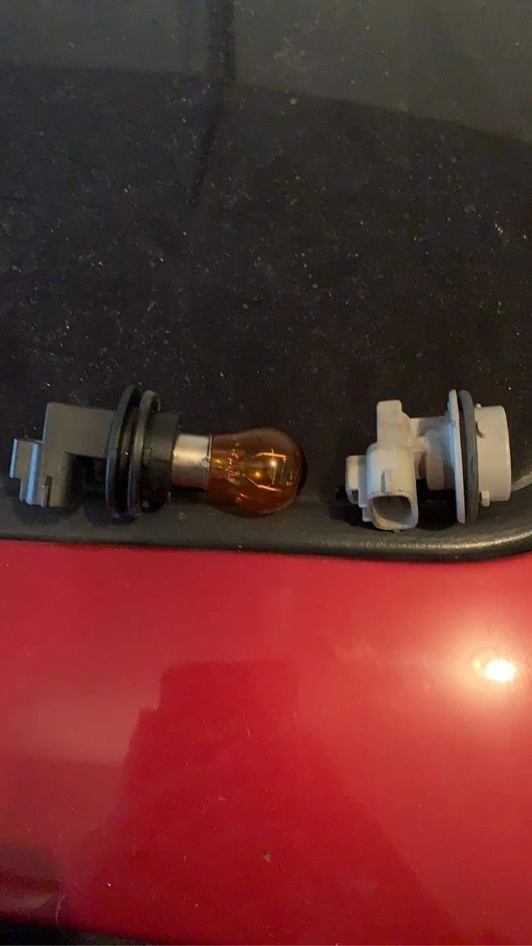

Hey guys so do to our cars getting up their with age eventually the turn signal sockets will burn out (this happened to me). And after much searching I couldn’t find anywhere that sells new for our cars. But I found a solution that the turn signal sockets from a 1999 ES300 are exactly the same and readily available. Hope this info helps!
1999 ES300 socket on the left SC socket on the right

If there is a number on the connector append it to 90980- and do a search. But thanks for the tip.

^^ What LeX2K said. Find the embossed 5-digit part number on that 1999 ES300 socket (if it is a grimy or dirty part wipe it off) and then put 90980- to the front of that number which you locate. That will give the Toyota/Lexus part number that can be ordered from any dealer (some part numbers are Lexus-only or Toyota-only though).

It is. I make frequent salvage yard visits sometimes I need a socket or connector I have to look through dozens of cars since there is no cross reference for this kind of thing that I know of.
