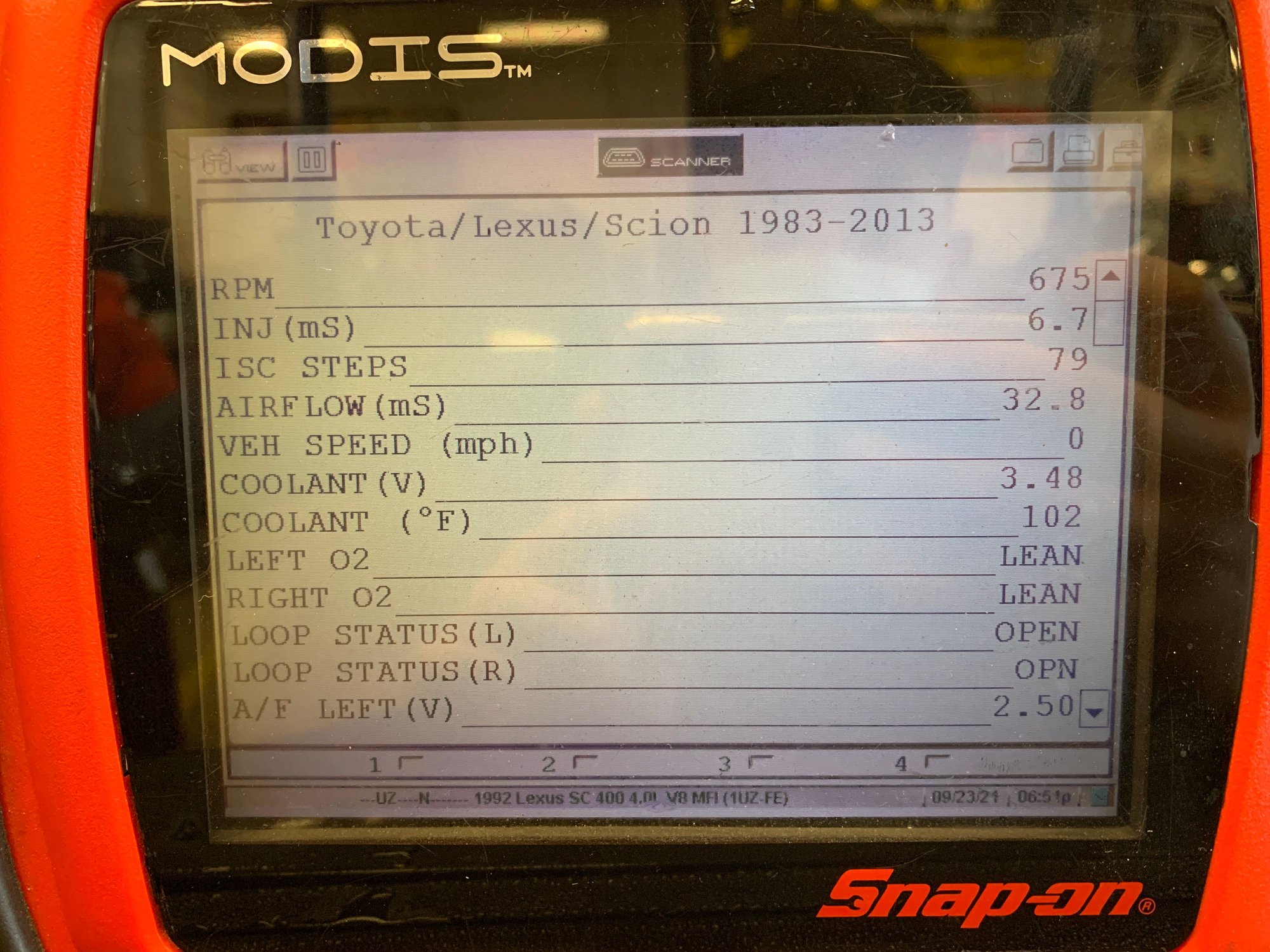

Default Scanner
We were able to read how it was running.
it’s running rich not lean! Does anyone know how it’s normally supposed to run/read?

Did you pull the codes? ECU may be self destructing itself. Bad ECU will make everything go crazy in some cases.
i got it running now, only thing is if I full throttle engine stalls, but yes I believe everything else like the radio and none of the gauges working is probably coming from the ecu.
