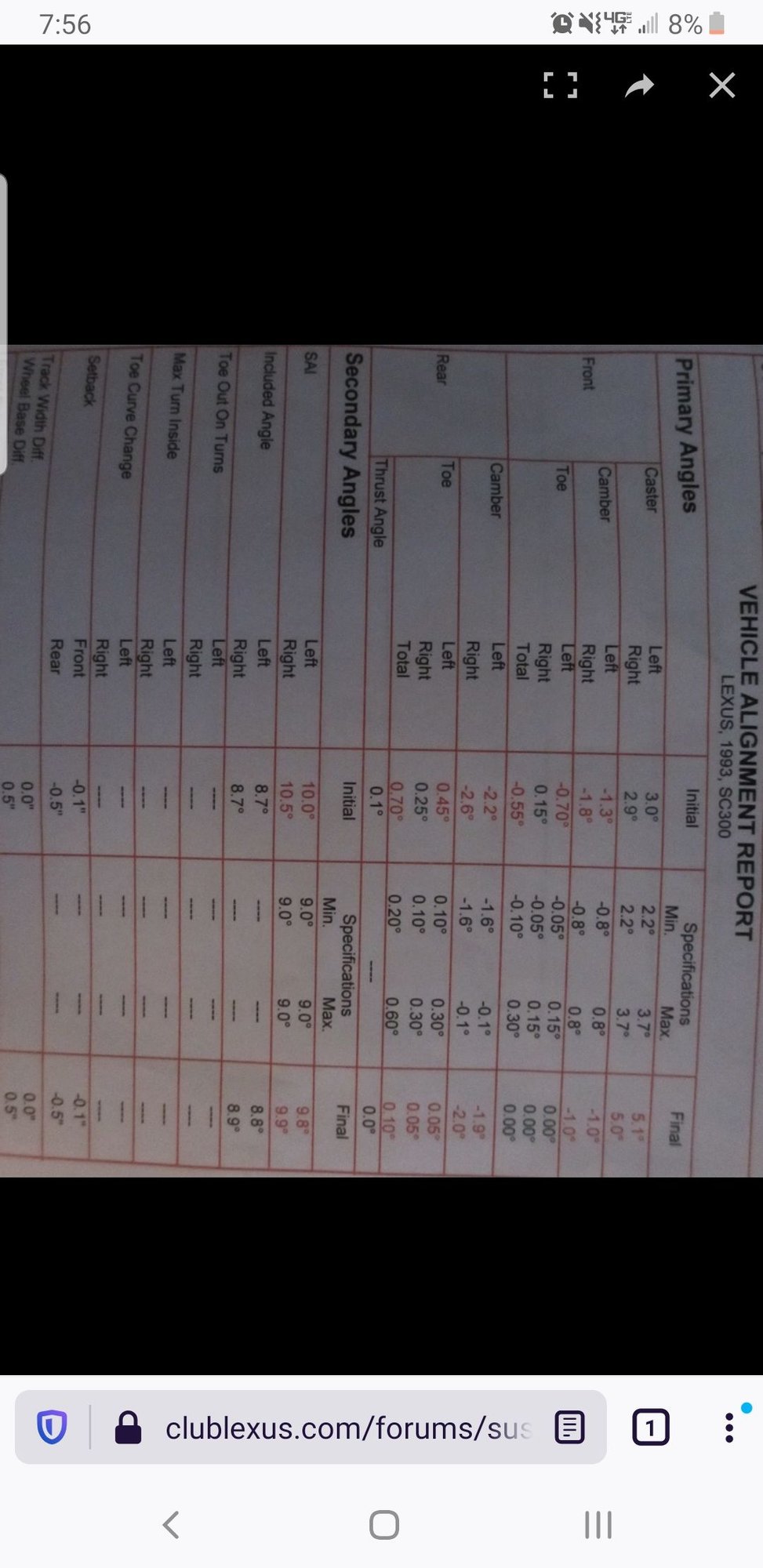

I am not well versed enough with alignment theory to answer your question but I think I can find the printout from one of my last alignment sessions during which the technician and I figured out a good compromise between what the SC's suspension can do and what the Lance Alignment specs call for.
A good alignment specialist who understands how each of these settings affect any vehicle's handling and tire wear should be able to do the same however.
The main reason I went with a the Lance settings as a starting guide was that with staggered Supra TT rims and the wide rear tires, an LSD, Supra TT rear sway bar and an aftermarket suspension I felt my SC was a little more tail happy than it should be with the stock SC alignment specs. The MKIV Turbo Lance settings are not all that different from an SC's normal alignment settings but there is something about them that I feel settled my car's handling and dialed it closer to where it should be.
If I can find my last modified Lance alignment setting printout I'll post it for you to compare.

On my car I am running OEM Supra TT rims in 17x8 front and 17x9.5 rear with 245/45-17 tires up front and 275/40-17 tires in the rear. I have MKIV Supra rear subframe mounts with an OEM 93-96 22mm MKIV TT rear sway bar and an OEM MKIV NA/TT front swaybar. My ride height with my Gixxer coil overs is close to stock... maybe 1.5" or just below 2" lower (the car does not look lowered) than stock so my SC's suspension geometry should still be pretty close to "normal".
