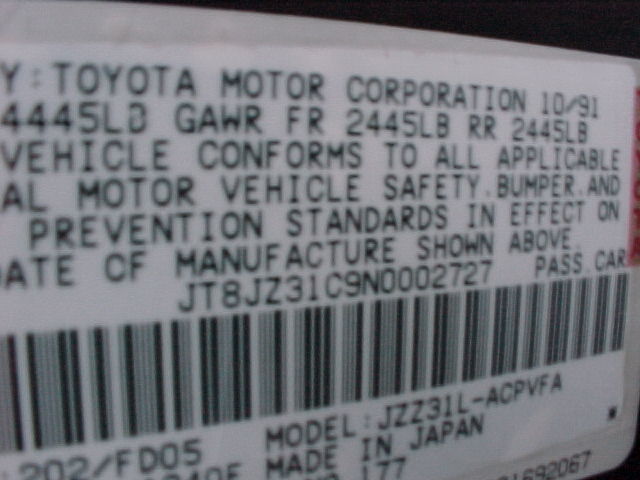

Had this sent to me,hope rob does'nt mind!
Here is a picture of the compliance plate on a Lexus SC300 USA spec. The car is currently for sale in Florida. Look closely. It was complianced as a JZZ31 Toyota Coupe, which is exactly what it is. The 3.0 liter Soarer with base trim spec level.
The ACPVFA after the model will say that it was built for the USA market. Find out what the differences for the local market are and you may find that it was exactly the same.
First time I've actually seen the compliance tag from a USA spec Lexus SC series. Bugger me if it doesn't say that it's a Toyota Soarer JZZ31. Check a few SC400's and I reckon that you will find that they are also marked as UZZ30 which was the base trim spec level SOarer.

I'll help ya out, BAZ...
This is what he's talkin' about:
You find it on the inside of the drivers side door.
Any Toyota/Lexus technicians out there that have any ideas??

Those are the model codes.. they help identify the car within the model.
UZZ32:
ACPZK
UZZ31:
ACPZK
UZZ30:
ACPVK
JZZ30:
ACMVZ, ACPVZ, ACMZZ, ACPZZ
JZZ31:
ACPVF
They tell the parts guy what block they were built in... each block has a revision of the parts, wiring looms etc. Like a minor version number.

I've got a Soarer and the model number is E-JZZ30-ACPZZ-L... if that's any help to you?

Hi just ran across this old post, your door card says the interior trim is FD05 was that light tan cloth buy any chance?...
